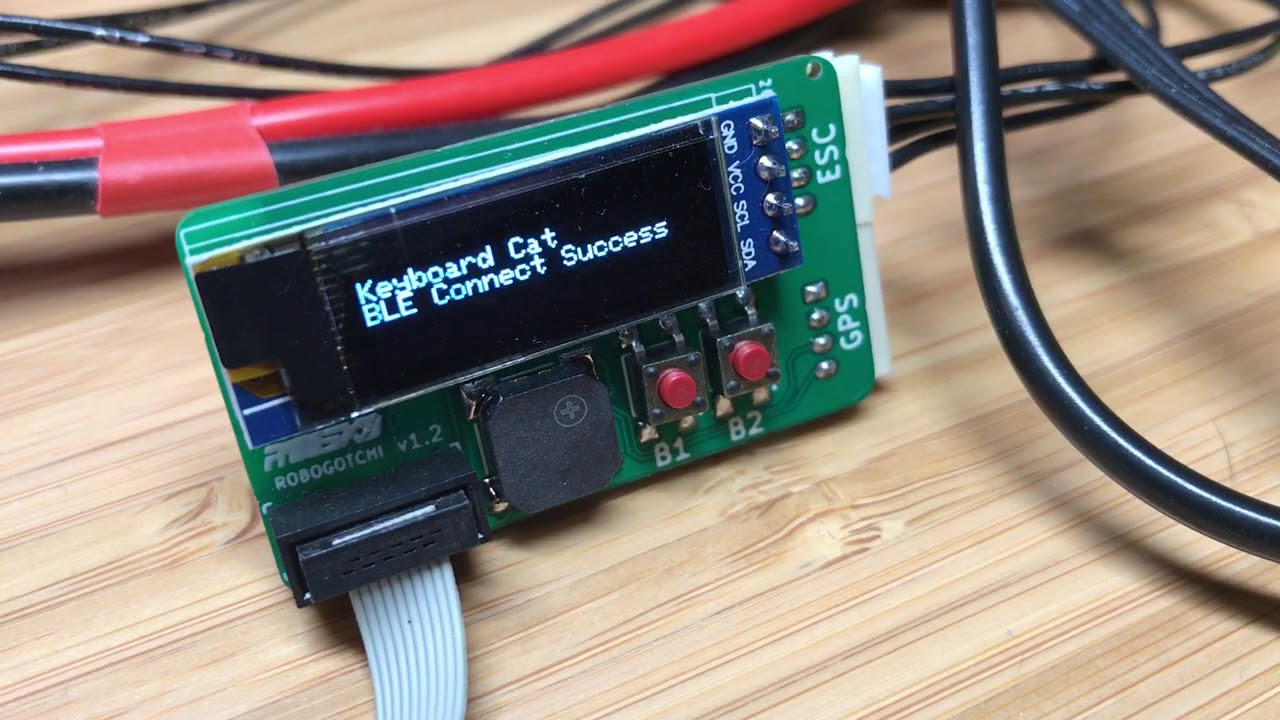

It coincides with firmware v0.7.0 for the Robogotchi (found on the firmware update wiki & robogotchi channels)
v0.7.0 Robogotchi Firmware Release Notes
* New logging file format
* Updated melodies
* Fix crash if nack is received outside sync
Important: Due to the change in logging file format, Beta testers will want to sync/transfer all logs they would like to retain from their Robogotchi prior to updating if they’d like to retain those logs.
Major improvement on the log sync/transfer times with this update- great work @skate420!

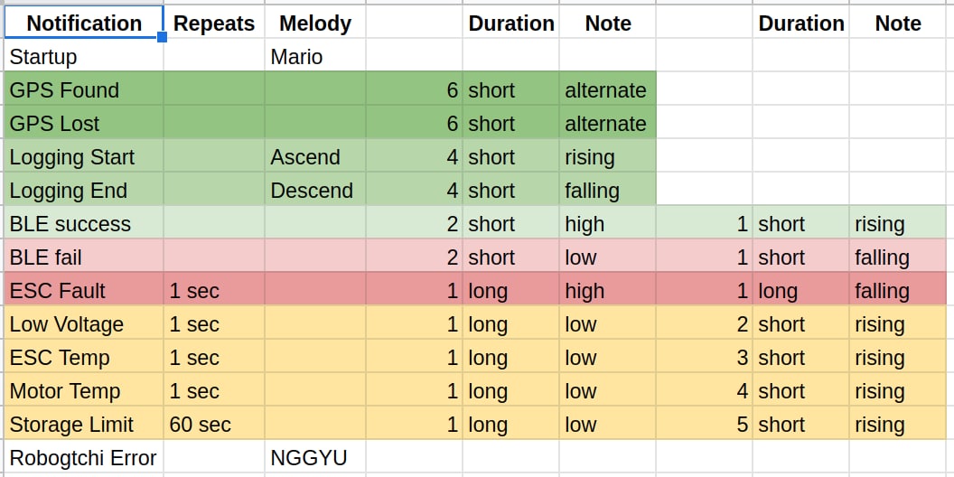

@DerelictRobot Robogotchi has low voltage alarm set as default yeah? Does the alarm repeat?

Don’t want to derail the Xenith thread, but we’ll have to update that video as the latest firmware update reworked a lot of the tones to make them shorter and easier to identify.
Was thinking the same. I could post it in “videos only” and people interested in seeing what it looked like at the start could go there?
It’s not set by default because of variety in battery voltage used, but it’s easily set in the Robogotchi config.
Yes, it repeats while the condition is active.
Current decoder-ring sheet.
@Flasher is the video youre talking about accurate to this?
It is the entire sequence of themes with what they were related to onscreen. (The one you shared with us a while back, I have it private inside my YouTube channel for safekeeping)
