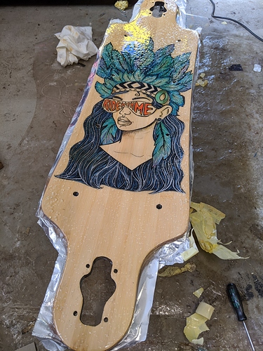

Didn’t like how frit can ruin the look of artwork. Thought it would be a shame to cover her pretty face in pimples. Masked it up with tape. Worked out well I think. Wasn’t sure if the fine frit was going to be grip enough. So used a coarser version for the edge. It doesn’t stand out as much I think.
