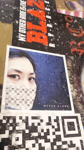

Took it for a spin today to some disappointment. Two of the stickers have a different material and the polyurethane resin did not stick to it. Just a short ride tore all the glass frit off those areas but the rest is sticking well.

Follow up to the fix of this;
The two stickers where polyurethane sloughed off were cleaned, lightly sanded more, and fixed with 5 minute epoxy and more frit. It’s not perfect but it will do.
