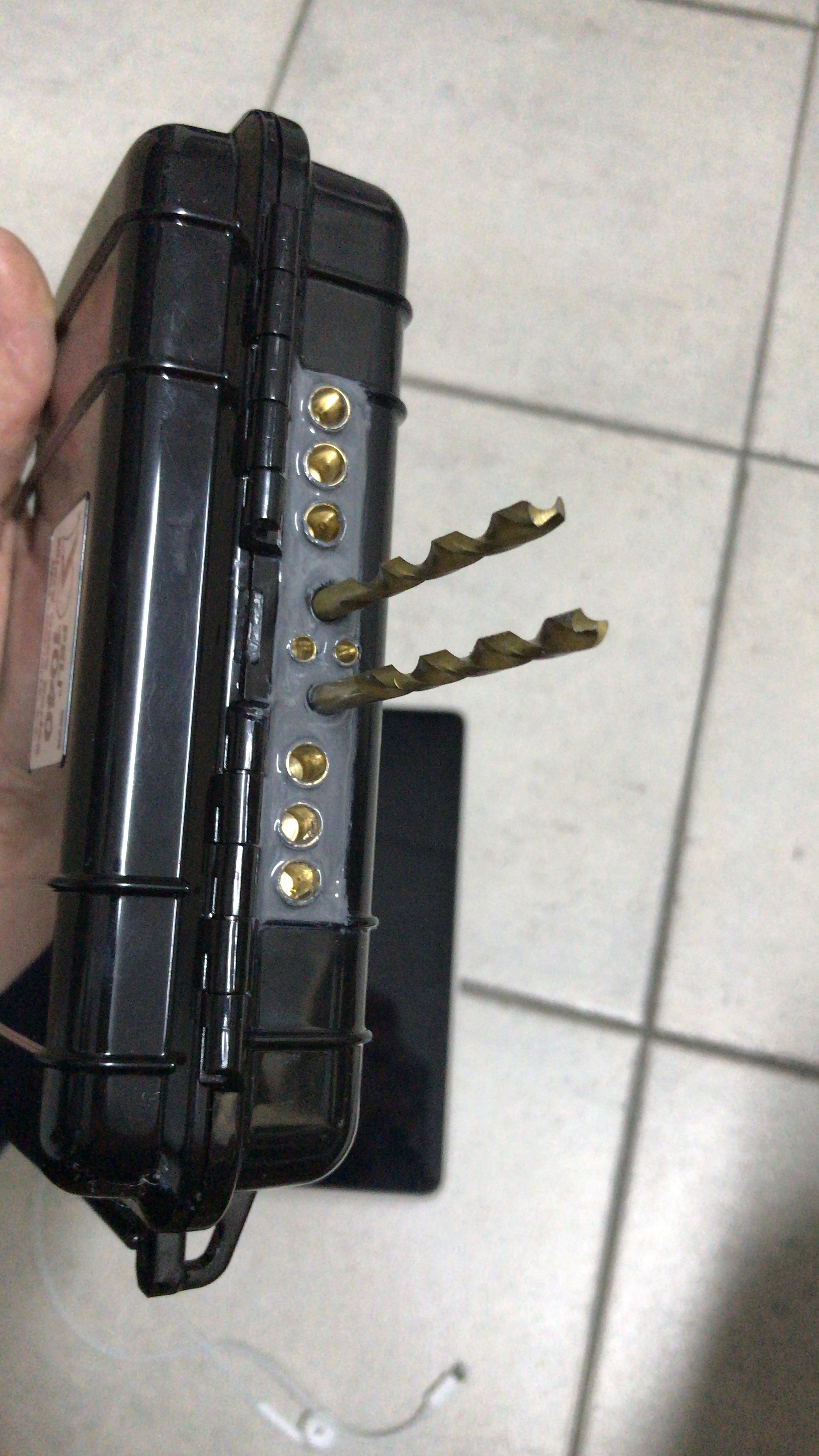

I am also to lazy to take the unity out off the case because all those bullets are properly waterproof
