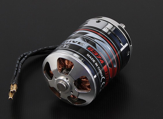

So on my dual 6374 SK3 setup and current 8S high discharge LiPo pack, if I wanted maximum performance the Unity settings would be:
Battery Amps: 160A (one setting)
Motor Amps: 80A (per motor)
Regen Amps: -50A (because RWD)
Your 6374 can handle 80A?
I think he calls them
Puff-The-Magic-Dragon
I know OEM spec sheets aren’t all that highly regarded around here, but Turnigy says they can do 80A, and the Max6 ESCs I used before could supply 160A each. They never got above luke warm with those ESCs, running BLDC instead of FOC though.
Ah yeah. Probably a little overrated but it has good cooling so that helps. 70A is probably safer but 80A once in awhile won’t do much I don’t think

For real, motor does are totally an idea rather than a fact. I’ve seen KV ratings as much as 10% off, never within 4KV of the stated value.
