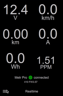

You can use Metr to update ERPM limit
You can also calibrate PPM in Metr app
You can also do motor detection & backup / restore configurations
Give it a try
i did and it fucked all my shit up. That’s what i was saying. After doing exactly this i ended up having to reload my firmware.
