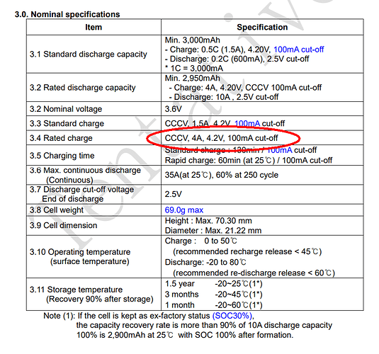

My battery is a 30T 12s4p, maximum cell charge is 4A, maximum continuous discharge is 35A, both currents per cell according to Samsung 30T datasheet.

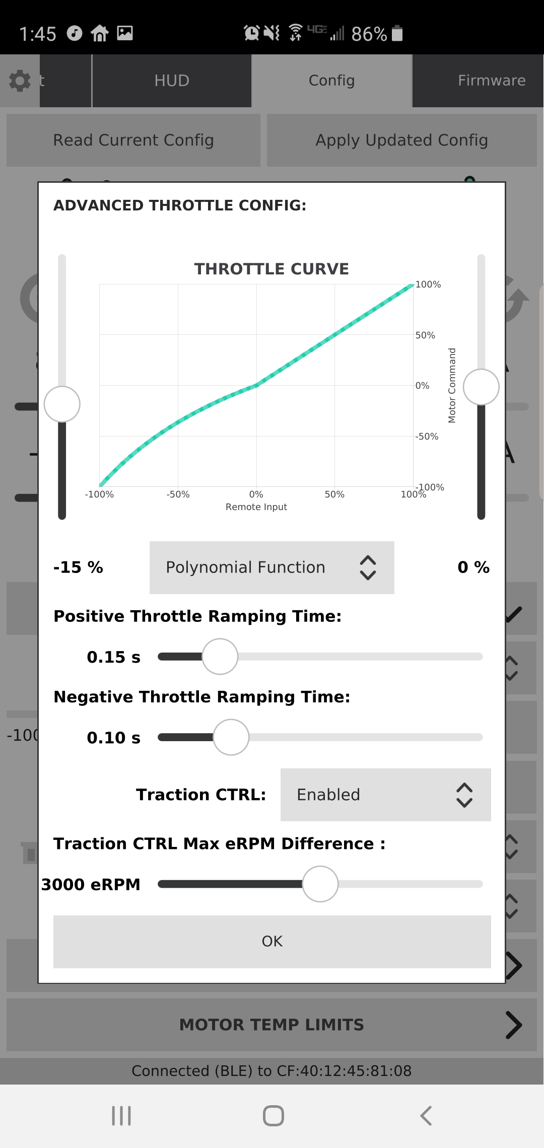

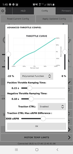

What’s your throttle curve look like?

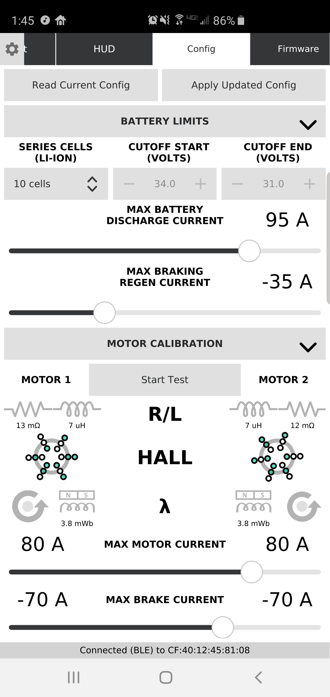

I’m using 30Qs in a 10s5p config for reference.
I think the cells will take >4a for bursts, especially if the pack is closer to empty. I’d say increase batt min to -20 or -24 and don’t do intense braking until pack is like 70% or less. Maybe.

Well even at full braking (throttle pulled to the max) the brakes are lame, so nothing throttle curve culd fix. On low speeds the brakes can be locked easily, making changes to the braking throttle curve migth affect both hi and low speeds, more low speed braking won’t be safe for me.

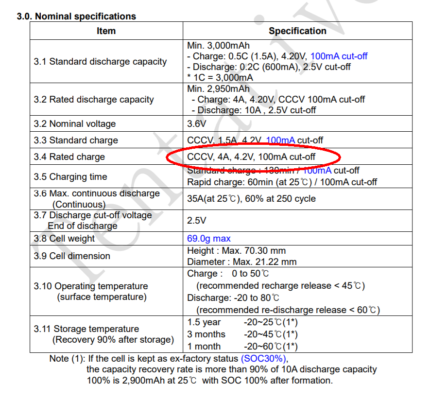

-16A of motor min on my 12S4P will give me 4A of bursts for each 30T, going further will give me even more amps with according to Samsung will be too much:
100% correct, however I wonder why such big ammount of current have this kind of llame brakes!
You can exceed the rated charge for very short periods of time lasting but a few seconds (long enough for your speed to drop from full-speed to just really fast)

To add a bit of color, trampa often recommends setting bat min very high. -25 to -35 in this case:
And I believe the lower the SOC, the larger charge current the cell can handle. The CC/CV charge algorithm is a generalized formula that is safe for all lithium ion chemistries, but it’s not optimal.
Ok guys I tried -24A of battery min and it’s braking pretty good now, I can ride faster and with way more confidence now, I’m pretty sure the battery won’t have issues in the future.
