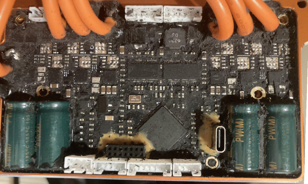

Here an almost perfectly alignend comparison i threw together.
tenka vs a unity that’s missing the connectors. *Pictures not from me
ezgif.com-gif-maker

It’s kinda funny that they did 12AWG on the unit with 12 fets, and shipped 14AWG on the unit with 24 fets for years :joy:

It would appear it’s also missing its canbus transceiver.
Also, if the discovery here is that it has half the number of MOSFETs populated; the current ratings listed on the Massive Stator product page are grossly over-spec. No wonder @PropulsionBoards went to the street at 70+ amps, these things are probably 50A controllers at best.
Where is it situated? Haven’t seen any “big” components missing apart from the fets.
Actually, I think I misspoke, the chip I glanced at does appear to be there but it’s still somewhat buried by the potting compound.
It’s likely on the other side of the PCB, directly adjacent to the canbus header. Can’t see from here if it’s populated; but those canbus transceivers are one of the chip-shortage effected components so I’d guess they didn’t populate it if the header isn’t accessible. Has anyone tested canbus on one of these?
speaking of compound.
Another thing that proves that it’s just a reworked unity (if it wasn’t bloody obvious enough already) is the glue around the BLE header and USB-C port. Why add glue when it’s getting potted anyways.
