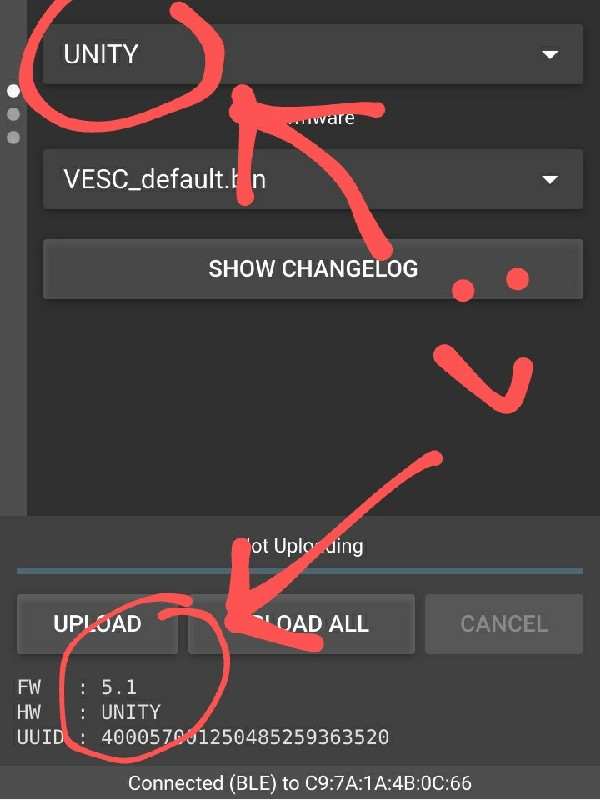

Why does mine say 5.1 in the VESC Tool? Mind you this is for Stormcore.
BECAUSE YOUR’E ON UNITY
But I’m not.
