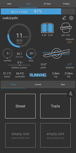

Soon , i will be able to test everything, with the free drive.
took some time cause i did diy the rails and everything on this board xD
