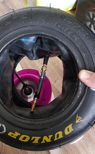

Printing the hub/rim for the wheels. Later I discovered that with this print orientation (or with my printer setting) that inside needed to be sanded down a bit. The hub is a really snug fit around the hoverboard wheels. With a 4 layer perimeter print setting it seems to hold the load of the Onewheel and passenger quite well.

Because the wheelhub encloses the hoverboard motors the diameter can not be smaller than 6”. This rules out using 5” Gokart tyres. A bit of a shame because 5” tires are only €30,- new. And the original Onewheel tires are often €80 or more. Luckily the owner of a Superkart team lives only 15 minutes away from me and he was kind enough to donate some Dunlop 11x5.5-6 tires that had only been used for a qualifying race :blush:.

Wheel assembly. The rim is not tubeless, so an oversized inner tube is placed. Because of the motors the valve has to exit on the side of the rim. A flexible valve extension is used for this. The extensions that I could source locally all had a bigger shell than the printed design accounted for. Some modifications where necessary to make this fit.
