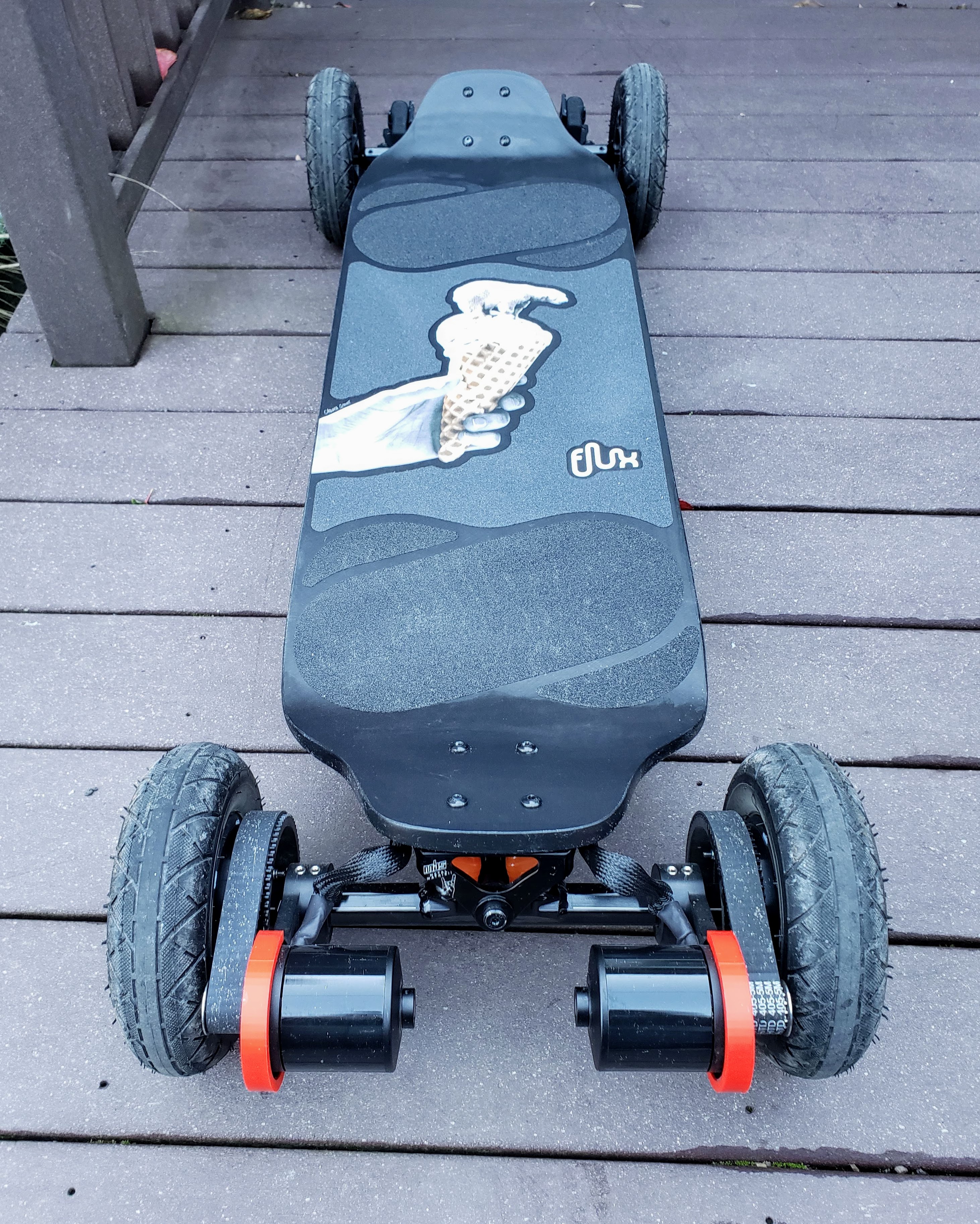

Love the new motor mount guards, fit like a glove. Big thanks to Frederic for the design & Skunk for the print job:
I would also like some axles haha
