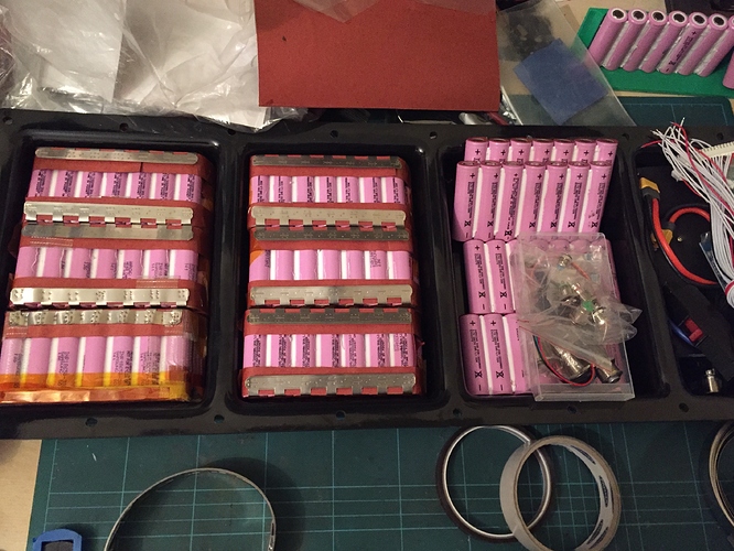

I am planning to build a Flux board as well, I can make a thread on its own but will try my luck here first.
I have the DIY deck&enclosure combo and i am planning on fitting a 12S9P p42 battery in there but I would like to retain the possibility of upgrading to 4WD in the future. As I will not want to desolder the whole battery when the time comes, i would like to build accordingly. I would like to go with dual storm cores and if possible/necessary heatsinks through the deck but don’t know the measurements plus I would like to get your opinions on the options:
My thoughts are:
In general two escs in the same chamber without heatsinks produce more heat, sure not double the amount of a single one because there is less stress on each, but it might still be a factor on long rides.
Through the deck heatsinks might noch even be necessary as shown by The Outlaw Star
A:
  • If I go with heatsinks, two big holes so close to each other might make the enclosure unstable
  • might not fit well for the storm cores
  • heat build-up
B:
  • might fit better
  • the usual fins on the heatsinks are oriented differently
  • heat build-up
C:
  • definitely fits, as A13XR3 has shown in his post
  • fin direction does not fit if i go with heatsinks, plus might look odd being asynchron
D:
  • would be my preferred option
  • downside would be one long battery wire (Long battery wires)
E:
  • Dunno, better weight distribution?
Oh yeah I am not planning on using a BMS … will balanchecharge every couple of months…
Any help is appreciated
Top mount them. Add more battery
My original plan with the C layout was weight distribution and phase wire length. But with the new information I’ve read about inductive spikes coming from long battery wires has made me reconsider to something more like option A/B. I’m not going to cut into the enclosure to have a heatsink stick out I’m likely going to design my own tray, something like what Fredric has in the latest completes, but only to add thermal mass and ensure there’s air on all sides of the esc’s. Also holding the BMS securely above the esc’s was an initial concern so this will take care of that. If temps are to high I will work out a way to do a double heatsink through the board. I’m not concerned about fin orientation. Turbulent airflow across the fins is beneficial.
Also the reason I didn’t mention D was because it actually seems harder to work with when laid out there is less room for the phase wires and battery wire having to turn them directly up against the enclosure wall. And also having the esc edge super close to the battery.
+1 I wish I did this.
You still can. BUT now you gotta add +1 to series rather than parallel.
can always top mount an additional battery lol

It think the quintessece of the long battery wire thread was that you could counter the inductive spikes by running the plus and minus cables close together or even twisted/braided… Might be worth it for the aesthetics
It’s not 100% needed I have a small 10s5p Samsung 25R mobile charger that I can hook up while riding, if I need an extra 6 to 8.
one of the dudes I ride with a lot rides a 12s10p Samsung 50e lonestar and he always had a good 10 to 20% more than me after we ride. So I get anxiety from that lol.
:smiley: how much more battery could you want?! The enclosure already is massive!

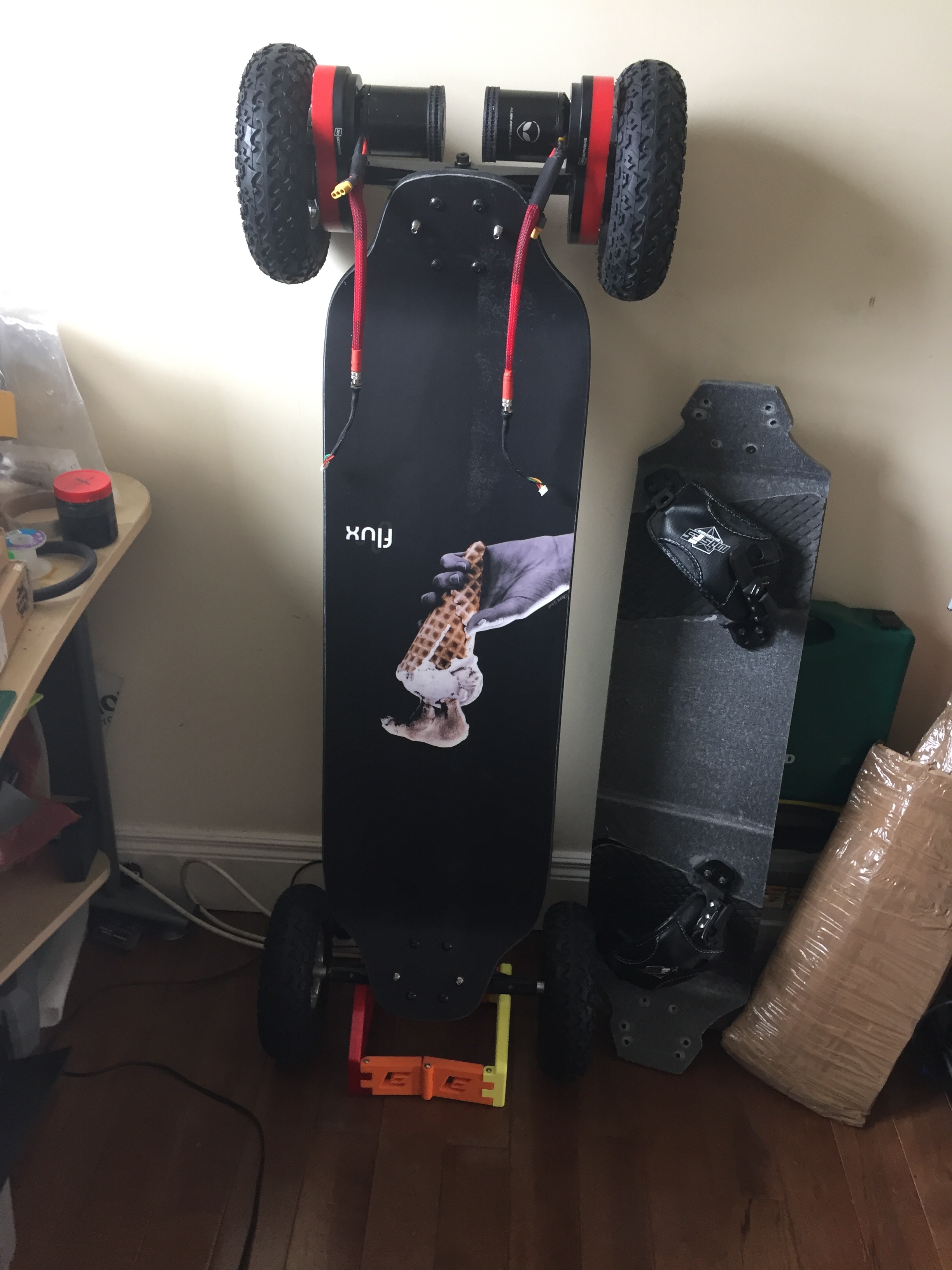

After a weird year I have kind of dug in again even tho time is definitely not my friend
18s7p on the go
Honestly dude I think you are fine with this - I haven’t had any heat issues since going dual unity 4wd. I didn’t have any heat issues when I ran dual TB V6 either. I only had heat probs when I ran dual focbox no heatsink. if you are worried about heat and are going to 4wd a single piece of aluminum under the stormcores should do you just fine. I haven’t seen the need for active cooling on my build at all.
I’ve done 30 miles of hard riding straight on this setup for reference.
Thanks for the info. 18s7p is a TON of go juice
Hopefully enough for the 230mm tires, I should probably buy lower kv motors!
Hah I’m sure it’ll be more than enough power. Which motors are you using?
APS 6384s 190kv, inappropriate for 18s, hankering for 63100 130kv now on HFI
