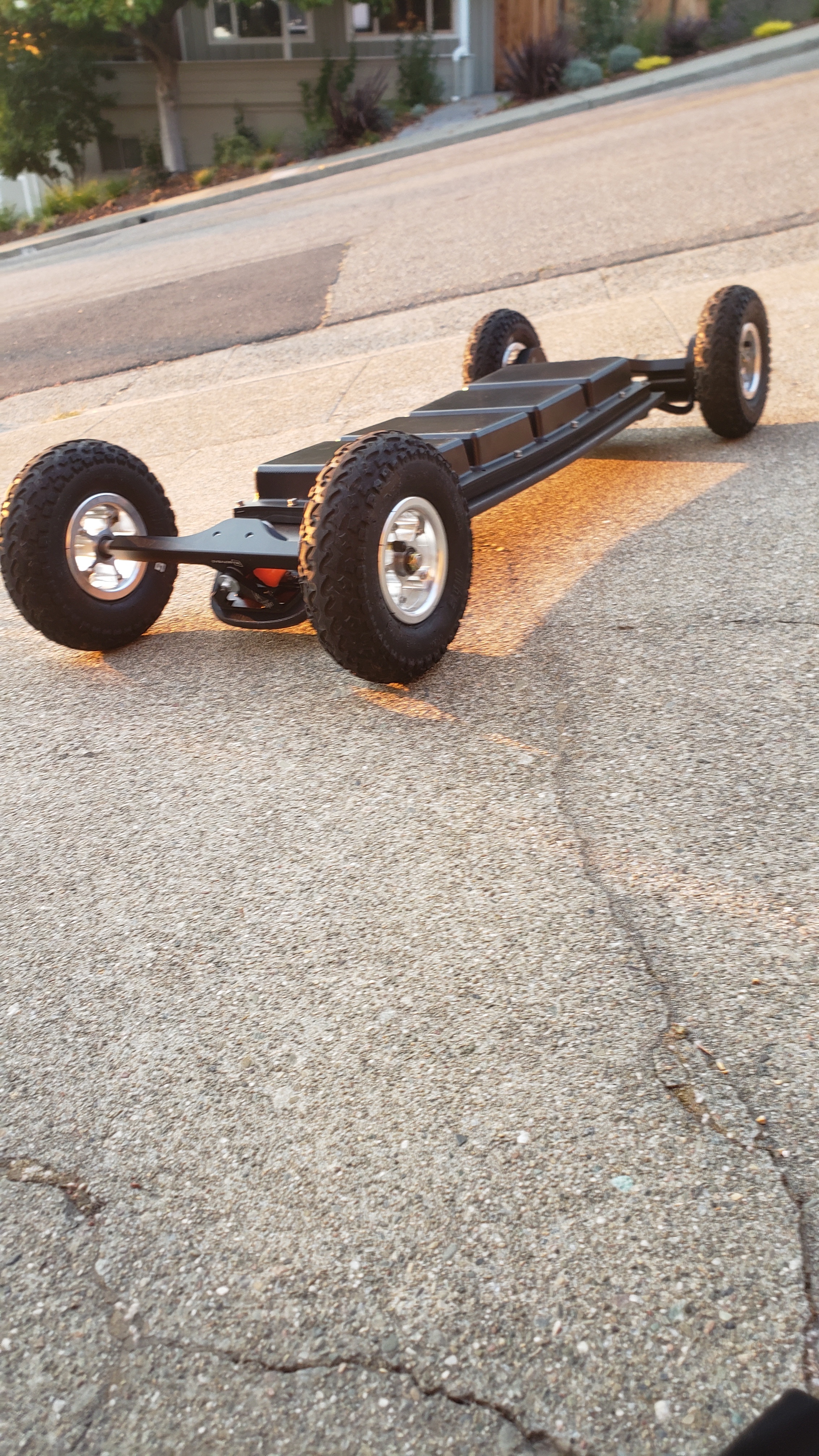

Are these decks symmetrical? The graphic on your is flipped :crazy_face:
Leave him alone :rofl::metal:t3:
yes but i personally would want the graphic the other way as your post inquires… or maybe its a front drive?? hahah

Looooooool! I think the deck is asymmetrical! Lol! I didnt even notice :rofl::rofl::rofl::rofl: stayed up till 3am working on it, I had to open the enclosure after everything was done because I forgot to solder the charge port :rofl: one of those night

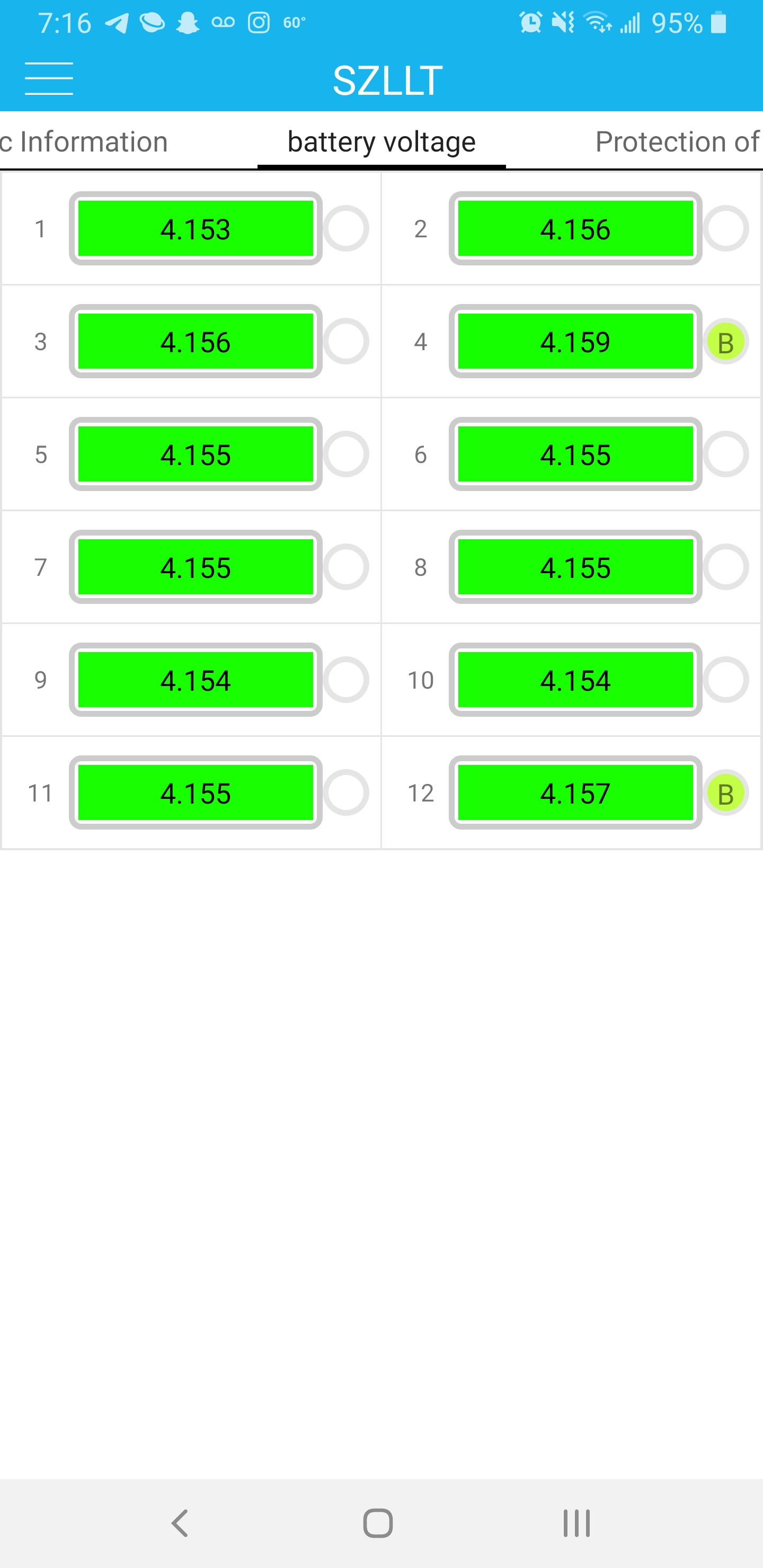

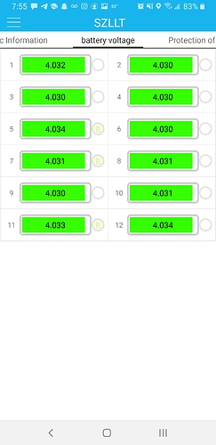

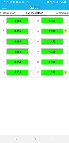

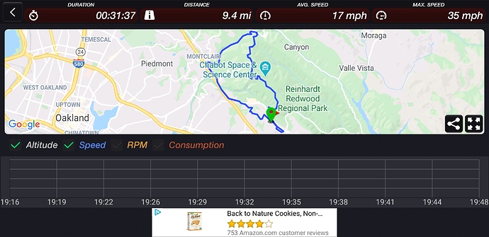

About ten miles, I dont have a metr at the moment so no real logging but here is start or ride battery voltage from smart bms and end of ride
I recon I can get alot of range here, no noticable voltage drop, however deffiently hitting thermal on there 9" tires. So will probbaly replace them with 8" running TB6 from newest batch!

If you reverse the way the trucks are mounted, would that actually work?
“Ultraboard” :joy:
I dont think that would work lol :rofl:

He prefers bear to ice cream, hey maybe he rides on his hands and looks at it upside down
Yeah leave him alone his trucks are pointing the wrong way even if he does push mongo
