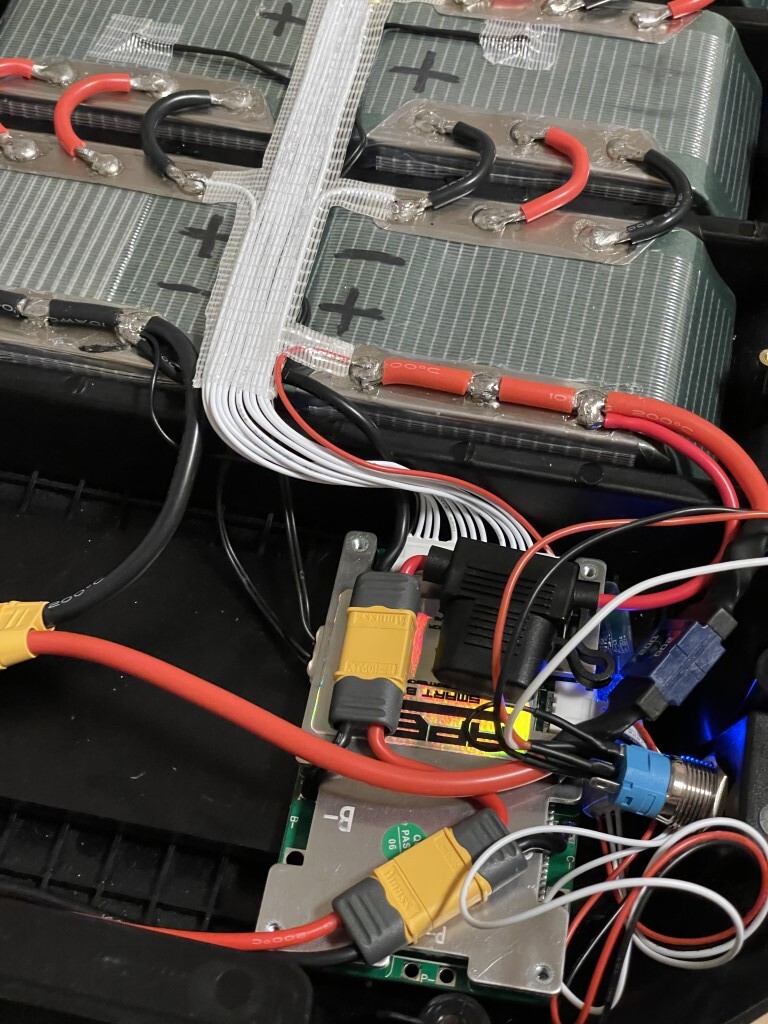

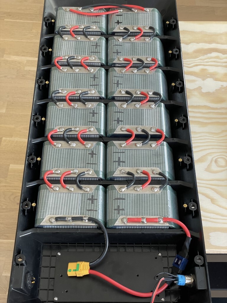

I designed and 3d printed custom guides for cell holding & nickel shapes.
Cells & 10P Packs
Nickel Prep
10P Packs
Full Battery with BMS

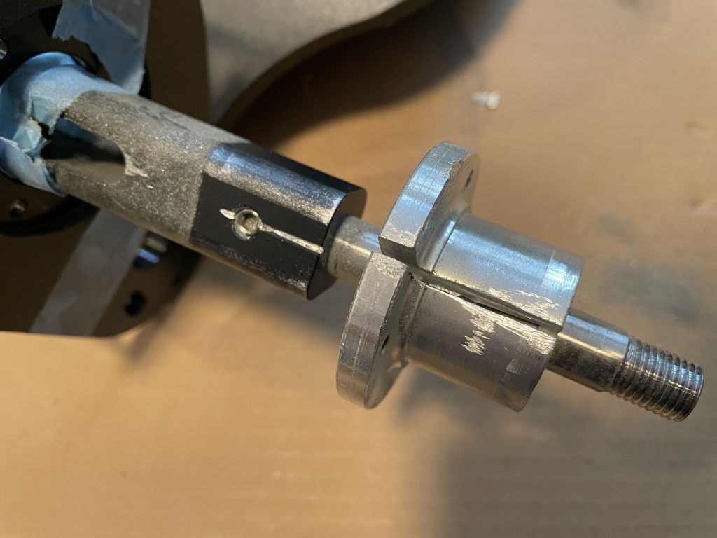

Gear Drive
Bad Adapter from BN for Apex Airs…
just heat it up, it will fit
With new adapters it did fit…

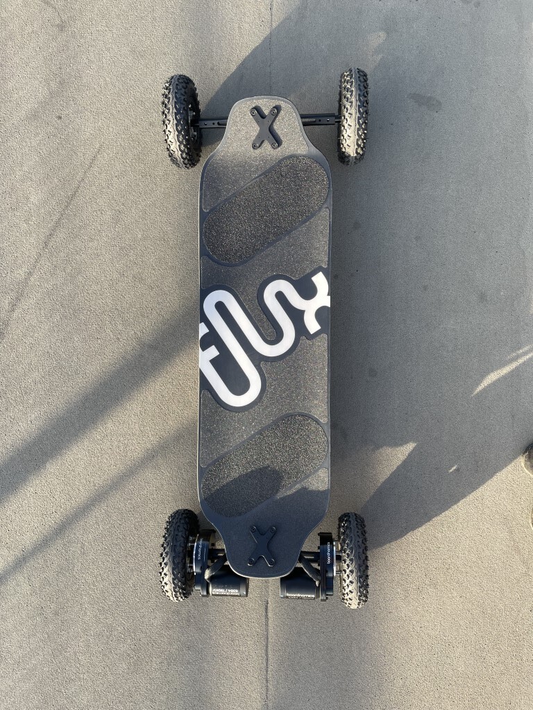

Fine Tuning
v1 is ready
More BN troubles…
New Tires
v2 is ready
Winter Cleaning
NewBee Drives… to be seen

Why only 12s if you got a uBox?
Evwan
January 1, 2022, 7:06pm
#3
Yeah 16s6p 21700 is fairly straightforward I believe
I would think 14s7p would be a bit easier, 5x small compartments and 1x double compartment makes it naturally fit 7n groups right?
Or 14s9p 18650
Evwan
January 1, 2022, 7:11pm
#5
ZachTetra:
14s9p 18650
Yucky
I know 18s6p/12s9p 21700 fit. 16s+ may be hard because of the size of the BMS. Maybe even 15s as it uses the same small LLT/Daly.
I think at 18s you’d toast the ESC, but there’s the 100v beta and StormCores
Evwan
January 1, 2022, 7:15pm
#7
Yeah, I meant that in a general sense, but 18s is possible on the regular ubox as Ernesto’s been running it no problem (no promises)
Due to the enclosure size/compartments I really haven‘t considered anything other than 12S.
10P would allow for high capacity cells…
I recommend using the horn and brake light ports built in the ubox v2 if you go with this ESC
Recommended break lights?

You can use any 12v light. This is the one I use. 2PCS Trailer Brake Light 15 LED Rear Light Trailer Truck LED Tail Light 10 30V Trailer Stop Signal Lights Tail Brake Light Bar| | - AliExpress you just need a way to mount whichever light you pick to the board. I designed and 3dprinted a mount for it to attach to my 3d printed box
It turns on only when you are braking with your esk8 remote wheel it can’t be turned on/off with the secondary buttons. You could solder some bullet connectors in between the UBOX port and the brake light to unplug it?

Ok so the port is always on? I haven’t had a chance to really look at it yet.
The port is always on but the light is only on when braking. For the horn, it is only on when you momentarily press the accessory button 1 on the uni1.

Finally updated my build with the build progress and current state.
