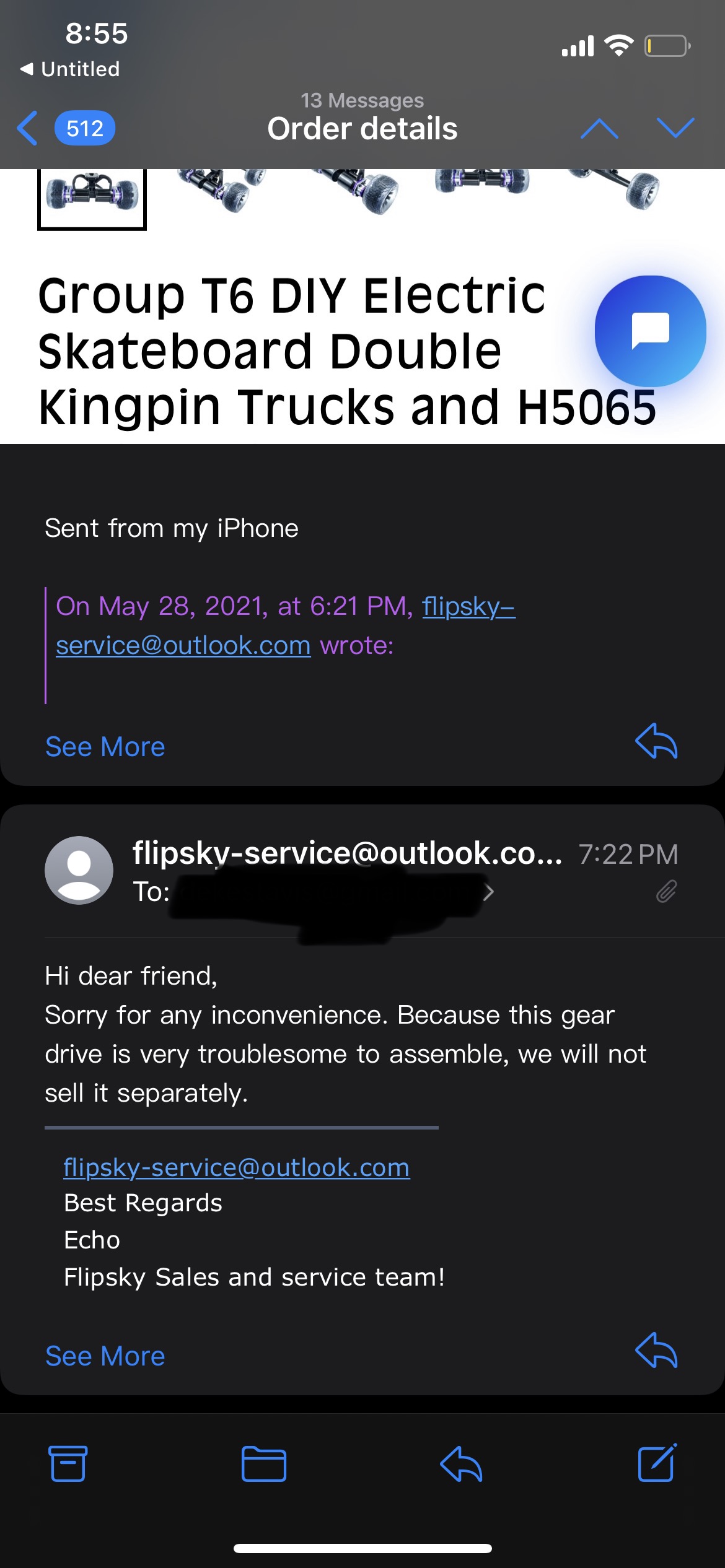

I asked if they will sell the gear drive kit separately and apparently they are planning to sell only the kit:
Exactly what I told Flipsky. Hope they heed my advice.
troublesome to assemble,no its really not thats just them wanting to get the most from ppl buying the drivetrain as a whole which it isnt to bad but:
A. not everyone likes cloud wheels so having the drivetrai nonly supporting those wheels wont yeld many customers by comparison to boardnamics gear drive and all the options u have as well as cheaper price.
B. the truck hangers are so generic and unimpressive so the ride feel will be a bland,stiff and boring as riding majority of prebuilts out on the market.
C. Using plastic wheel teeth on metal will have those pullies teeth get shredded incredibly fast so they definitely should have made it both stainless steel pullies for motor and wheel and not just wheel.
D. hobbywing like 5065 motors are weak they couldve placed their much better 6354 2000w motors on instead since most high end boards especially typically run their motors on 2000w per motor which is more then enough power for ur average rider. Dual 1200w with 160kv just seems a bit to lackluster imo.
Flips gear drives arent to bad but definitely needs way more improvements for ppl to even consider riding these especially long term and with out crazy good boardnamics gear drives are, the amount of truck and wheel type support and the price my god the price, flips drive is gonna be a really tough sell for the semi informed Esk8ers and ppl who dont really do due diligence will most likely end up ordering this drivetrain.
