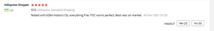

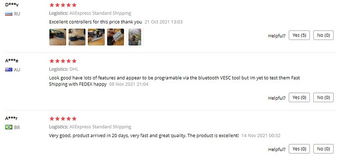

Thanks for your guys’ interest on this product, here are some feedback from the customers after purchased this vesc. Hope this helps.
:grimacing: :grimacing: :grimacing:
Best VESC money can buy?
IT’S NOT A VESC!

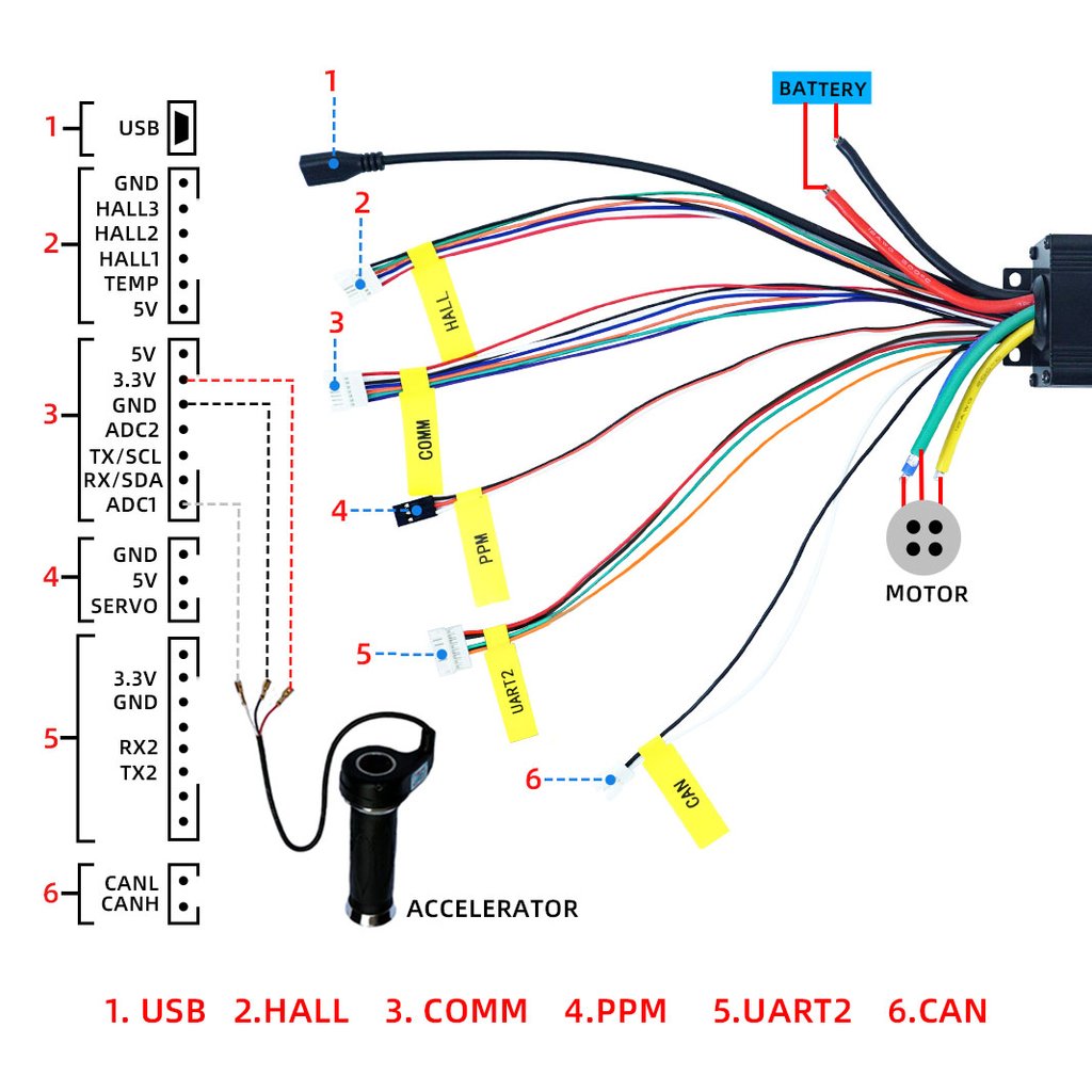

Thanks for your reminding, the diagram is updated now.7_2179ea3d-2b8a-48de-8e04-261caff70566_1024x1024
so may we know what should be named for it?
