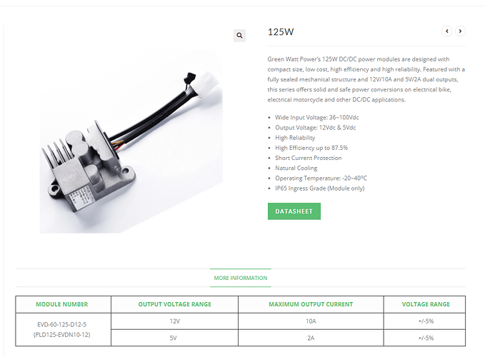

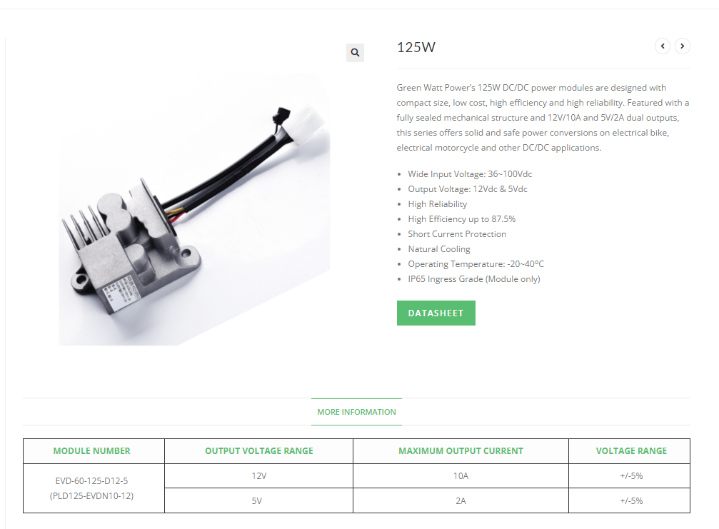

i’ve had difficulty finding quality step downs for 42-130v automotive grade
this is what i currently use @Battery_Mooch if u can make it 99% efficient ill buy 10
Of course. But you will find a much larger number of decent 36V or 48V supplies than the higher voltage ones you need for most esk8 packs.
A 100V to 5V buck converter?
That can’t be done at 99% efficiency. Maybe not even 90%.
And only ten pieces? For months of work and testing? Umm…no. I’ll pass on that offer.
