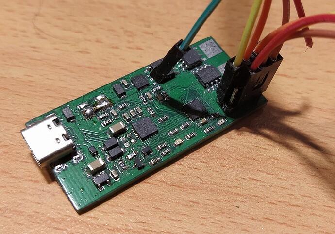

I haven’t actively developed anything further on this, but I have tinkered enough with my own PD negotiator board that I got the FW implemented to the point where I can communicate with a PD source device, enumerate the power profiles, choose one of them and request it. In my development I have tested with a Lenovo 60W PD charger that I bought with my own money and I tested a HP PD 60w charger at the office also and it also works (enumerated, reads power profiles and is able to choose one).
The main IC is a STM32G0-series MCU with the hardware peripheral for the USB PD comms, although you need a logical layer in the firmware to actually do anything with it. There’s also a lot of other things that I wanted to test with this board initially and that’s why there is a lot of stuff on it. It’s also a bit dusty as it’s been sitting on my work table for some time.
Basically you’d just implement a boost/buck-boost SMPS after the USB-C connector behind a protective FET (or other switch between the USB-C connector and the input of the converter), so you can then convert the supplied voltage from the USB for the wanted load and make sure you have enough feedback to monitor that the input power from the USB side stays within the negotiated limit. I would be able to implement this with my current knowledge and the new max 240W support with the PD 3.1 would make it actually pretty good power wise.
