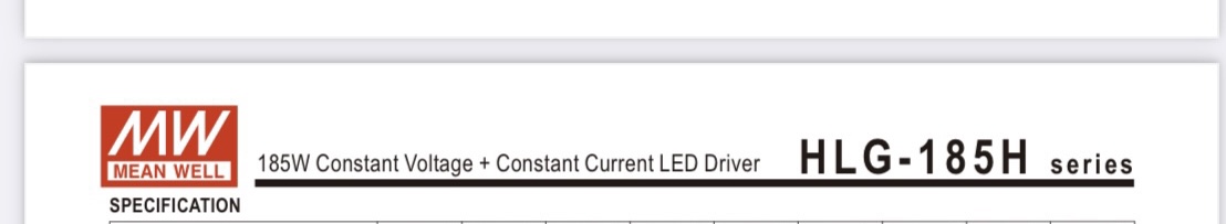

got a wattmeter in between now to check. also bought the meanwell charger now but that doesnt charge at all, only shows the correct voltage. very strange…

regarding the charger charging stages, isn’t that rather the BMS regulating that? since the HLG-320H-48A is a LED power supply @hummie recommended it would not have such functionality?

Yes it dose it’s a CC CV
What it dose not do is terminate the charge but the flexi bms can do that.

cheers! I also got the new charger to work. I had to raise the allowed amperage which was on 6500 by default.
HLG320-48 can output 6.7A so yes up the charge current ( parameter $1) a little or turn down the Current a little on the PSU.
