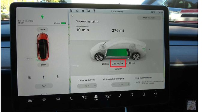

I would like to request a feature
  • report estimated time until full charge :pray:
And while on that, charge rate for a configurable consumption in km/h or km/min
And that being displayed on Metr off

A simple version should be easy to implement, but an accurate one is a surprisingly hard thing to implement, as you would need to characterize the pack. I suppose a generalized discharge/charge curve can be used and that can be good enough to give the estimation based on configured pack capacity and charging current measured.
I suppose this time-remaining-to-full value would live on the BMS that connected devices can request?
I have discussed about this with an ex-Nokia cellphone hardware engineer (my current team leader) and all the problems and challenges that there were. In their case it was the accurate battery remaining percentage display. They used available fuel-gauge ICs from major suppliers, but there were still discrepancies between the indicated and actual battery capacities.
You mean like tesla shows when it’s being charged how much range is being charged back to it in an hour?

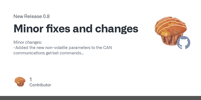

Did you forget to update commands.c
case COMM_SET_BMS_CONF:
case COMM_GET_VALUES:
with new nonVol parameters? :slight_smile:
The guys from Grin have a pretty neat charge simulator with a bunch of batteries characterized, you could take the most popular cells with a few data points at different charge currents and interpolate the rest
Exactly, useful for quick breaks when you just need enough to get home
Just so @rpasichnyk makes this number available on Metr somehow so we can see how fast it’s charging

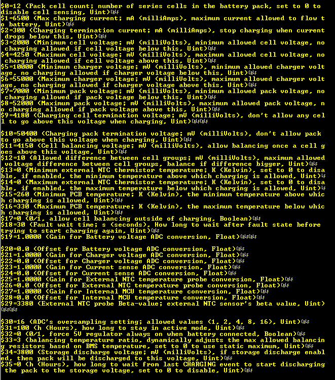

Hi! I received my FlexiBMS for testing, thank you! It is HW 0.5-1 version. I will be using this with 12S4P Molicel P42A pack, Unity and Metr Pro.
It had FW version 0.4, and I successfully updated it to 0.8. It took about 10 retries but eventually succeeded.
I noticed that out of the box, the FlexiBMS did not have cal values applied. No biggie. I was going to upgrade the FW anyway. So resetted the config values to defaults after flashing, and started applying the calibration values. I was able to set the gains, but it seems that there is an interesting bug when reading in the values. I sent:
$19=1.0081
$21=1.0181
$23=1.0139
Which returned:
$19=1.0080 (Gain for Battery voltage ADC conversion, Float)
$21=1.0181 (Gain for Charger voltage ADC conversion, Float)
$23=1.0139 (Gain for Current sense ADC conversion, Float)
Looks like $19 is reading in with a small error in the last decimal. That’s probably very insignificant but I suppose it would be good to fix it. If I send in 1.0082, then FlexiBMS returns the correct gain of 1.0081.

This is most likely a rounding effect in the value reporting function for floating point values, as it only reports to 4 decimals and there is a conversion from float to integer that happens, so I’m suspecting that it rounds the last decimal down in some cases.
AKA, the 1.0081 value is actually something like 1.00809xxxxxx once it gets converted to real float value and then the last decimal gets round down when it’s turned back to integer from float, but the value in the memory should be an accurate one.

So looks like 12S pack with all cells within couple millivolts from each other. Pack voltage looks pretty close to the sum of the cell voltages, so I assume you have entered the calibration gains for it. Charger not connected and temperatures measured by the LTC6803 and MCU around 27-30 Celsius, which is pretty nominal for having the USB connected.
Status LED colors explained. If more colors added or their indication meanings changed they’ll be explained here.
State printout breakdown.
Calibration values explained.
Great, thank you very much! Yeah, “BMS first steps” sounds good to me. I left CAN gnd unconnected, let’s see if Metr Pro finds the FlexiBMS… Support for 0.8 FW is apparently coming very soon (in review).
And yeah, this is a new 12S4P P42A pack with relatively well balanced cells out of the box. Calibration values have been applied. I did notice something like 0.1V delta between what FlexiBMS reports as total pack voltage and what my UNI-T UT61E says. I don’t trust the UNI-T enough to blame the FlexiBMS calibration. I suppose its good enough. Might check it against a higher end Fluke at work some day. What are you using as calibration reference?
The pack voltage is not super accurate, considering it has a resolution of ~19.6 mV LSB, and there is usually couple LSB of noise in either direction, so even with perfect calibration it’s still accuracy wise somewhere between ±40mV.
I personally just use a non-reference accuracy benchtop power supply set to 50V and calibrate the gain on that, if you have a good reference voltage source then you can use that to do your own calibrations.
But if you’re using cell sensing (packCellCount != 0), then the pack voltage is not actually used for anything, it’s just indicated what it’s measuring. The cell voltages measured by the LTC6803 have much tighter accuracy and therefore it’s measurements if cell sensing is enabled.
