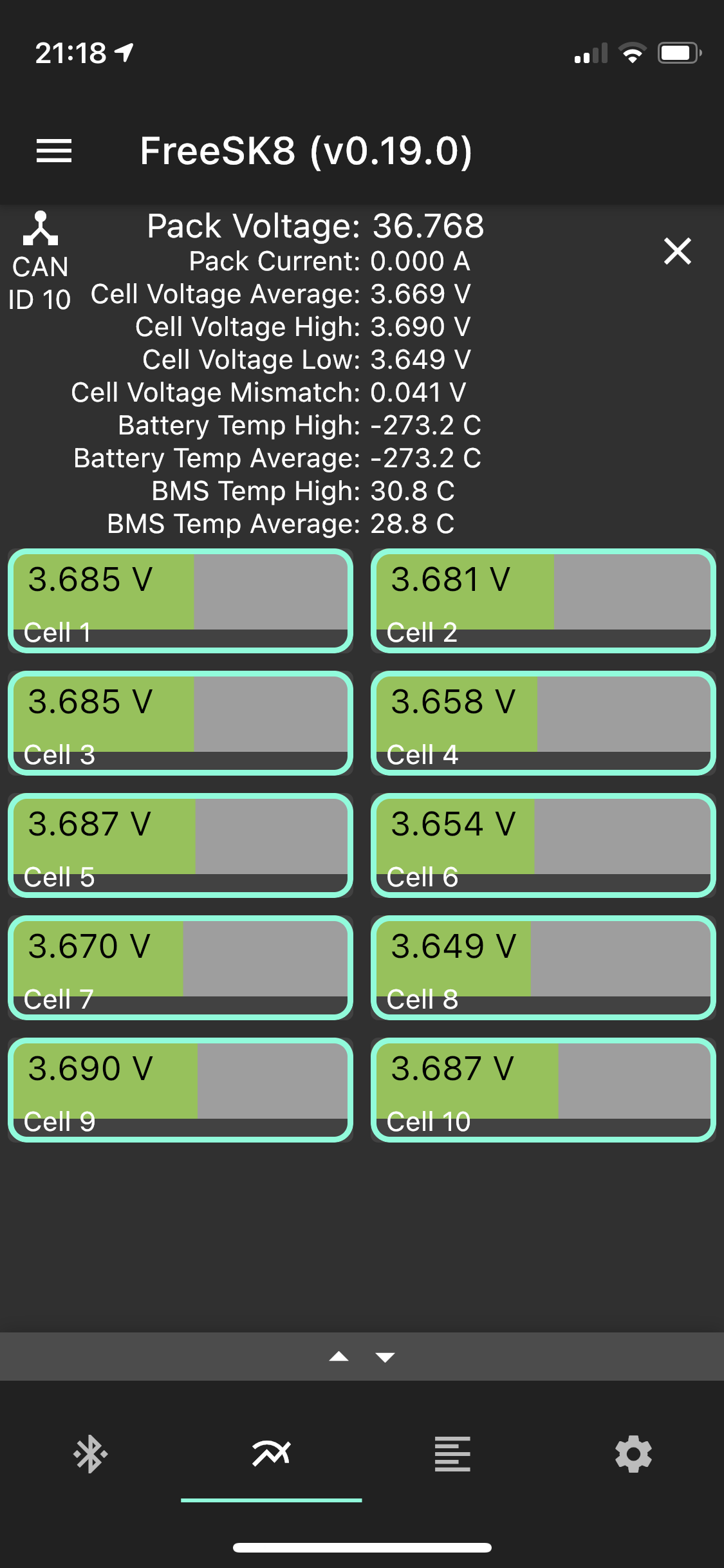

Hey guys, I’ve been messing all day trying to get the Flexi to apear on FreeSK8 app
Updated from the FW 0.6 to 0.18 and nothing so far, even with charger or USB connected. Will open my ESC enclosure to recheck the wiring
Here is how I have it setup, and don’t if it matters, my board is from the first beta (0.4 HW)
I get no led blinks with nothing connected, and the usual blue, green and yellow (USB / charging / balancing)

FreeSK8 is looking for ID 10
Oh hell, this might explain all the issues
I’m almost sure that one of my VESCs is also on 10
Will test this, thanks a lot
I own you a bottle of your favorite beverage or plate of food, thanks immensely
For those that might encounter themselves in the same boat, just changing the CAN ID won’t do it, you have to restart the BMS after doing it, either unplug all leads from it and plug again, or just send $K on the terminal, the last is what I did since I have all connections soldered

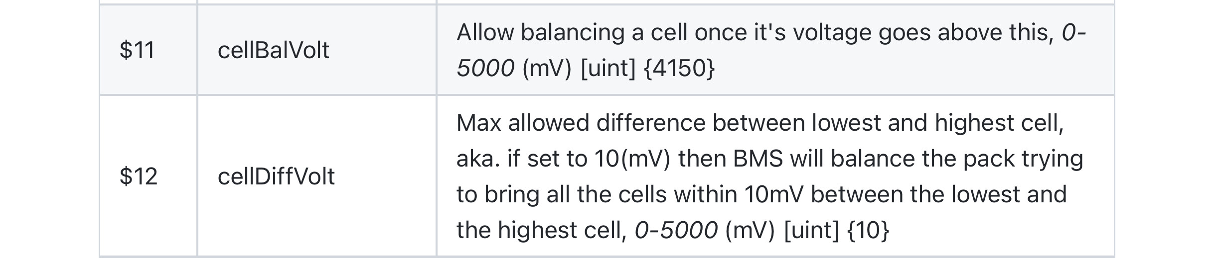

Post your flexi settings: $$

$0=12 (Pack cell count; number of series cells in the battery pack, set to 0 to disable cell sensing, Uint)<\r><\n>
$1=10000 (Max charging current; mA (milliAmps), maximum current allowed to flow to battery, Uint)<\r><\n>
$2=300 (Charging termination current; mA (milliAmps), stop charging when current drops below this, Uint)<\r><\n>
$3=2000 (Minimum cell voltage; mV (milliVolts), minimum allowed cell voltage, no charging allowed if cell voltage below this, Uint)<\r><\n>
$4=4250 (Maximum cell voltage; mV (milliVolts), maximum allowed cell voltage, no charging allowed if cell voltage above this, Uint)<\r><\n>
$5=10000 (Minimum charger voltage; mV (milliVolts), minimum allowed charger voltage, no charging allowed if charger voltage below this, Uint)<\r><\n>
$6=55000 (Maximum charger voltage; mV (milliVolts), maximum allowed charger voltage, no charging allowed if charger voltage above this, Uint)<\r><\n>
$7=7000 (Minimum pack voltage; mV (milliVolts), minimum allowed pack voltage, no charging allowed if pack voltage below this, Uint)<\r><\n>
$8=52000 (Maximum pack voltage; mV (milliVolts), maximum allowed pack voltage, no charging allowed if pack voltage above this, Uint)<\r><\n>
$9=4180 (Charging cell termination voltage; mV (milliVolts), don’t allow any cell to go above this voltage when charging, Uint)<\r><\n>
<\r><\n>
$10=50400 (Charging pack termination voltage; mV (milliVolts), don’t allow pack to go above this voltage when charging, Uint)<\r><\n>
$11=4150 (Cell balancing voltage; mV (milliVolts), allow balancing once a cell goes above this voltage, Uint)<\r><\n>
$12=10 (Allowed difference between cell groups; mV (milliVolts), maximum allowed voltage difference between cell groups, balance if difference bigger, Uint)<\r><\n>

Those settings look reasonable to me.
It could be that as you connect the charger the highest cell voltage raises above 4180 mV, at which point the BMS terminates the charge.
You could try to temporarily (!) set $4 and $9 to a higher value, e.g. $4=5000, $9=5000 and see if you can continue charging then. Obviously you’ll want to keep an eye on the cell voltages as you’re doing this and disconnect the charger immediately if some p-group voltage raises significantly above 4200 mV.
A safer way of doing this would be to discharge the pack and then monitor the voltages as you’re charging and see at which point exactly the BMS terminates the charge. (Do this without changing any BMS settings.)
