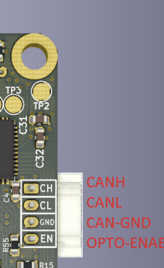

Are they all jst-xh? @SimosMCmuffin gotta get an extra 90deg 4 pin for mine
The balance leads have a 2.54mm pitch (JTS XH)
Canbus and I/O have a 2.0mm pitch (JTS PH)
I also used a 2 pin PH on the temp sensor
He was offering some other conecteres that fit with the same pitch but I can’t rember what thay were

Opto enable is 5v from the vesc (optional)
Ground is not recommended if you have any switches or loop keys on the - battry cables

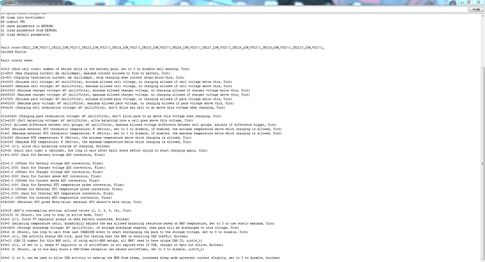

Every time my battery drops below 20% and I want to charge it I get Faults on FlexiBMS (Low_Volt:1 for all cells) after clearing faults it charges normally, is there any setting to prevent it from happening ? (hate to remove cover every time to connect usb to flexi)
10s4p on LG MJ1, charging on 40V 1.5A
My only thought is maybe in that last bit of riding, your cells are sagging below the 2v minimum cell voltage you have set($3).
All cells are fine and dandy, checked few times :stuck_out_tongue: No extra sag :stuck_out_tongue:
But on hard acceleration towards the end of SOC they may momentarily dip below that :man_shrugging:
But dude, the issue is when I want to charge battery and it is below 20% I got faults in flexi BMS, battery voltage do not drop below critical level, there is no sag and board is not working alle balance leads are fine, this is strange. Also I rode max 30kmph, this board is for chill rides :stuck_out_tongue:
So what is the voltage of the cells? What voltage do you call 20%
3,9V :slight_smile: 20% on wand :stuck_out_tongue:
So your saying all cells are at 3.9v?
Not all, but around it. Issue is this faults are persisting and I looking for any answer. I need to add I do not have this extra diode installed ( https://www.digikey.fi/product-detail/en/micro-commercial-co/BAT46WS-TP/BAT46WS-TPMSCT-ND/10054316 )
So what voltages is the flexi reporting
Fault codes from screen shot few messages ago :stuck_out_tongue: Now I wont tell you because I charge it after clearing fault codes. Also wheare flexi shows cell voltage info in console?
