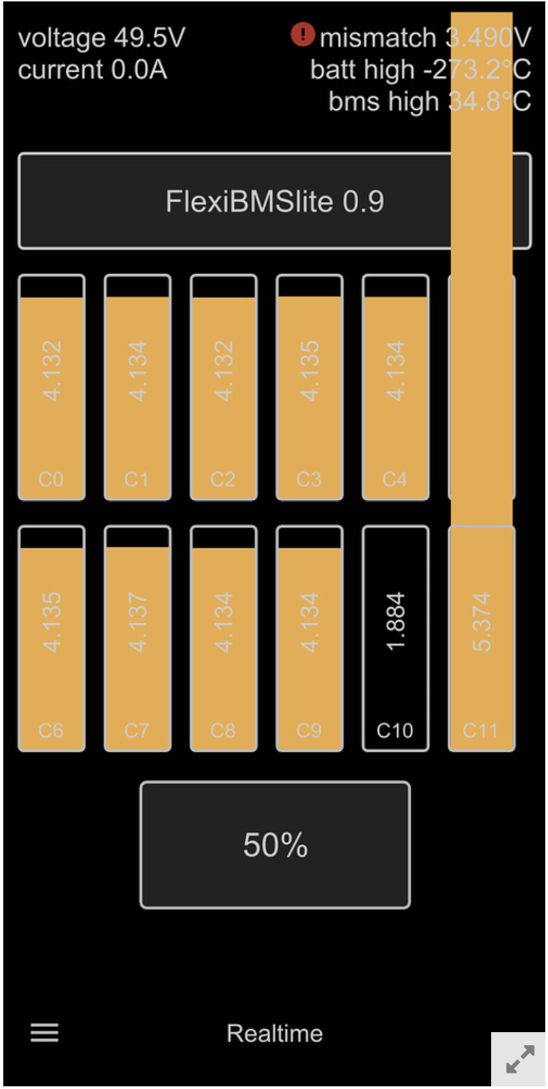

I had this phenomenon before, but it was due to a slight contact failure of the 13p balanced connector.
It was improved by slightly bending the corresponding balance connector pin.
In this state, one cell is 4.1V or higher, and charging will not start even if the total voltage is low.

Okay So ive got a fault where cell 10 is Undervolted - Its hard to say if the group is blown or just overdischarged (likey OD) - Anyway via comand to see the volatge, and tempoarilly, allow charging to try and revive the cell group?

I did, im not savy like that - just need the dummy version for what “$$”? command would allow me to eneter the values (if that dosent resolve the issue - i do see how i can lower the volatage that charging can be allowed, but id like to know what the current volatge of group 10 IS)

Managed to get all configurations working how do I bypass an undervolted cell group? Tried to lower the battery-charge voltage minimum to 2,1.5… even 1 - (the group is at 1.6-7). Would setting the Sgroups to 9s resolve ?
(10s4P30)
