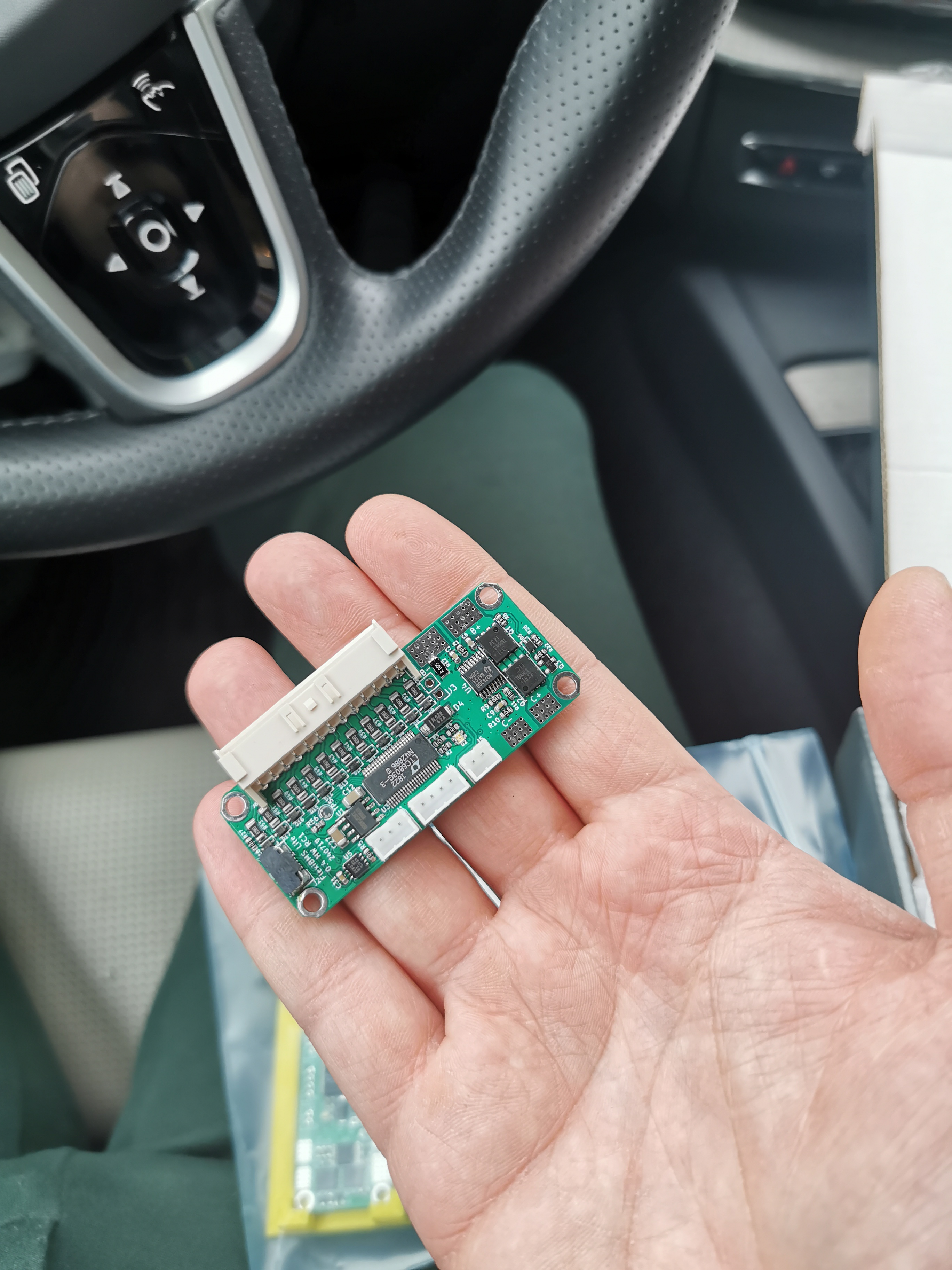

Wow! Its so small alot smaller then I could imagine! I love this by just holding it :grin:
Awesome its super compact! would definitely pick it up if it works :slight_smile:
Yeah, once you guys get this to work correctly, it will be a game changer. That’s for sure. If the price can be around 50 EUR, I see no reason for anyone to use anything else.

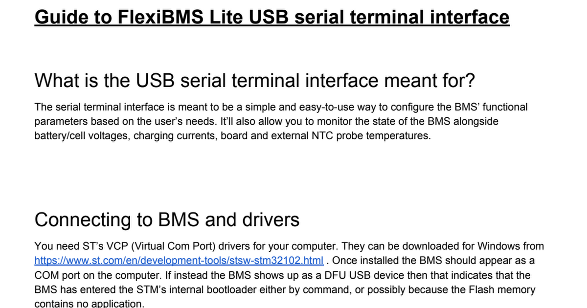

I’ll try to get the first draft of the serial terminal configuration guide up today, so you can start testing the board.
Here’s the first draft version for the serial terminal interface guide.
Thoughts and feedback are welcome.
Yep why iv been watching it sins it started on the other forum. Been able to stop the discharge through can means I think it way better than a charge only BMS as well almost need a new name as me for its own category IMO
Hey, got a quick look at the configuratio guide. Good job!
One thing I couldn’t really find is if there is the option to balance only when charging or all the time. Is that a possibility?
Currently balancing is only done during charging, but making it enabled all-time with a configurable value wouldn’t be a big code change.
Great detailed description :+1: The description for parameter 4 o 8 looks as if they have a copy paste error, it’s for max values but the description says it won’t charge if under these voltages.
Fixed.
For me personally it does. No idea if I’m the only one :sweat_smile:
I linked a baked .PDF format from the Google Word doc originally, which of course doesn’t update live as it is edited, but I changed the google drive link to now go to the actual Google Word document, so changes should now show up as they are done.
