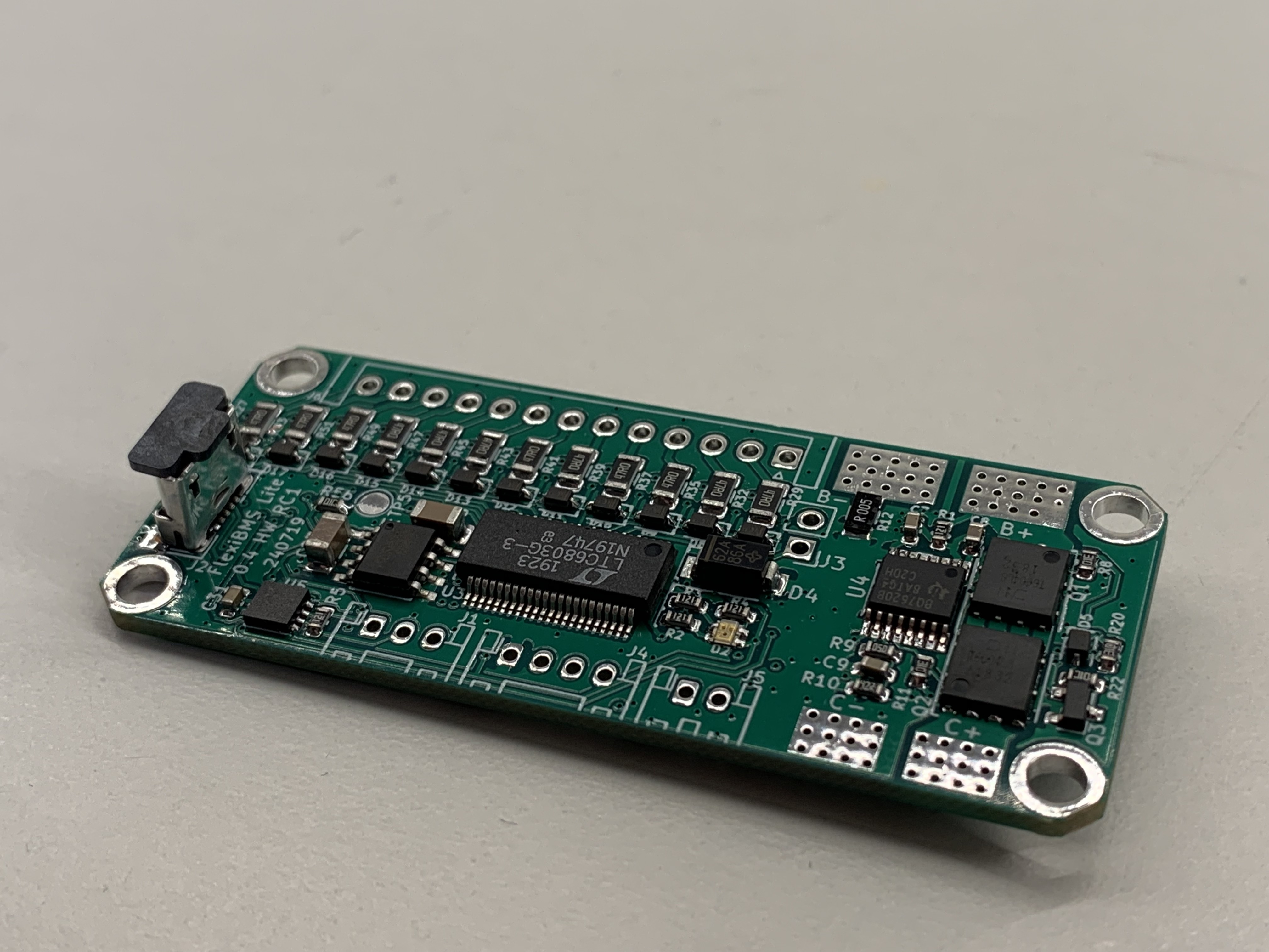

Received the board yesterday. Soldered balancer JST XH 13pin, charge wires and discharge wires on for testing.
Connecting via USB worked fine. Would be good to know if the BMS can be powered for setup with only USB connected or a battery connection is necessary. I connected my lab supply (set to 16V 50mA) to the battery wires and only connected USB afterwards which worked fine. Not sure about only connecting USB. Maybe that can be added to documentation.
I used Coolterm as a terminal to communicate with the FlexiBMS. Baudrate should be set to 9600. Would be great if that could also be added to the configuration guide.
Following the guide setting up the BMS configuration worked as expected. Looks like I have some trouble with the shown battery voltage, but I will write a PM to @SimosMCmuffin about that.
the MCU can be powered with just the USB, so you can configure settings without a pack connected, some things seen in the State printout might be jibberish as other circuitry need to be powered via the pack terminals, for example the LTC6803 stack monitor IC and external NTC probe biasing.
Just tested on Hterm and the arduino serial terminal and they work regardless of set baudrate, as the COM port is virtual and uses USB communications to move the data, but I can see the possibility that some terminal programs might be pickier. I’ll add this possibility to the serial termination use guide.
I took a peek in the charging algorithm to see when the battery voltage measurement is enabled and it’s currently only enabled if your ($0) packCellCount is set to 0 AND charging, as the BMS then operates with the pack voltage instead of the cell voltages. So seems to be working correctly.
