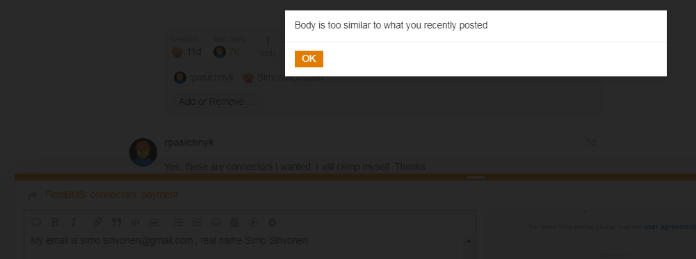

I’ll get the rest of the testers their payment info as soon I’m able to post the identically bodied messages.
The messages are sent 7/10
EDIT: All sent.

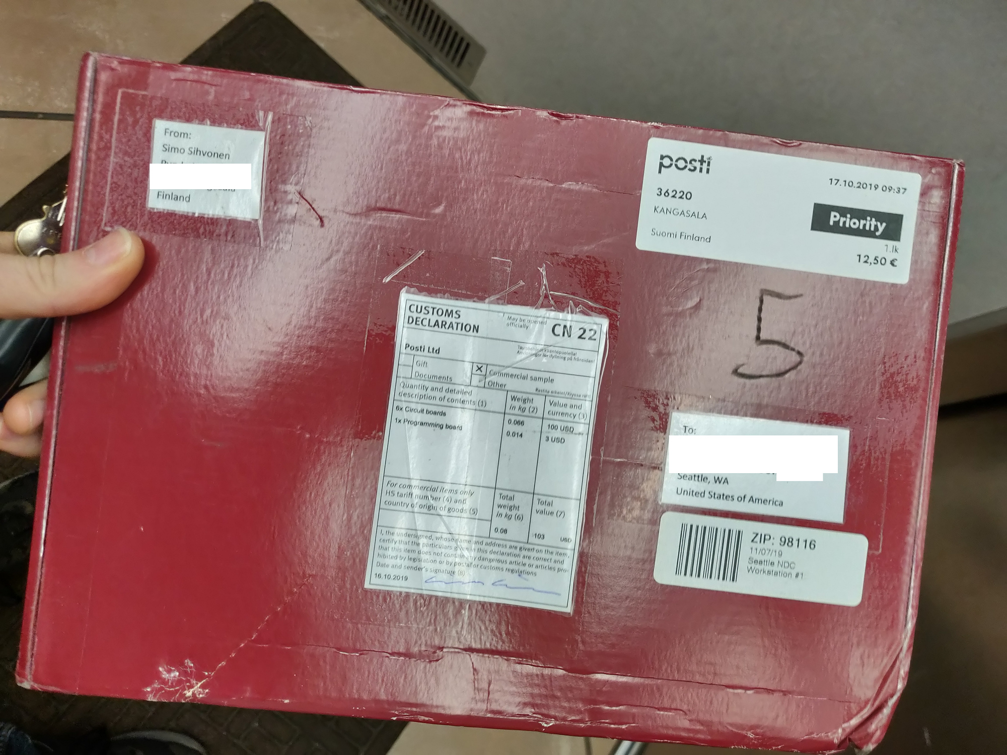

The letter arrived to my US contact! It was sent on 17th of October, so it took a little bit over 3 weeks to arrive.

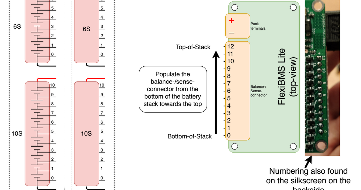

Anyone got any feedback/thoughts on this battery pack wiring guide that I made?
Looks good, I would just add at the beginning or maybe in every page, big and in in red that the first wire of the balance connector always go to the negative of the cells, not between cell 1 and 2, there are some BMSs that doesn’t require the first one
Maybe you can also add the CAN, Charge and UART (right?) ports to the diagram?
Beautiful :ok_hand:
This was meant to be just the battery pack side wiring diagram.
