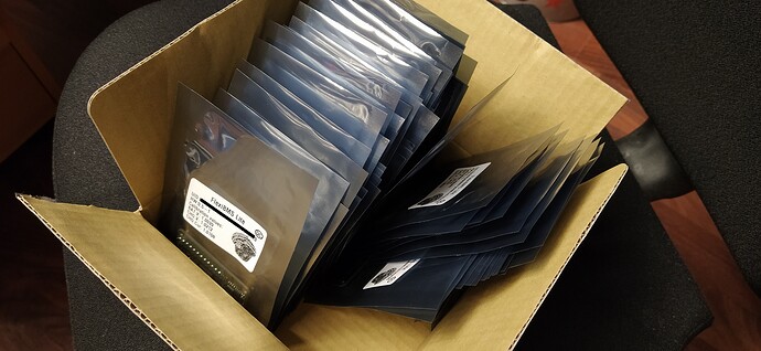

Got the production tester completed and ran the 79 boards through it. Average time for one board, once I got some final optimizations done, was a little bit under 2 minutes. This is a great improvement over the old setup that took about 7 minutes per board.
I’ll be opening sales soon and I’ll be adding UPS to the available shipping options. Not sure if I’ll be moving all shipping under UPS, but I’ll start doing logistics via them. CAN-bus supporting bootloader isn’t out yet, but will be ready to start testing phase in a couple of weeks. This will be a great feature for people who are using Metr to monitor their system.
