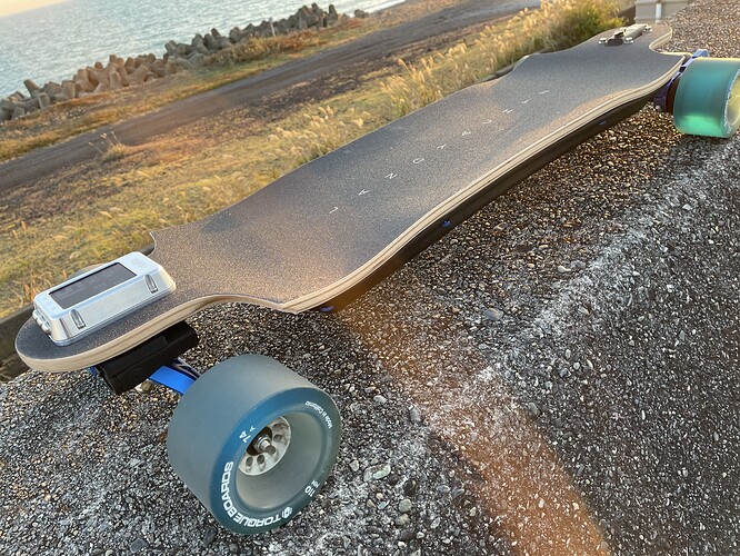

I have been patiently waiting to get DAVEGA X. The combination of Flexi BMS, DAVEGA X and Metr is wonderful!
The cell balance is also very good.
