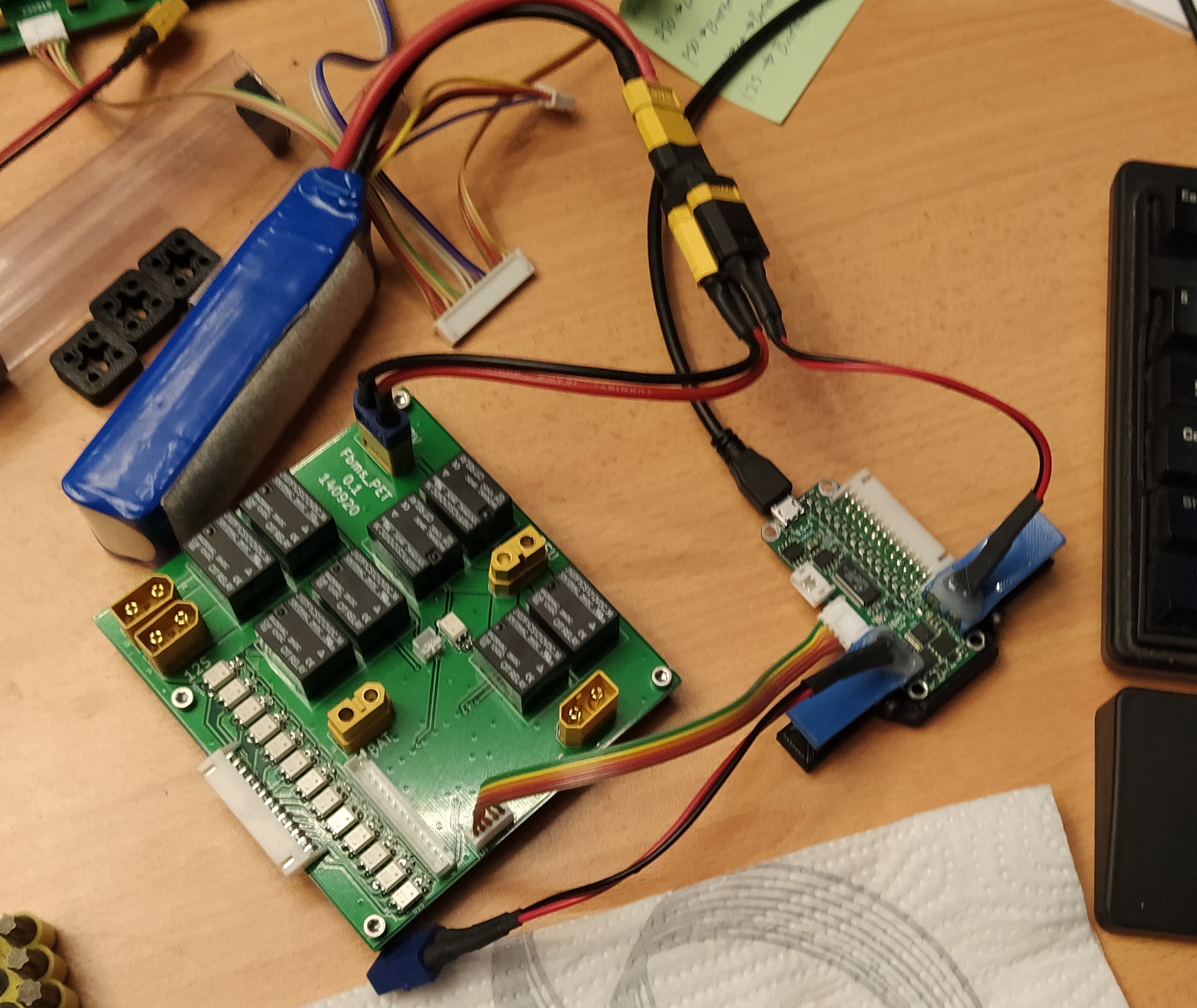

So, the progress on automating the electrical testing further? The PCBs have arrived and I have assembled and hello world’d the single board that the HW is working as expected. I’m currently writing the specific testing scripts.
Here’s a pic with the single Lite that will be working as the tester’s “master” controller connected to the relay board’s GPIO-extender (MCP23017) via I2C, which then can control the relays on the board. There are normal mechanical relays for the “high-current” connections and then optp-mosfets for the 12S test battery cell sense connections. I will use the normal serial connection to the master tester to send commands and receive results.
The point of this relay board is to be able keep all the external sources/sinks connected to it and then disconnect and connect wanted external devices with the relays without messing about with plugging and unplugging connectors constantly.
Once I get this working, then if I could have a remotely controlled PSU I could automate the whole process pretty much completely… Well I’ll finish this automation step first and get the current boards tested, so I can start selling them.

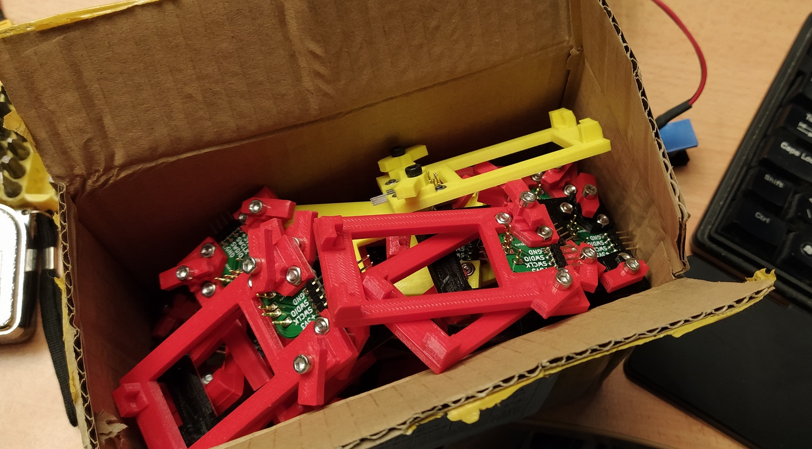

I also made a batch of these eZ-programming jigs for the Lite BMS’ that makes it super easy to connect a SWD-programmer to the unit thanks to the spring-loaded pogo pins that make contact with the test pads on the bottom of the PCB. Probably gonna be around 5-7€ ea. .

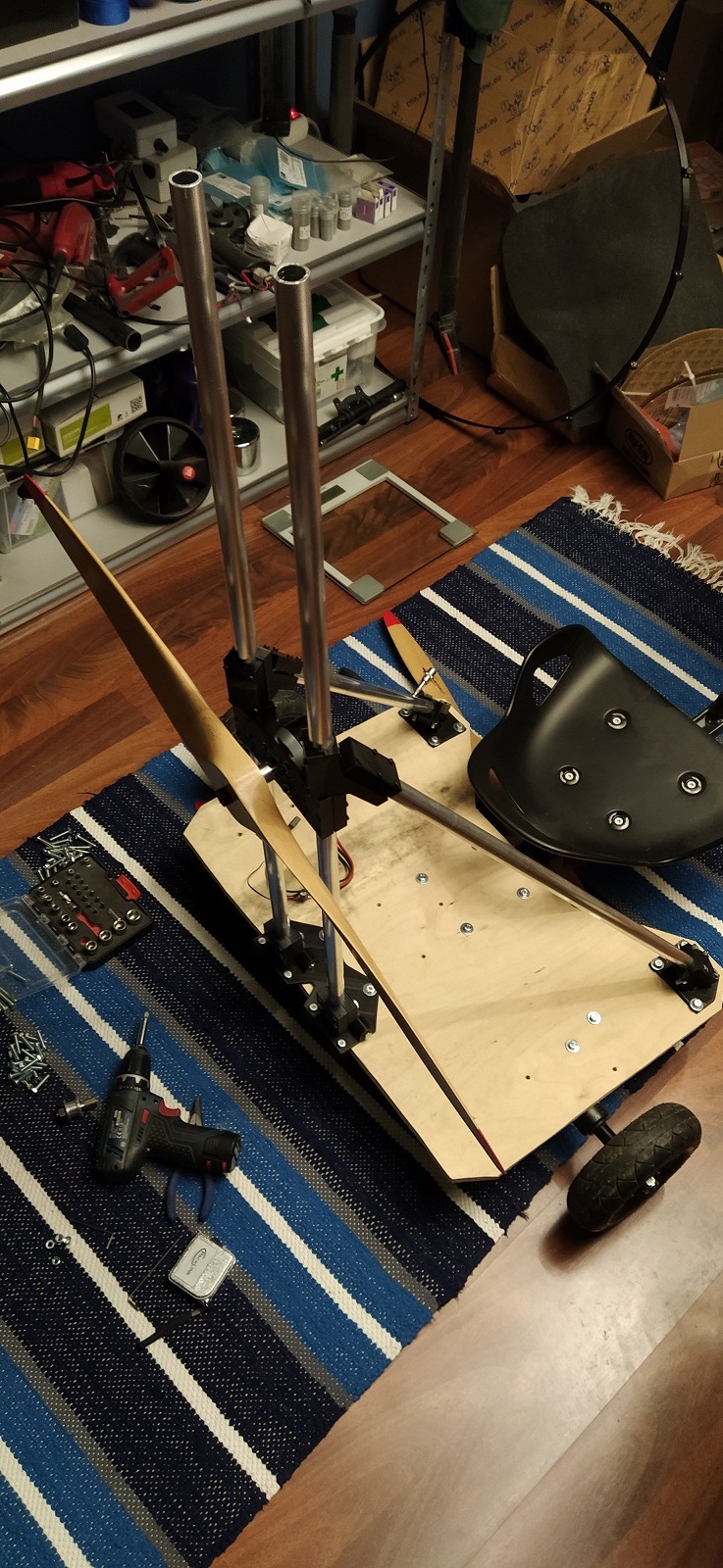

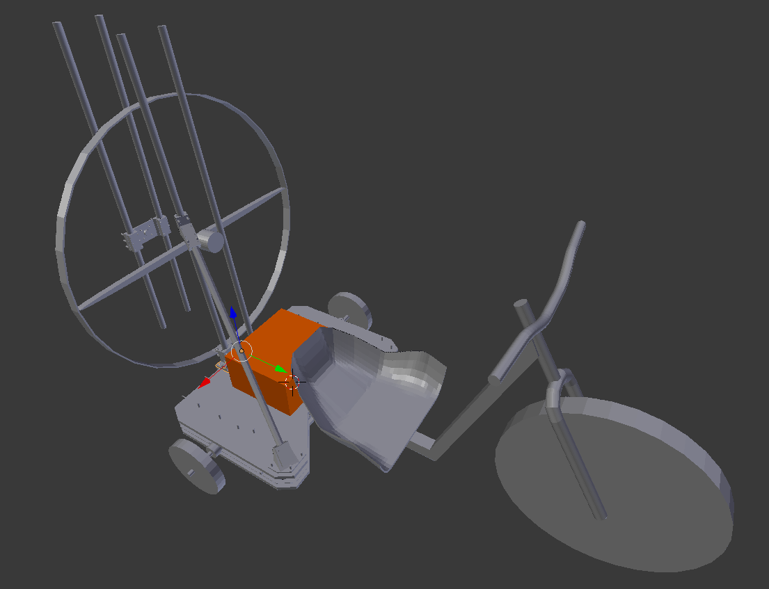

And of course, as winter is approaching (or was couple weeks ago) I have started to working on my winter light EV that I can tinker with and use during the winter, as my board will be in the storage. I’ve been calling it an ice speeder, because I was thinking of going and riding it on the frozen lakes, but we’ll have to see if we actually get any snow up here this year.
It’s being built on a drift trike chassis that I had impulse bought of off Ebay couple years ago and then realized I didn’t have time or motivation to really start building anything out of it.
The thing is that I’ve had a couple of these bigger scale RC plane props unused on my shelf (20, 24, 28, 32"), so I wanted to see how much thrust they can actually produce. Hence the concept shown below was born.
So, got some plywood, made some jigs, drew some lines on the plywood with the jig, cut some plywood on my kitchen floor (as you do).
I currently have the front supports prototyped and attached. The plywood bolts onto the same mounting holes on the chassis that the plastic step guard used.

Now there is a quite real possibility that it won’t produce enough static thrust with reasonable power input to actually be usable and at that point the solution would be to switch to bigger diameter prop, which would produce more thrust for less input power AKA, I could actually get moving.
Backup plan would be to ditch the giant blender/hairdryer and use my esk8’s motors directly with the back wheels with an appropriate belt drivetrain. Been looking at some local hardware stores for nicely sized wheelbarrow wheels and make custom rims for them with correct bearings for the back axle.

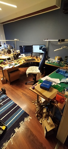

I must admit at this point that I am nearing the point of starting to seriously consider looking for a workshop, as even I must admit, the “living room” is starting to feel a little cramped… I wonder why :smiley:
maybe I can fit the table router in the corner…

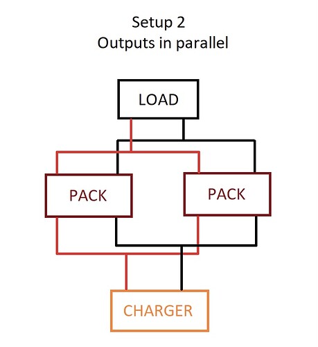

The software support for running multiple BMS’ in parallel from one charger is a bit complicated and tricky. There are quite a number of possible fault conditions that can happen and that can potentially be quite destructive depending on the scenario.
I think building the needed software support should be approached from the perspective of the potential fault conditions (potential fault conditions need to be recognized first) and then figure out what things the software needs to do, to be able to detect, prevent and correctly handle them when operating multiple parallel packs, regardless what the setup is.
I think these are the two major possible setups or with bigger setups some combination of Setup 1 & 2.
The battery packs in the XL40 & XL50 boards We build are configured as this setup #2
Using on each 12S-3P pack a 12S-30A BMS for cell balance, charge and discharge and by sourcing cell from same production batch these tent not to drift.

What are the risks of Setup 1 I figured if the packs have equal voltage, it would be safe.
Yes the pack voltages will be same, but there is a chance that one of the packs could have a cell that needs to be balanced out more before the pack can be continued to charge,
say for example cell voltages were 4,10:4,10:4,10:4,20 in a parallel 4S packs in one pack.
Let’s say other pack has 4,125:4,125:4,125:4,125,
both pack voltages would be 16,5V but the other pack has that single cell that is right on the upper limit, now it doesn’t matter if the other BMS terminates it’s own charging due to the high cell voltage, because the other BMS will keep charging as it sees it’s cell voltages still as OK, but due to the outputs being parallel’d together, it will also keep charging the other pack that has terminated it’s charging.
That’s why there needs to be talk between the parallel packs, as either one could have a reason to stop or not to start charging.
