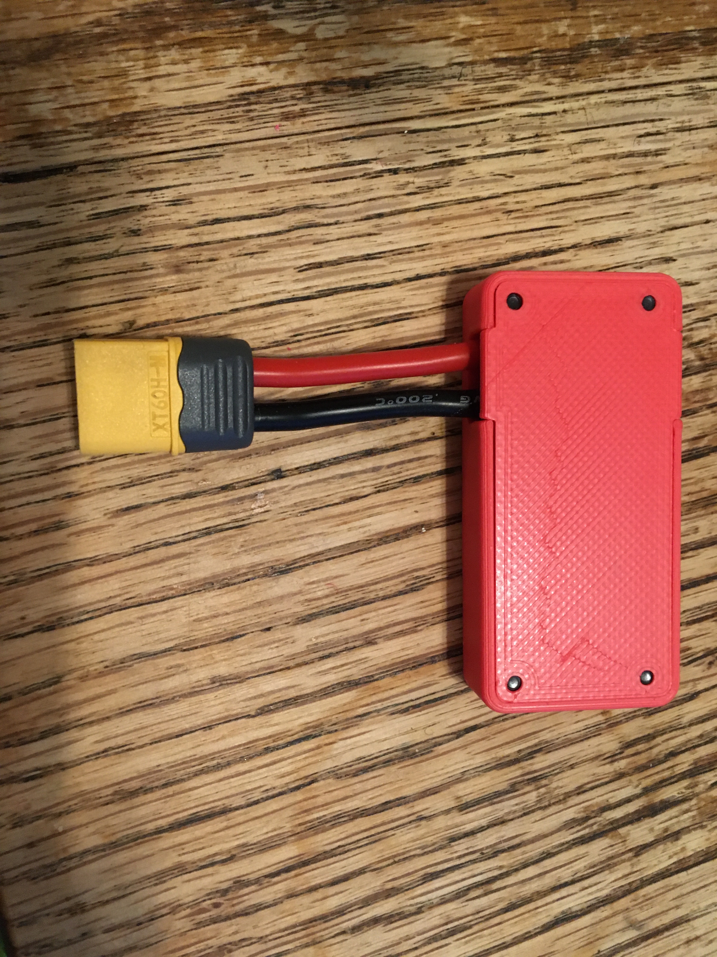

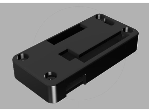

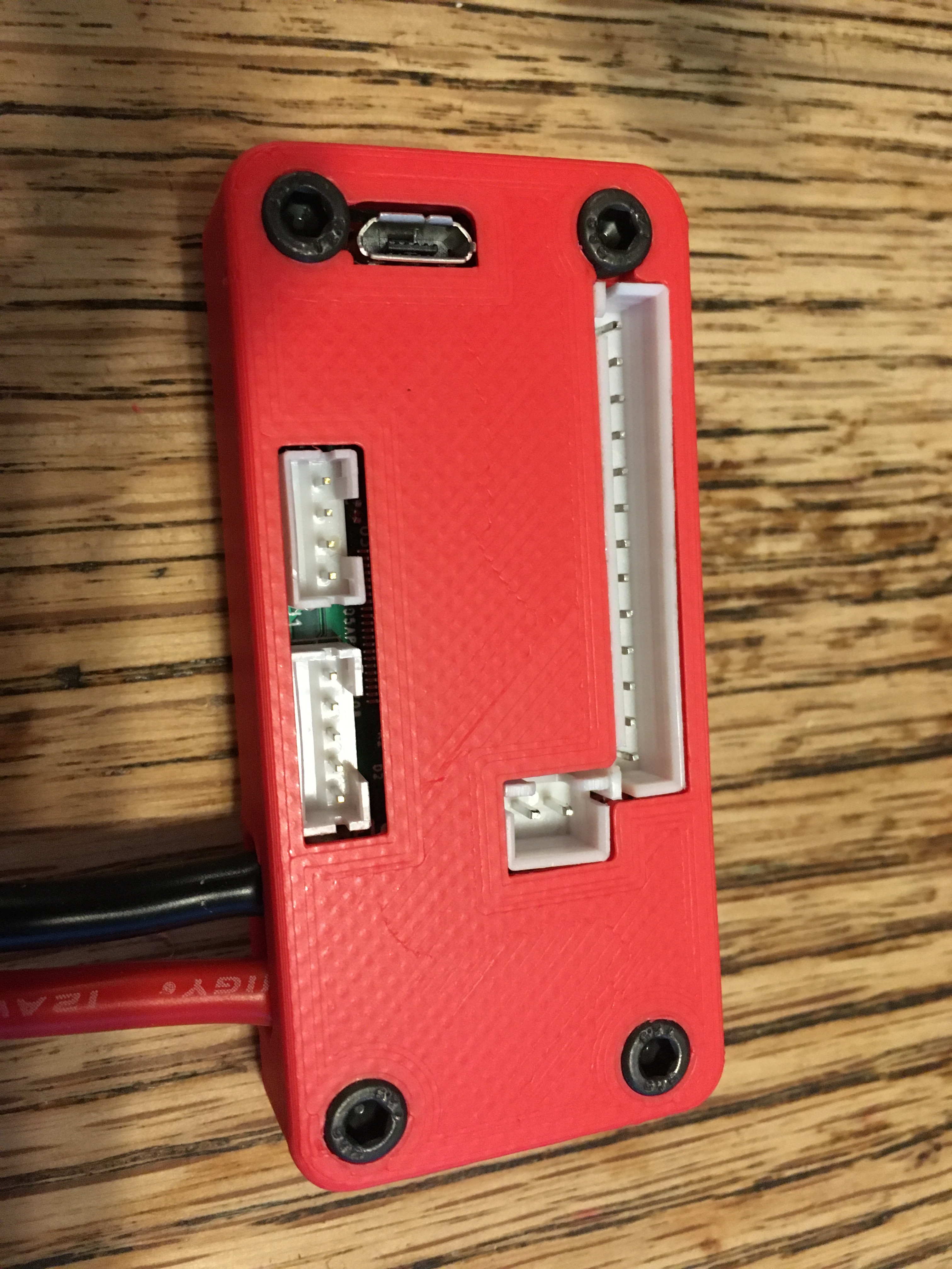

2mm thick walls, 4x 10mm M3 bolts
Over all it’s 67/32/13mm
had a go at uploading it to Thingiverse if it helps any one (first time iv ever uploaded so probably done all sorts of things wrong)

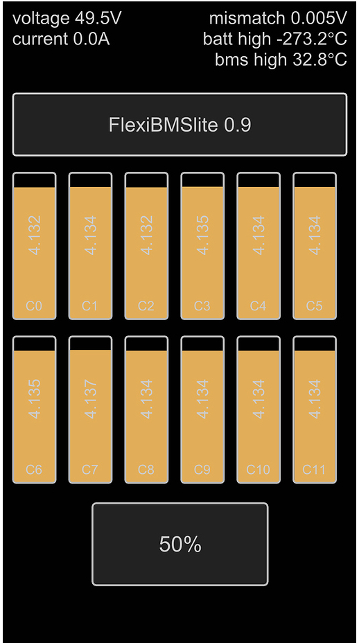

Bluetooth via UART?
Flexi BMS Lite-CAN-Metr-Bluetooth-metr app
I think you can use UART instead of CAN if you want
That’s would be awesome. Has to be metr?
As fare as I know the metr is the only one to incorporate the FlexiBMS lite, DieBieMS, LLT BMS. Tho the LLT has a separate BT to the phone and it’s own app as well
As far as I know, the only two devices that currently integrate with the Flexi are the Metr and my DAVEGA X. Both rely on VESC CAN forwarding and require the Flexi to be connected to VESC via CAN.
There’s also Metr CAN Pro that we’re currently testing and that will probably (?) be available for sale soon. That one can connect to Flexi via BMS directly (doesn’t rely on VESC CAN forwarding).
Either way, CAN is currently the only interface you can use to connect Flexi to the system.

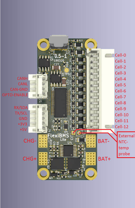

What’s this port for?
1 by parallel do you mean to be used in a 24s system (series’s)? In witch case no
2 would require changing them mcu for one with more input that will require a complete redesign
Thats what I want to know
Then what is that UART port for?
I don’t think it’s used for anything at the moment.
