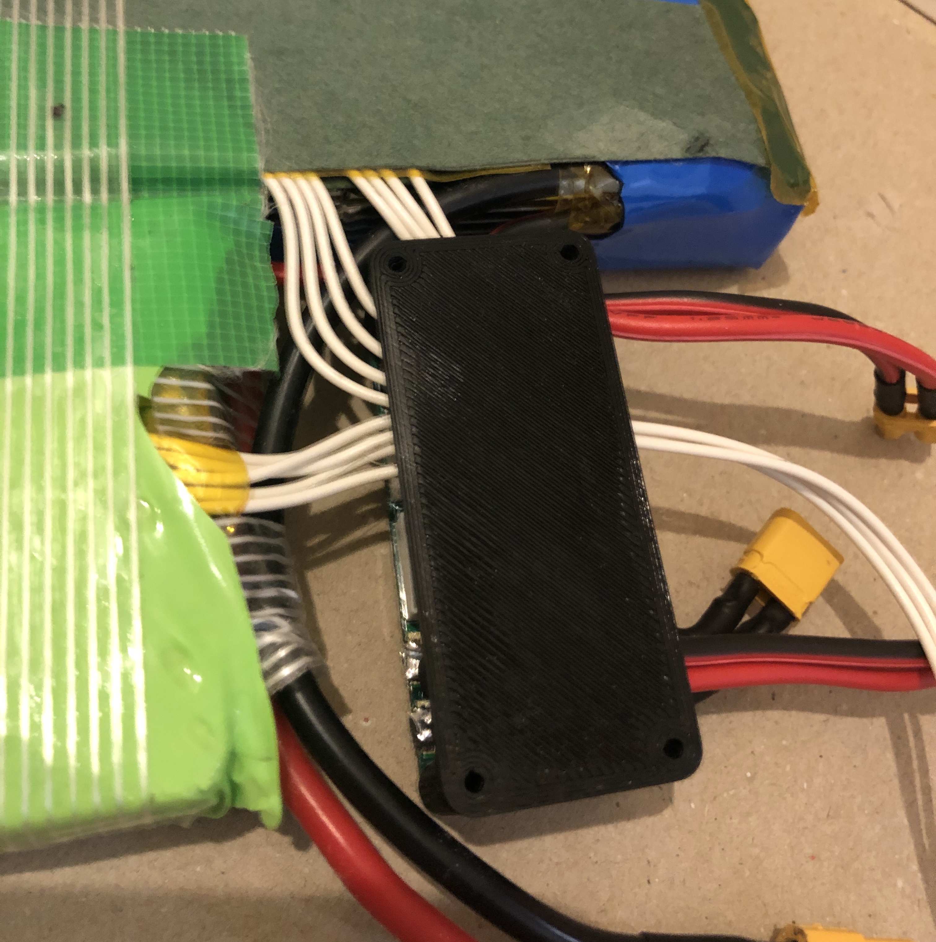

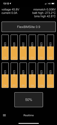

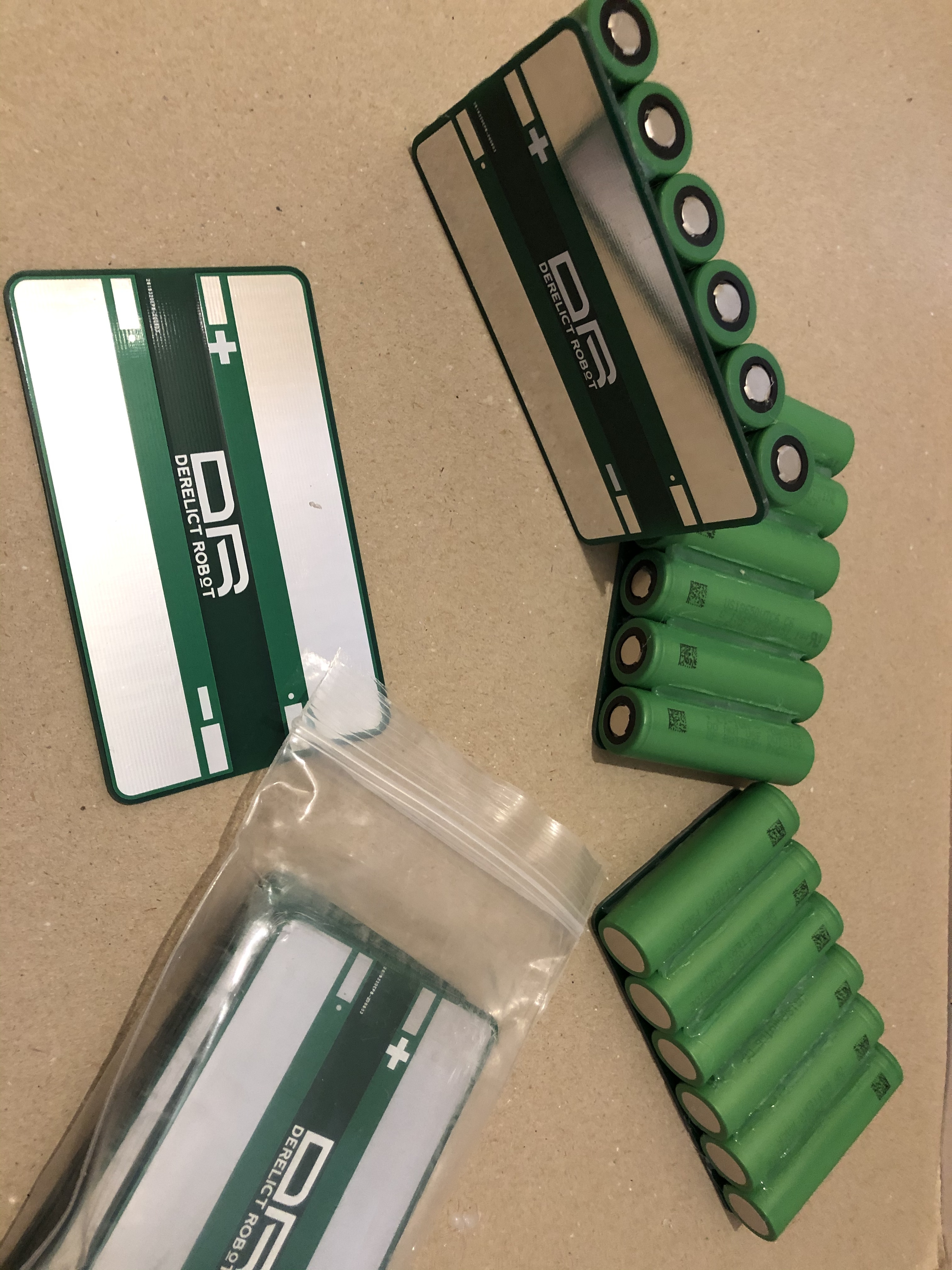

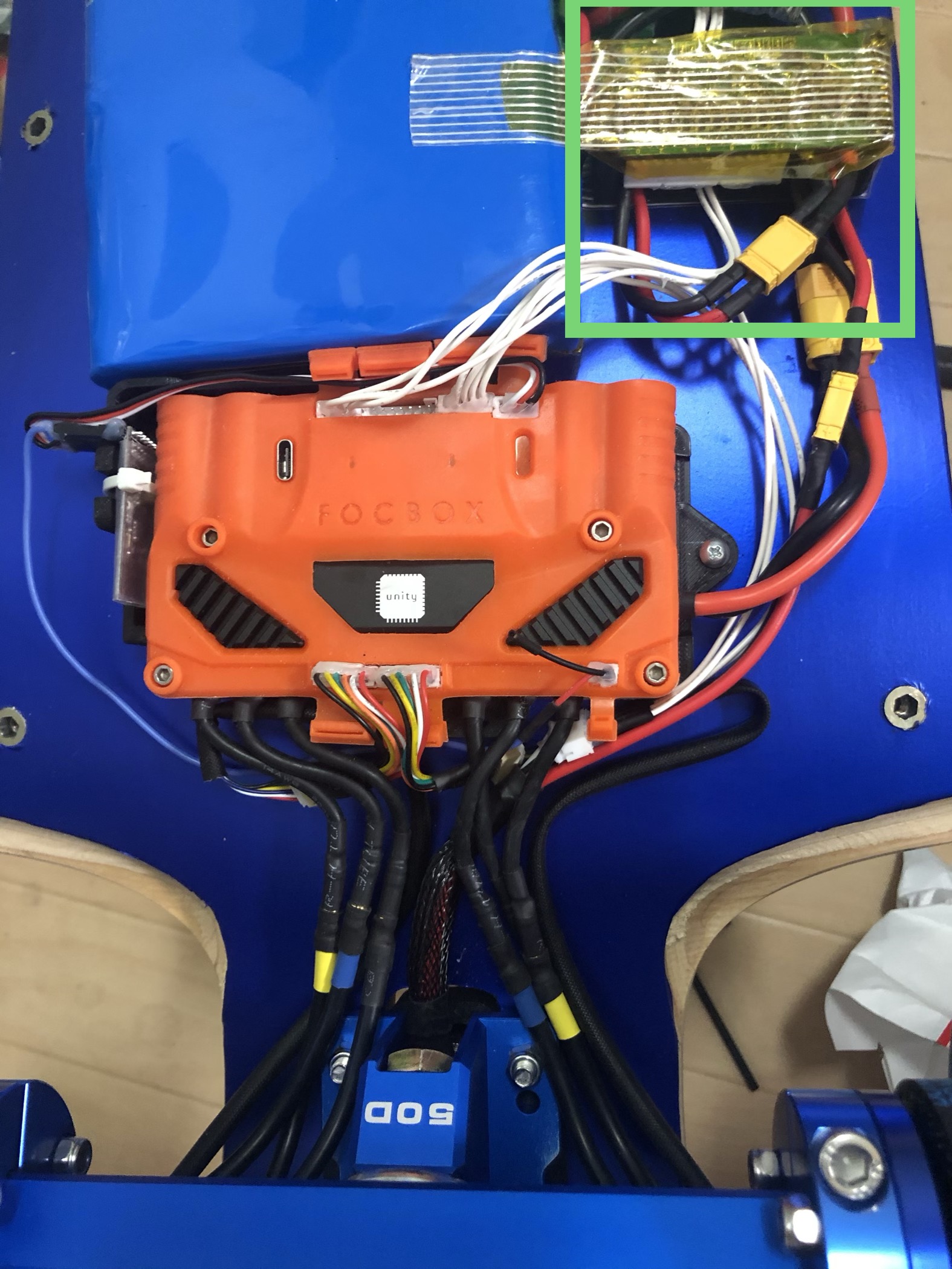

I put VTC6, 12s6p in the LY Switchblade 40 deck.

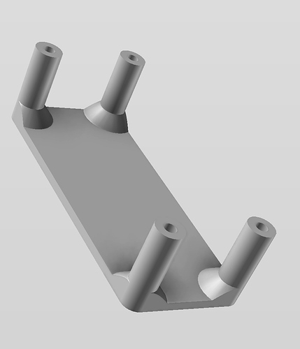

I made a simple enclosure with a 3D printer.
Flexi BMS contributes to space saving especially with a single stack battery.
It’s just amazing.

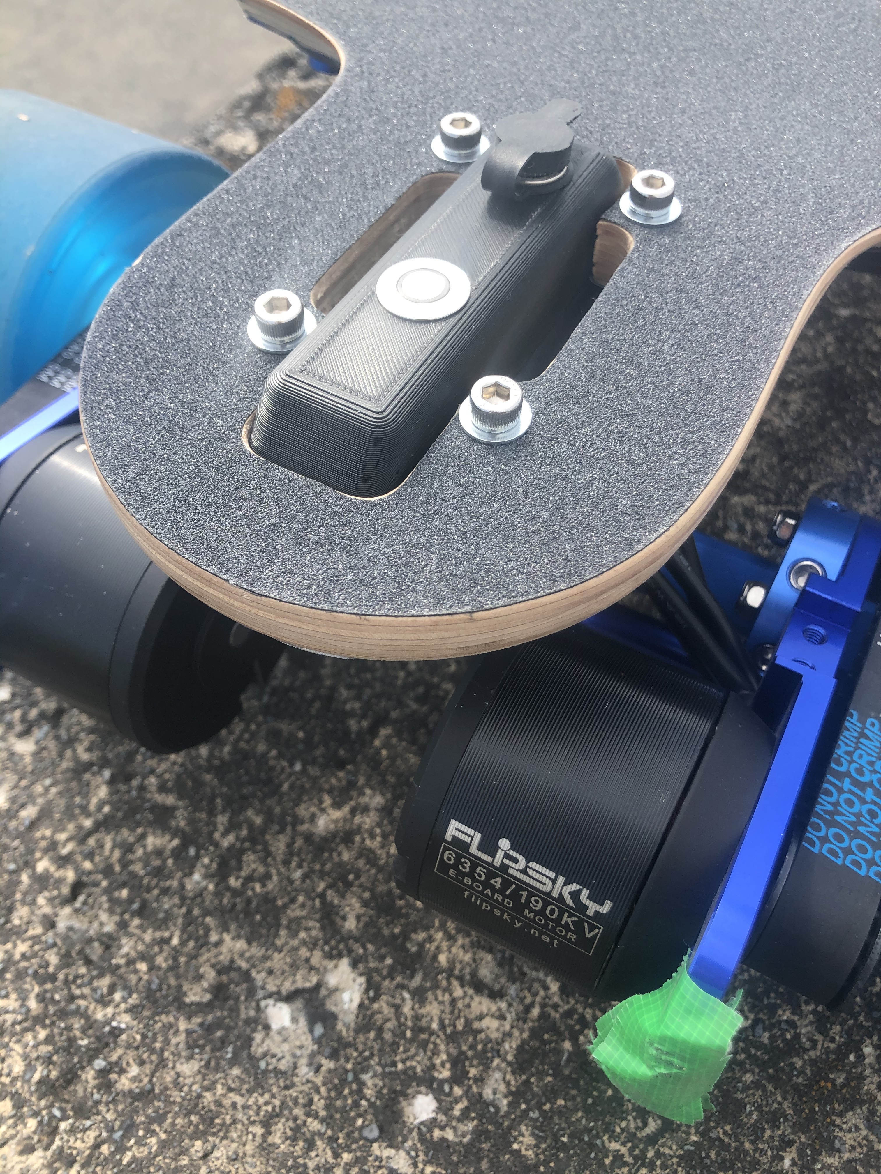

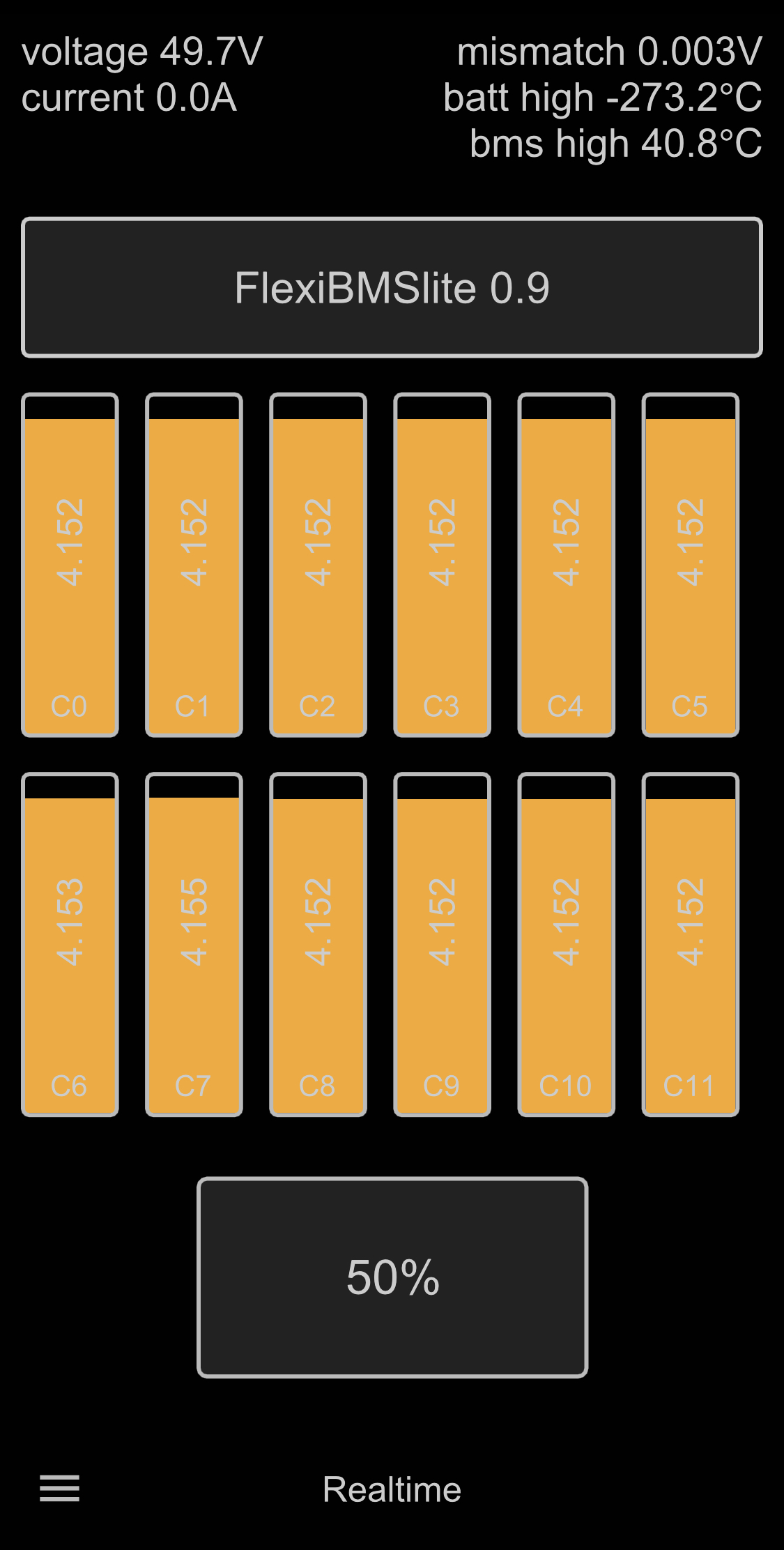

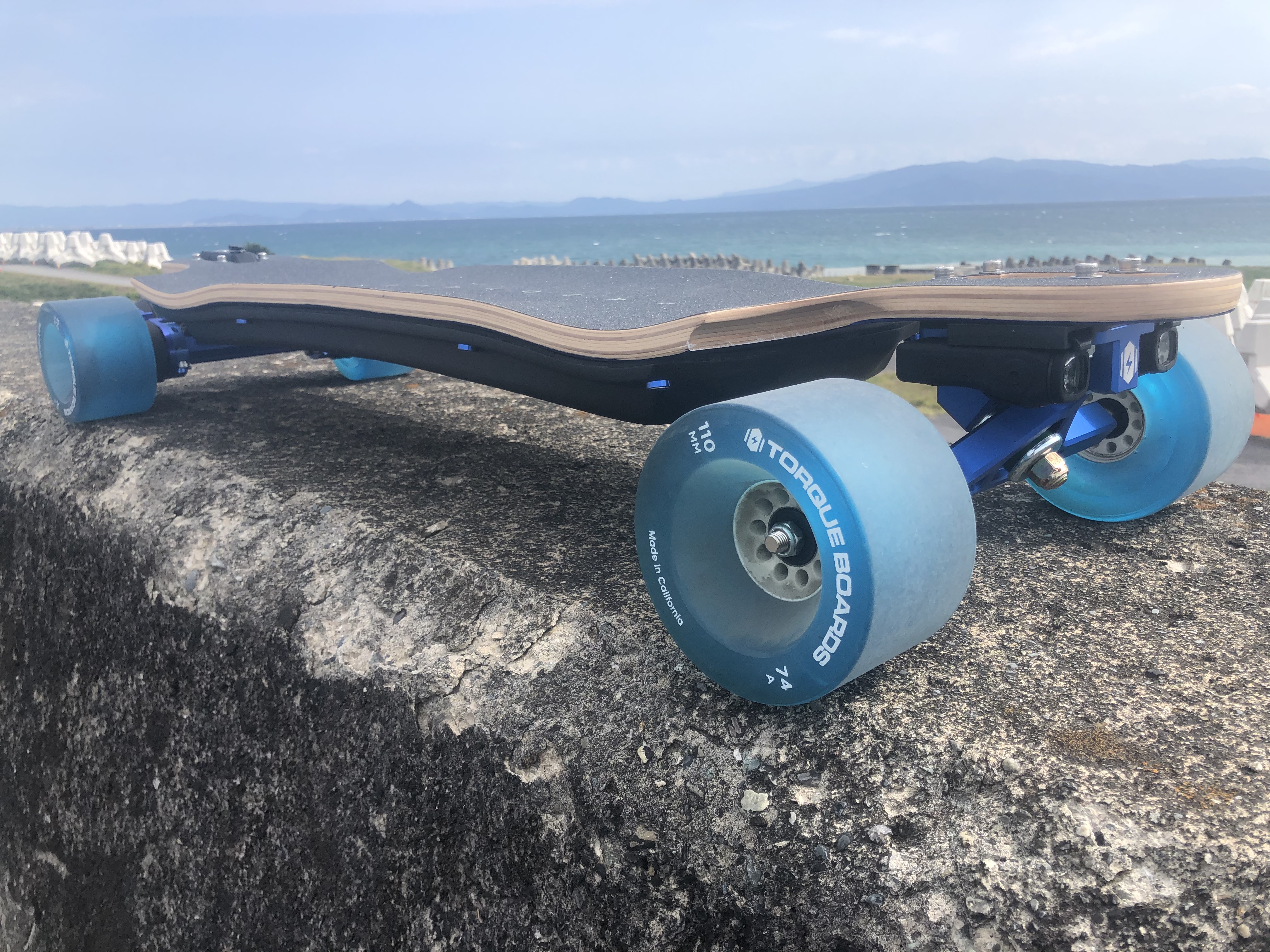

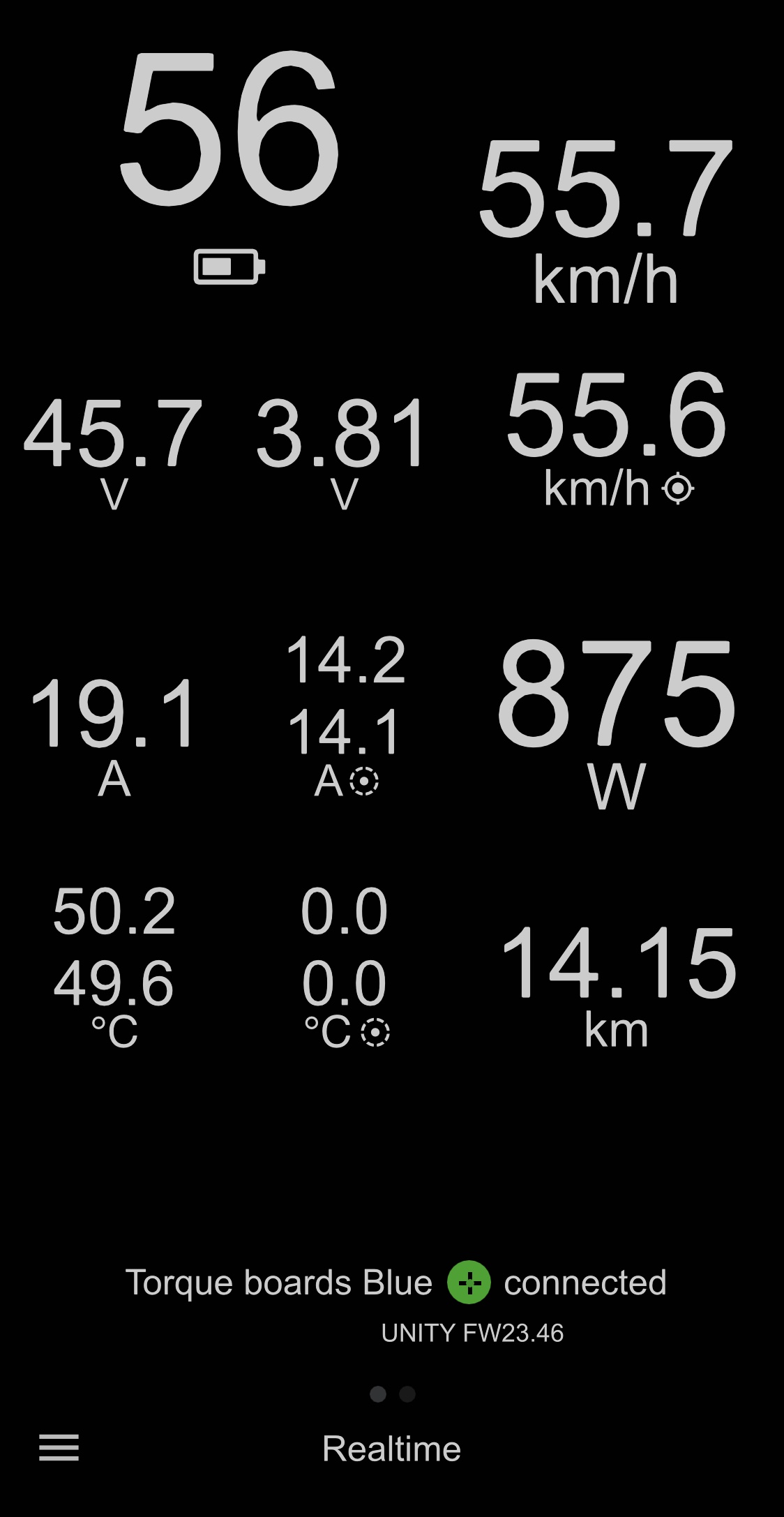

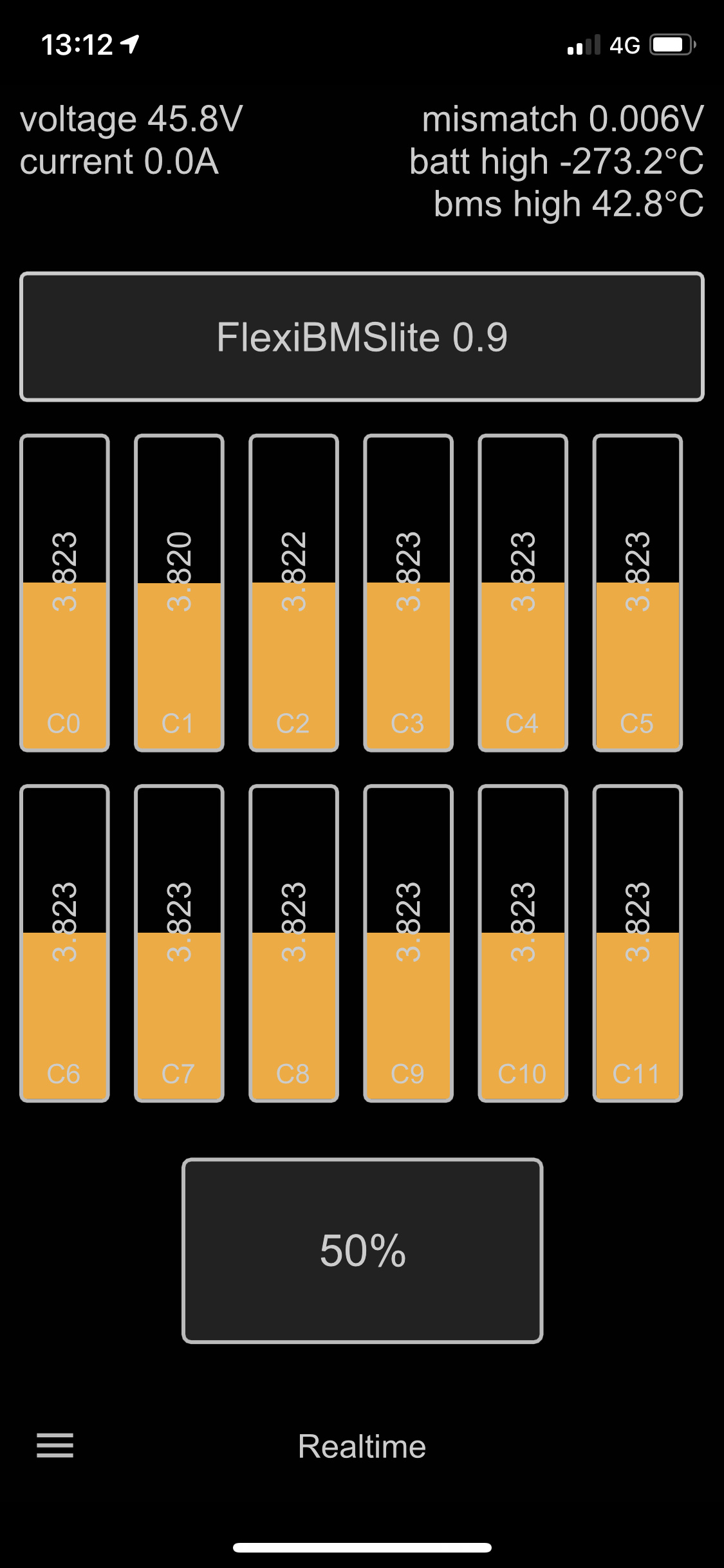

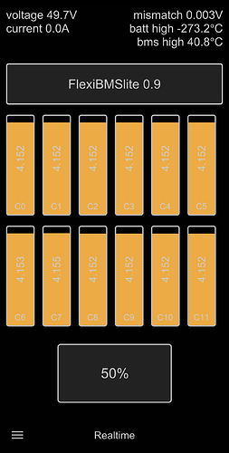

Esk8 using Flexi BMS is completed.
Sony Murata VTC6・12s6p 777.6Wh.
4.152V when fully charged is probably due to the $ 9 default parameter [unit 4180]
But I just use that setting.
There was no problem with charging and running. It is a good BMS that expands the possibilities of esk8 build.
The voltage usually goes down a little after charging stops (aka, resting voltage), so this looks pretty normal especially if you’re still charging with some current (>1A) when the cellTerminationVoltage gets hit.

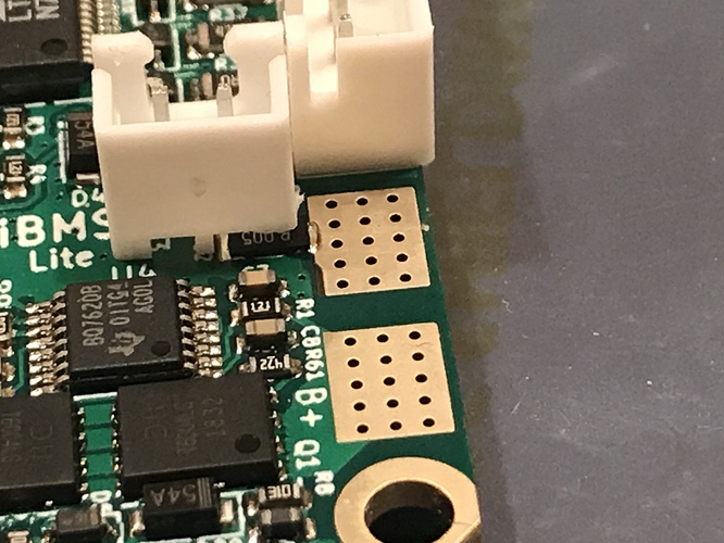

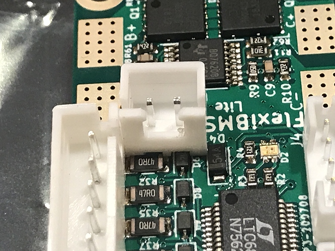

2pin XH 2.5mm fits if you trim the corner for the resistor that conect to the battery neg terminal

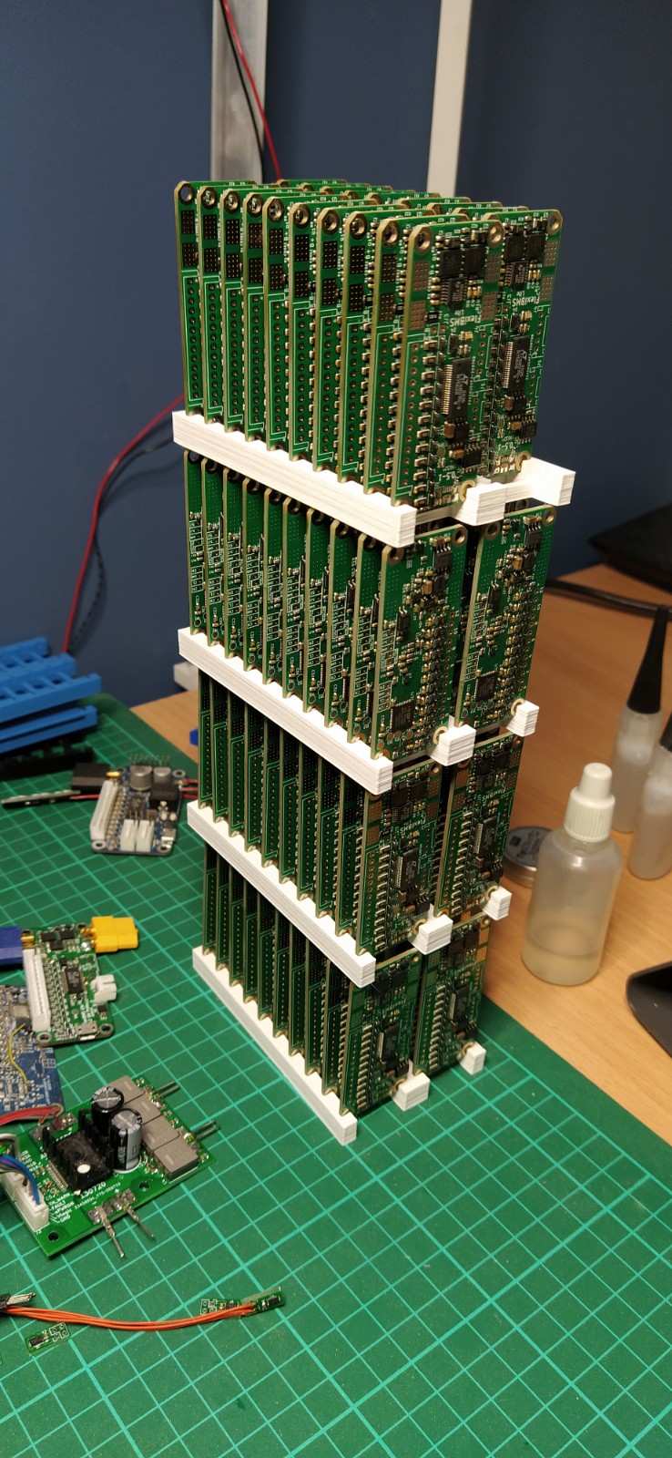

Update.

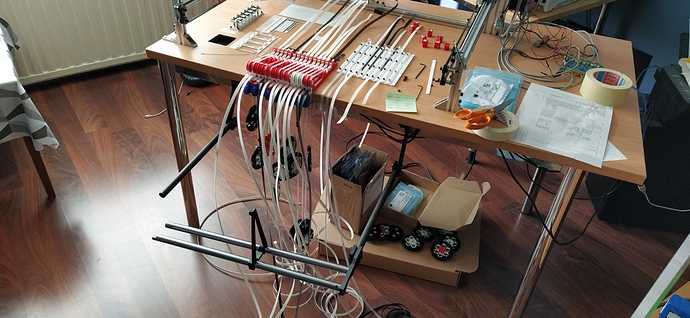

All boards are assembled (79 units), but are currently waiting for electrical testing. I’m automating the electrical testing process further to optimize the time and reduce the factor of human element from analyzing the test results (more consistent analysis). I have already designed & ordered a custom relay board for it and should have it next week. I’ll be writing some custom tester code meanwhile to a Lite-unit that will act as the master controller for the tester.

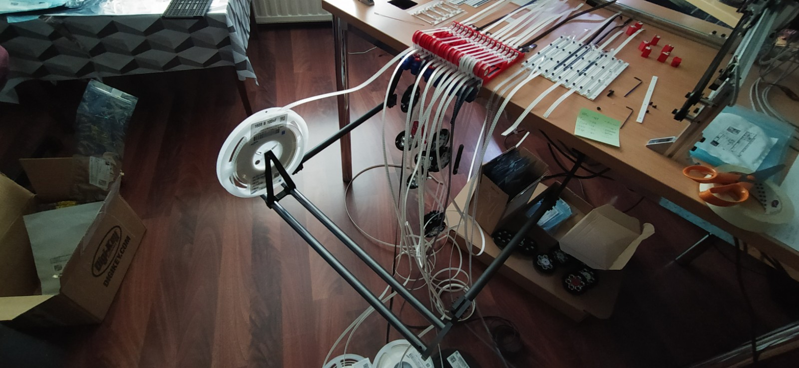

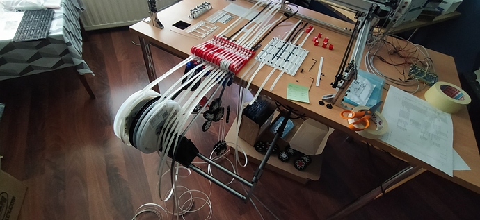

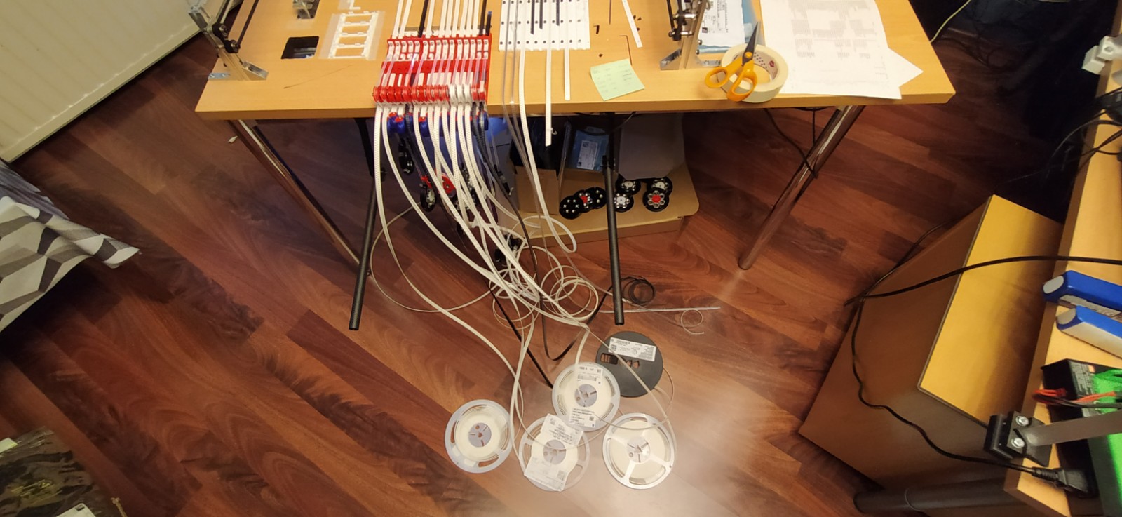

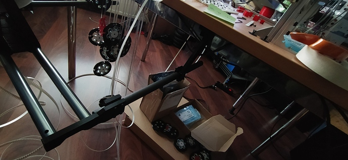

Towards the end of the build I also improved the PnP-machine setup further, by making a reel holder for the autofeeders. As you can see it really cleans up the setup and just makes it easier and more convenient to work with. Just used some misc tubes/pipes that I had in my shelves from my RC days. Makes it much nicer to use when you can just plonk in a 5000 ceramic cap reel and then not really have to faf about with it after that.

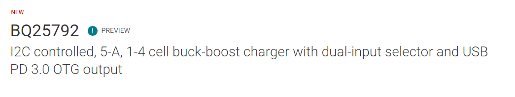

Side-topic question,
but would you guys be interested in an USB PD compliant powerbank controller?
I’ve been meaning to make a new iteration of my own powerbank controller (charging/discharging, customizable pack size) that would support USB PD (Power Delivery) up to 60W?
https://www.ti.com/product/BQ25792
