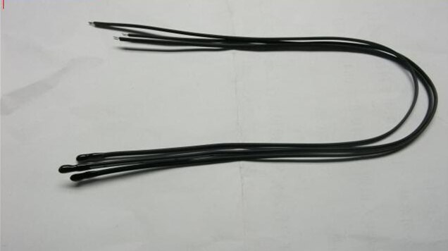

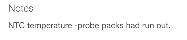

Wow temp probs we’re gone within minutes of form going live
Well I mean, I wasn’t even originally planning on offering them, because I only had the set of 10 that I had bought a long time ago for testing, but I figured “let’s see if they sell” and added them and the JST-RCY connectors as a pack.
If you wanna source your own, these are the ones I bought:

Back down the rabbit hole of trying to understanding NTC spec again
From what I think I worked out so fare
Resistance: NTC 10k @ 25C
Material constant B: 3380K (changing temp vs resistance correlation)
Temperature co-efficient of Resistance: 1% (Accuracy)
Thermal dissipation: ??mW (power)
iv seen ones as low as 3.5mW and others up to 50mW not sure what the right one is iv tried to have a good dig through the info on the github and linked Ali express page.
Is there any other part of the spec of a NTC iv missed that I should be looking at?
Generally power dissipation figures are not really restrictive if the NTC is only used to measure temperatures, as they really aren’t dissipating a lot of power in that use case.
What you really want to look at are the three parameters you mentioned above.
Then of course there are other things you also want to pay attention to like what kind of package is the NTC made out of? (0402, 0603 SMT packages, through hole, through hole but immersed in epoxy, through immersed in an epoxy in a metal shell…) So that it suits your use case. Might have to handle being immersed in water or oil for example, maybe corrosive liquids etc…

Thanks seems I gone to fare down the rabbit hole. The 2 I was mainly looking at was glass and thro hole epoxy tho I was unaware of the mettle case I just presumed it was dipped.
