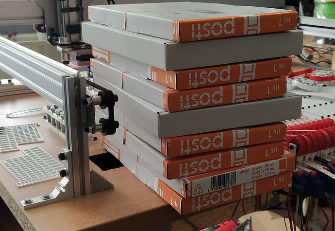

Off to drop off the first batch of shipments.
Also, good learning experience. Paypal deducts their fees from the invoice due amounts, so they nibbled away some… Well whatever… Account for it in the future.
Was this because this batch was personal stock not your shop your building?
These units are a part of my company’s production batch. I just wasn’t familiar how Paypal worked with their fees when using their invoicing system, so my fault I suppose. My Paypal account is a personal one, so I’ll check what benefits there would be to update it to a business account.
Am I in the first batch?
What’s the plan for second batch? Any time soon?
Will we be notified when the BMS has been shipped?
I have just sent the tracking links to all shipped orders, check your email.
:+1:
I will start working on the rest of the 75 boards this week. I’ll update on the situation as it progresses.

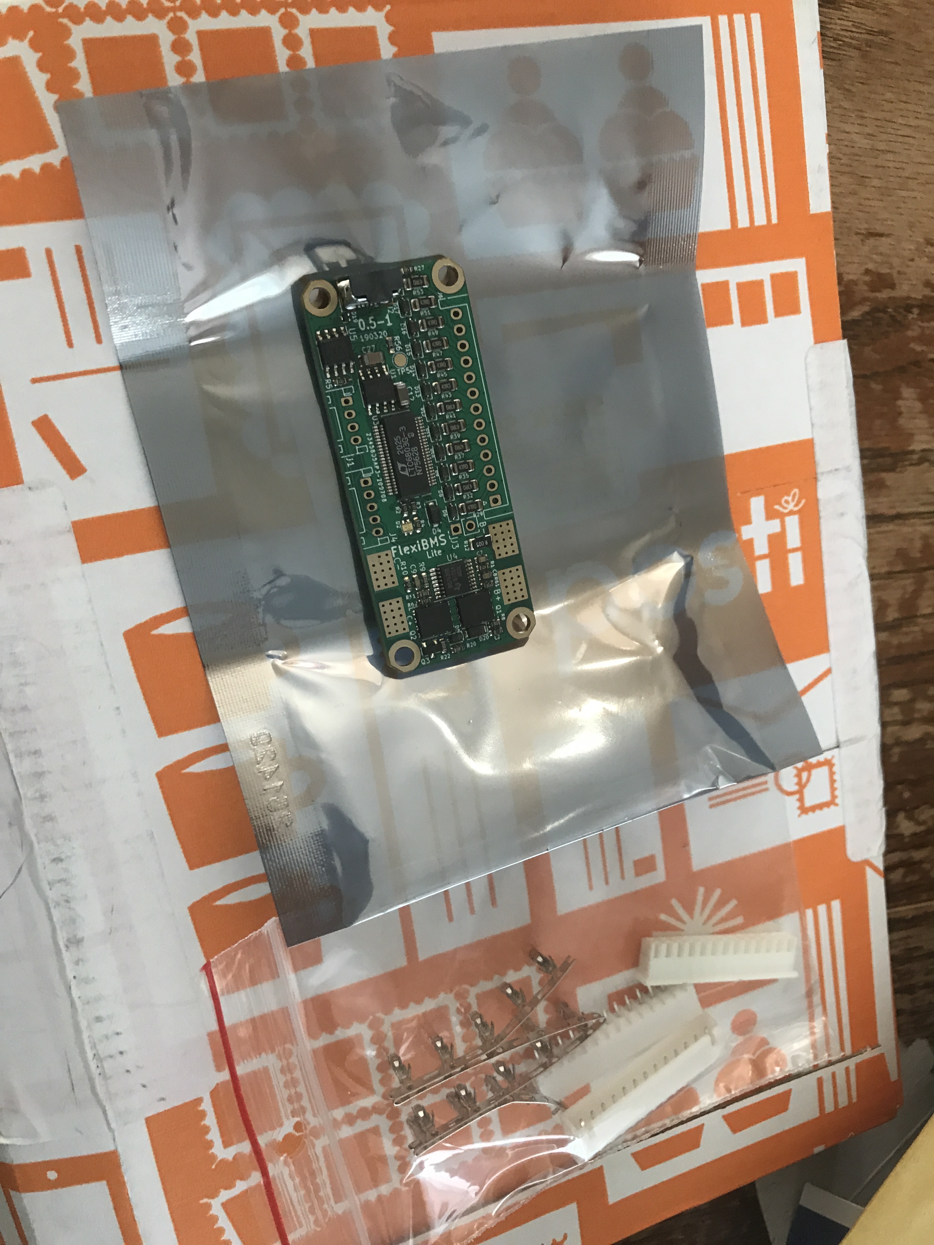

Postman arrived. the components are amazingly well lined up pick and place me nine has done grate job
Got mine as well, Thanks!

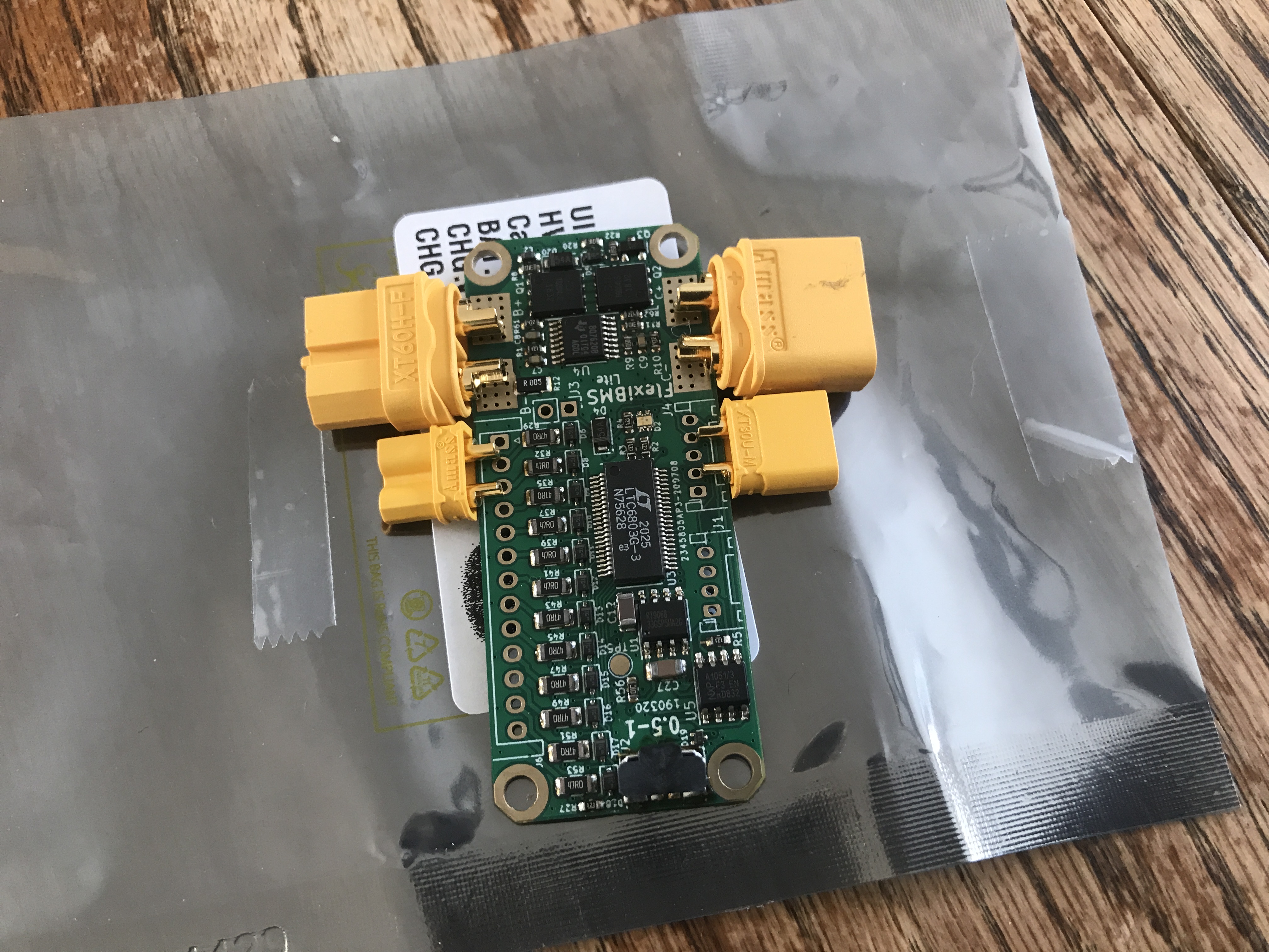

XT30 vs XT60
XT30 rated for 15A continues Flexi BMS rated for a 8A charge Current down side is XT30 only take a AWG18 cable 0.82mm2 and my fuse holders have bigger cable.
With the XT double the width I’m thinking little tails are my best bet
I have 100% soldered 16awg to xt 30
This is 14awg on a xt30
