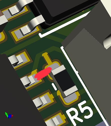

Ahhhh that explains it. The resistor is there to stop the loop on power off :ok_hand:
When i first set mine up they powered on but would not power off. I swapped out the whole can cable/resistor and it worked like a charm
image1920×949 270 KB
[/quote]
I don’t know if I would be able to solder on a pcb trace (never done one before) would creating a bridge hear work?
You can bridge it that way too
think it can work on any vesc that has a built in power switch. afaik it works on new vesc mk3 and stormcore too. just means that you dont need multiple switches for a system with more than one vesc.
now I want to know why that works. but we keep derailing here. :smiley:
Because electronics take time to depleat there charge
yeah. the resistor I get. how come connecting that 5v line switches the antispark switch on in the second unity. was that by design or accident? why does that work?
I think it’s more of a work around when thay realised something people would want to run 4wd and not have 2 switches
Its caused by the “roll to start”. Its designed that when the motors are spun and the system is turned off the voltage generated is fed into 5v line for the processor. As soon as there is enough voltage to start the main processor it boots and if “roll to start” is enabled the processor turns on its own 5v supply to keep it active. This start up 5v pulse can be caused by the motors or by any other external device.
