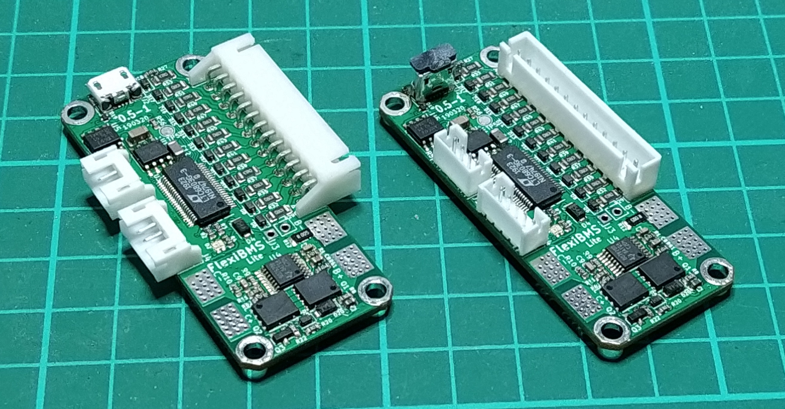

I have created this simple & short Google Form for anyone interested in buying some of the 10 boards that I have assembled with my own private money and before I turnover future sales to my company.
I’m going to prefer EU buyers at this point due to logistics problems shipping stuff outside EU at this moment in time. Hopefully things get better in the near future.
Price is 60€ per board (retail starting price 70€) and includes all connectors in it (USB, balance, IO & CAN). Shipping will be 11€. Paypal will be the preferred payment method. I’ll contact people picked from the respondents via PM in the forum and sort out the detail there individually.

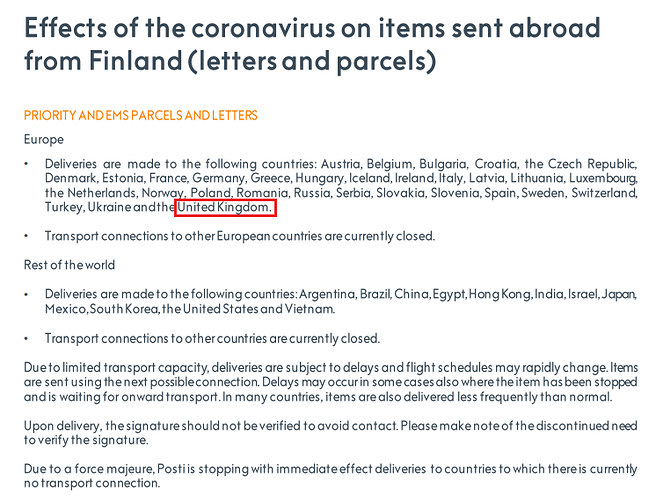

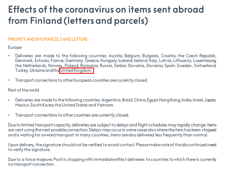

Does the UK count as the EU for this purpose?
Finland’s postal office considers that it does.
https://www.posti.fi/mzj3zpe8qb7p/7jFGsxRG0Hm2BbcXs9Emhf/3c029cc6f79f20811cd434645b6aebf8/effects-of-the-coronavirus-on-items-sent-abroad-from-finland.pdf

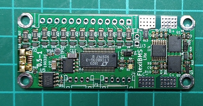

Could you provide the dimensions for the board? I would like to design a case for it, assuming I was quick enough to get on the list :slight_smile:
Outer dimensions 62,5 x 26,5 mm. Mounting hole pattern 57 x 21 mm, hole size 3,2 mm. Horizontal connectors can go outside boards outline.
Thank you! Would it be possible for you to take a picture of one of those from directly over the top?
Reverse Engineer?
I thought that would be the best way for me to get the connector positions with the least amount of effort for Simos :slight_smile:
Fantastic, thank you!
