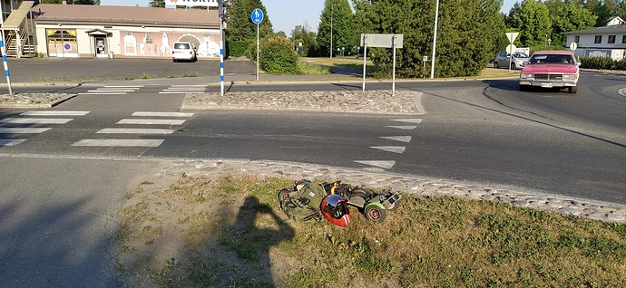

Got hit by a car on a crosswalk yesterday (24.6). Had a little air time, but survived with little physical injuries (couple bruises and swelling) and there was no need for ambulance. Was wearing my normal gear: knee pads, elbow pads, TSG pass and a backpack. Something got mechanically damaged on my board and I’m in the process of figuring out what exactly (slowly rolled to home on it after the situation had cleared). I think it’s a slightly bent wheel axle on one side of my Trampa trucks. Also 2 out of 4 3D-printed mudguards broke, but those are easily re-printed.
I have an eyewitness, driver was pretty spooked and apologetic and confessed that he hadn’t paid enough attention and hadn’t seen me coming.
I’m in the aftermath process now and have scheduled a doctor’s appointment and need to take care of some insurance stuff + file a report to the police.

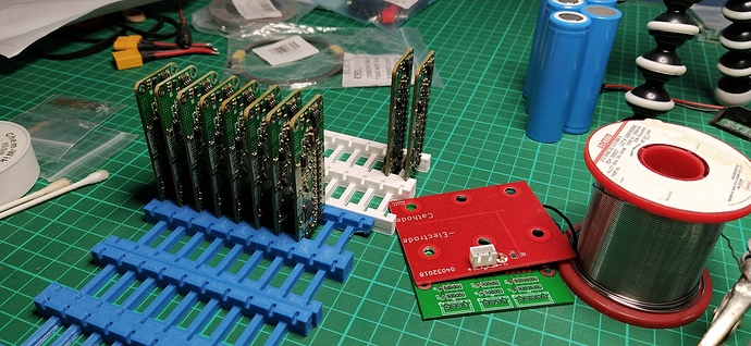

Update.

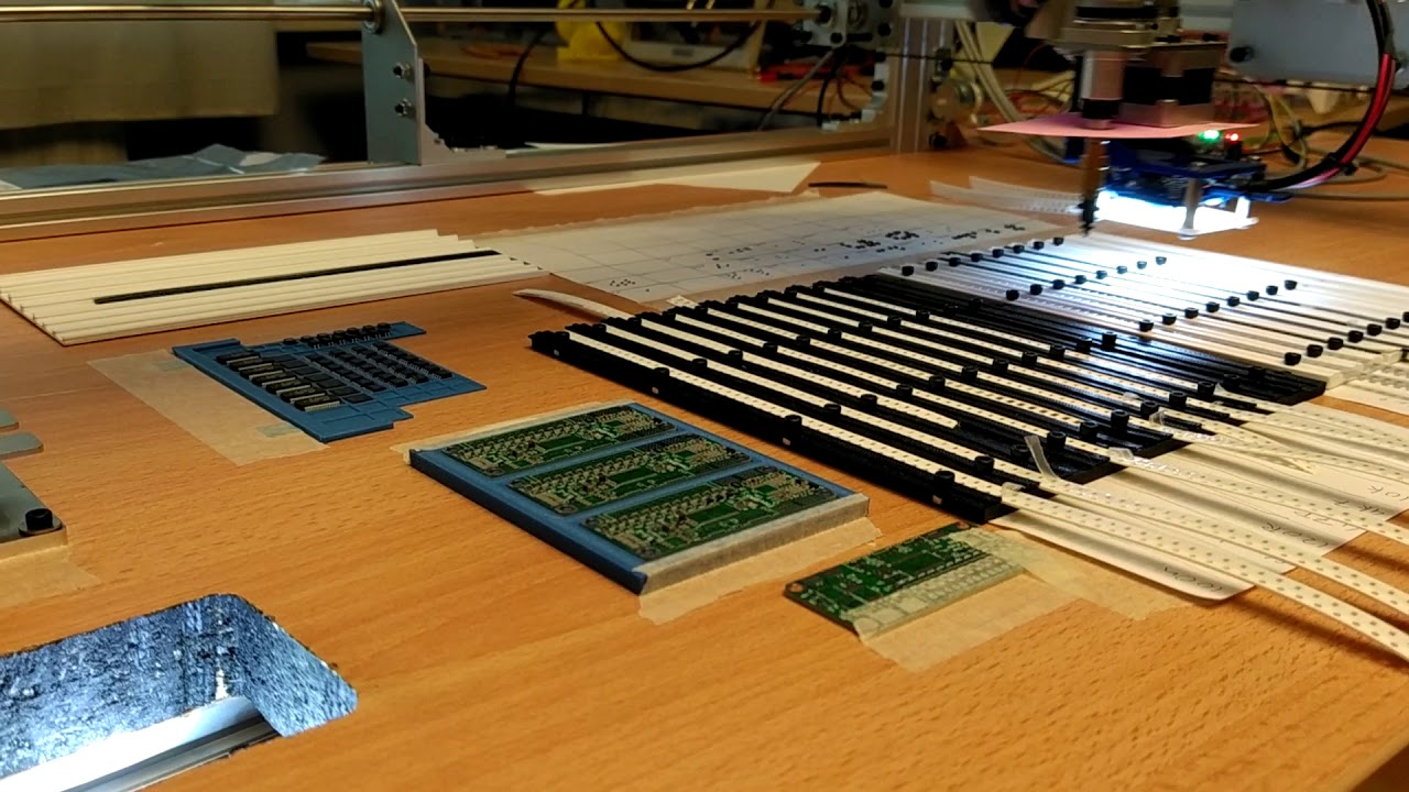

I assembled all the boards that I had components for last weekend and spent some time optimizing the axis speeds for faster assembly while staying reliable. If I want more axis speed I need to upgrade the stepper motors to beefier or faster ones.
I’m still using vision for all components and I got to around 8 seconds/component at the best conditions. After taking everything else into account (solder paste application, reflow oven and component tape manual advancing) the placement speed was roughly 16 seconds/component. Each board has 149 component that are placed with the machine (top + bottom side total), so about 40 minutes per board. I was assembling 3 boards in a batch in 2 hours. I’m okay with the axis speeds for now, but I’m already looking into making automatic feeders for most of the component tapes, as I have to spend a lot of time currently faffing about advancing the tapes on the holders manually every now and then. I’m also planning on switching to panel assembly instead of individual boards to increase output and efficiency. Most likely a 4 or 6 board panel.

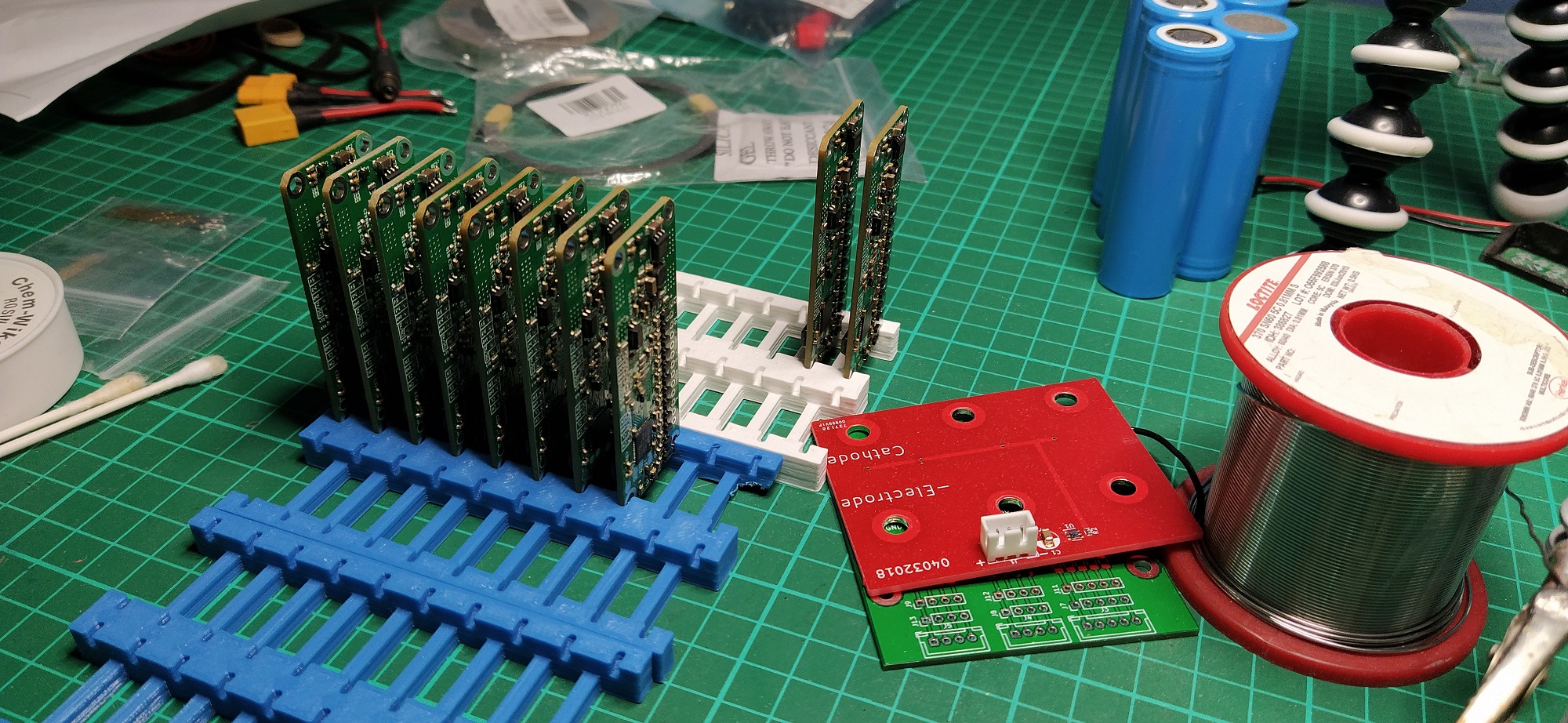

I currently have 11 boards assembled (9 were assembled last weekend and need to be QC tested). I’ll be selling these soon at a lower 60€ + shipping price, which includes possible connectors.

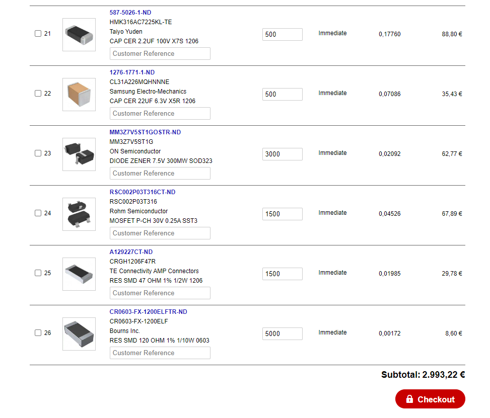

I’ll be placing my big component order for 100 board @ digi-key later today. I think I feel my new business debit card sweating in my wallet at the moment…
I’m gonna assemble the 100 boards with the current setup and then probably gain enough annoyance and frustration to get enough motivation to spend time optimizing my machine setup for profit and speed… and laziness.
