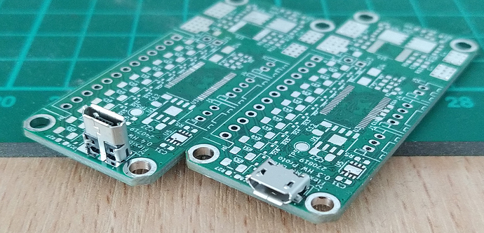

Closing up this post I’ll do a poll on which orientation of the micro USB-connector are you planning on getting. If the poll is clearly showing preference one or the other, then I may do some optimization of the PCB assembly order and get them to pick&place the more popular connector on most of the boards and get the rest without the USB connector soldered, so I can then based on demand hand solder the wanted one on them.
  • Horizontal orientation
  • Vertical orientation
0 voters
I appreciate the updates! Out of curiosity, is there a chance to see USB -C on these boards?
Why you all voting horizontal? Doesn’t it make more sense to plug in from the top while bms is installed in the board?
I voted horizontal because it would be much easier to protect from damage.
well my way of seeing this is that most board enclosures are longer more than higher so horizontal is better. I guess it all depends on your enclosure. Just depends how high your enclosure is and not everyone has a double stack.
