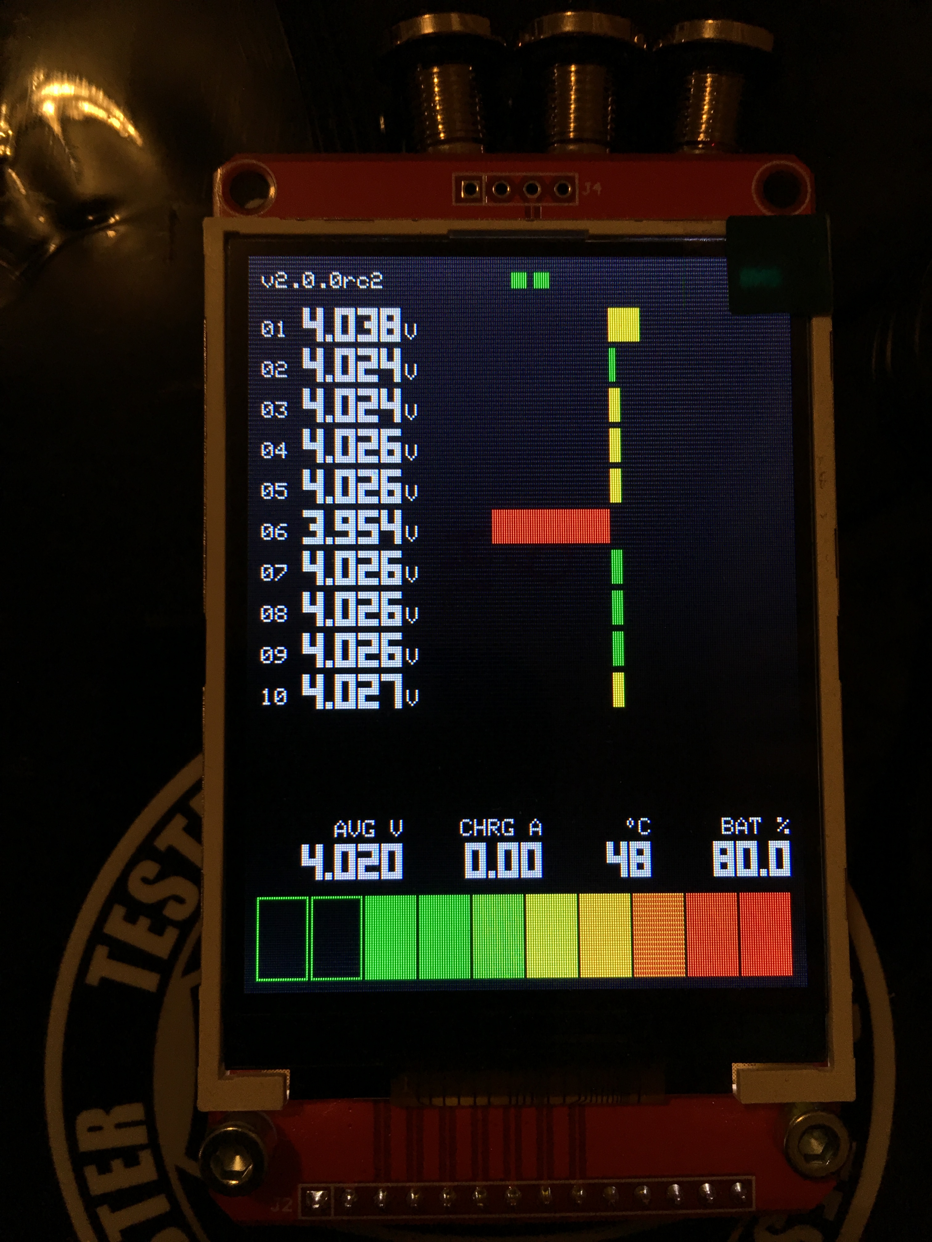

So I went ahead and tested it. It can surely do it. It just takes a lot of time. This was on a 15 Ah battery. Obviously, the higher the battery capacity, the longer it takes to bleed the parallel groups.
Yellow bars indicate which parallel groups are being discharged. Current setting is that at most 5 bleeding resistors can be used at the same time so that the BMS doesn’t overheat. The temperature was below 60 Celsius all the time. No heatsink or any kind of active cooling was used (except for me putting my finger on the BMS MCU a few times to cool it down so that I can sanity check the temperature readings :smile:).
This was my starting point:

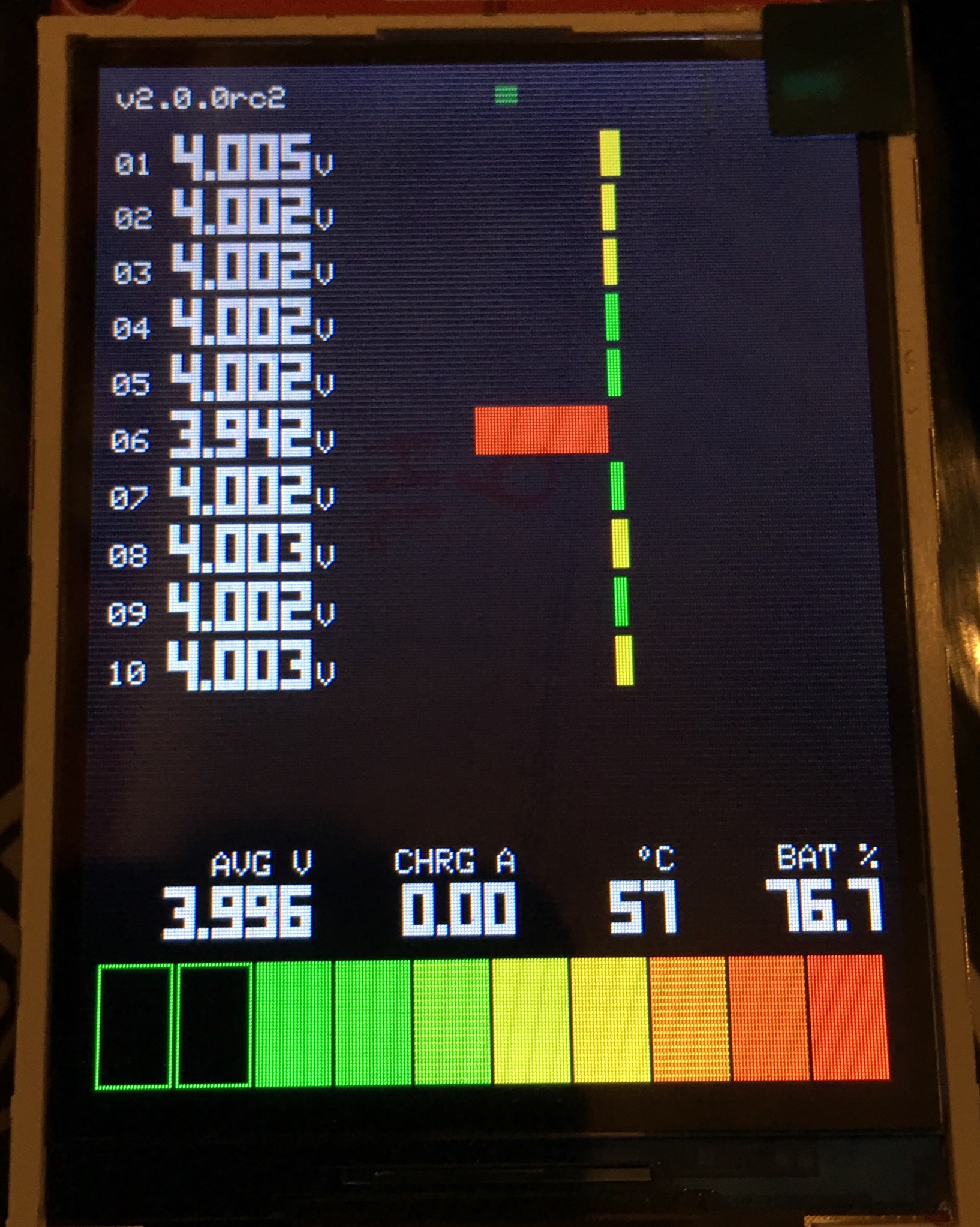

After 3 hours:

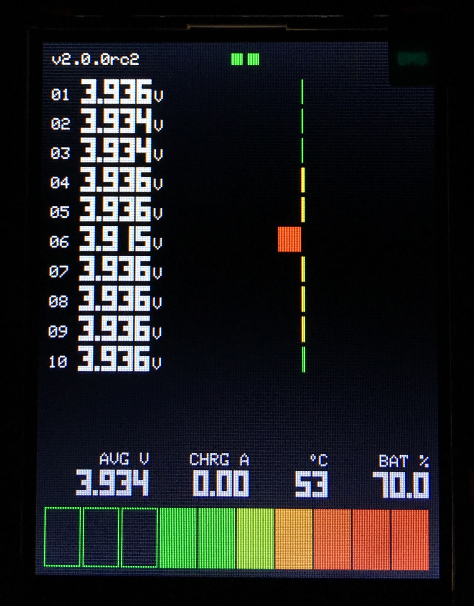

After 5 hours:

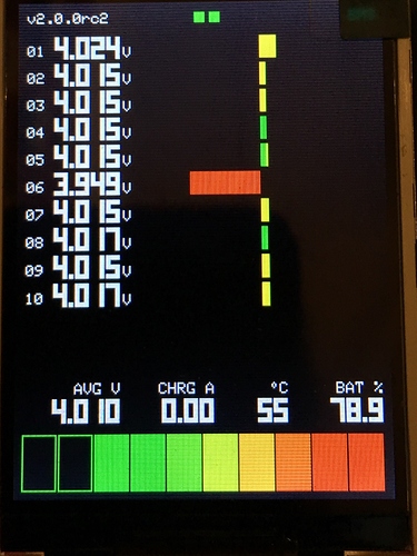

After 7 hours:
After 14 hours:
Note that I had the DAVEGA and Unity powered from the battery pack all the time for monitoring, which is the reason that all the cells were loosing charge. This wouldn’t happen otherwise (or at least not to this extent).
