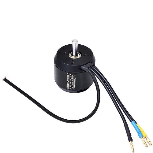

That said, i find it slightly concerning that the user guide/documentation for that motor is documentation for a sports bag.
It may also be of concern to you that the motor seems to have a 5 pin sensor plug rather than 6, indicating that it does not have a temperature sensor in the motor.

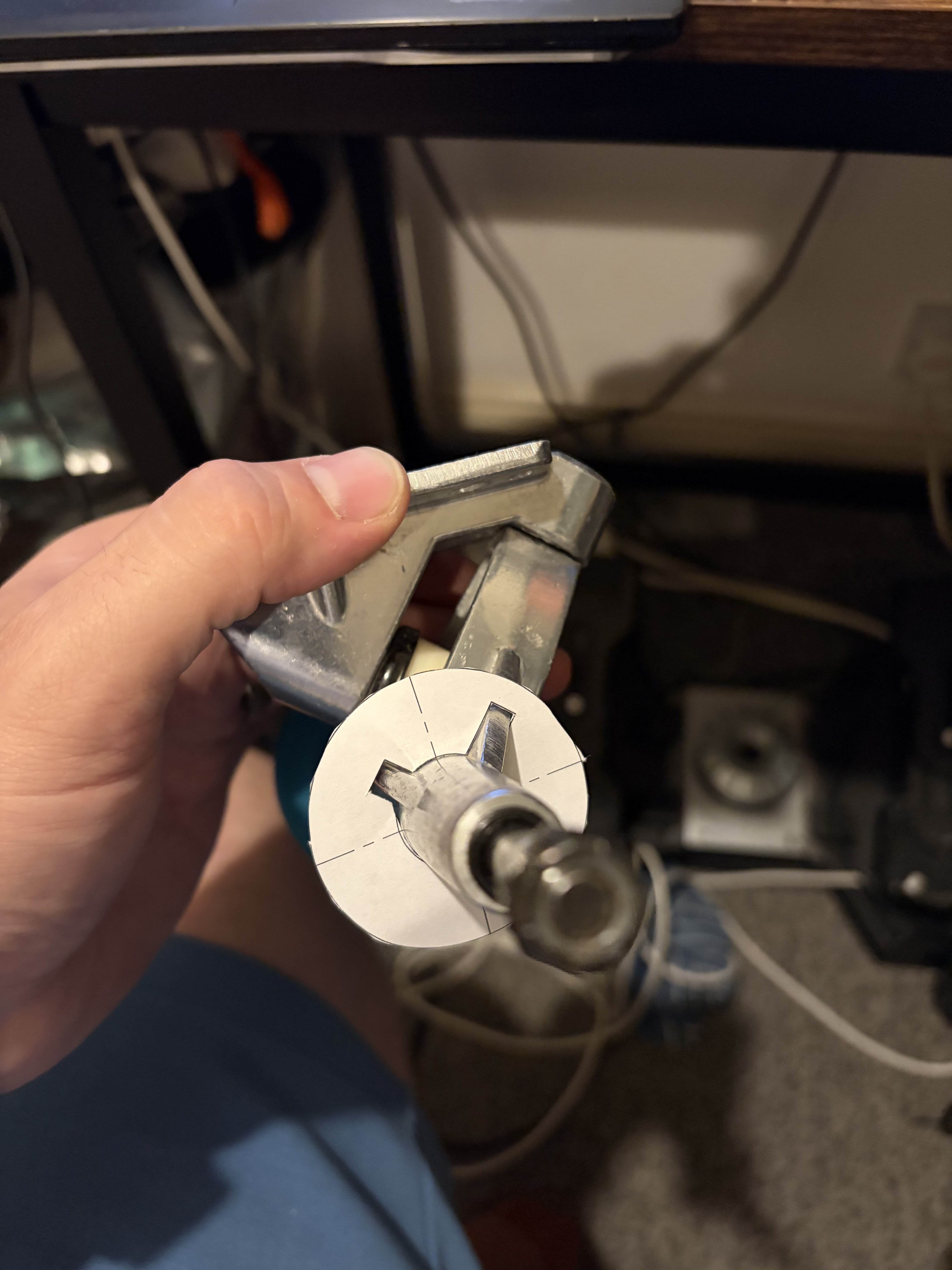

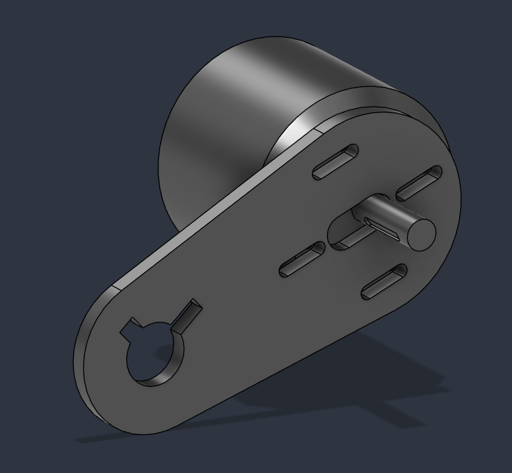

Yeah I’ll be trying to sort out the pulley mounting myself.
Off the top of my head I’ll be drilling a few holes through the wheel and bolting the pulley to the wheel, but I’ll cross that bridge eventually!

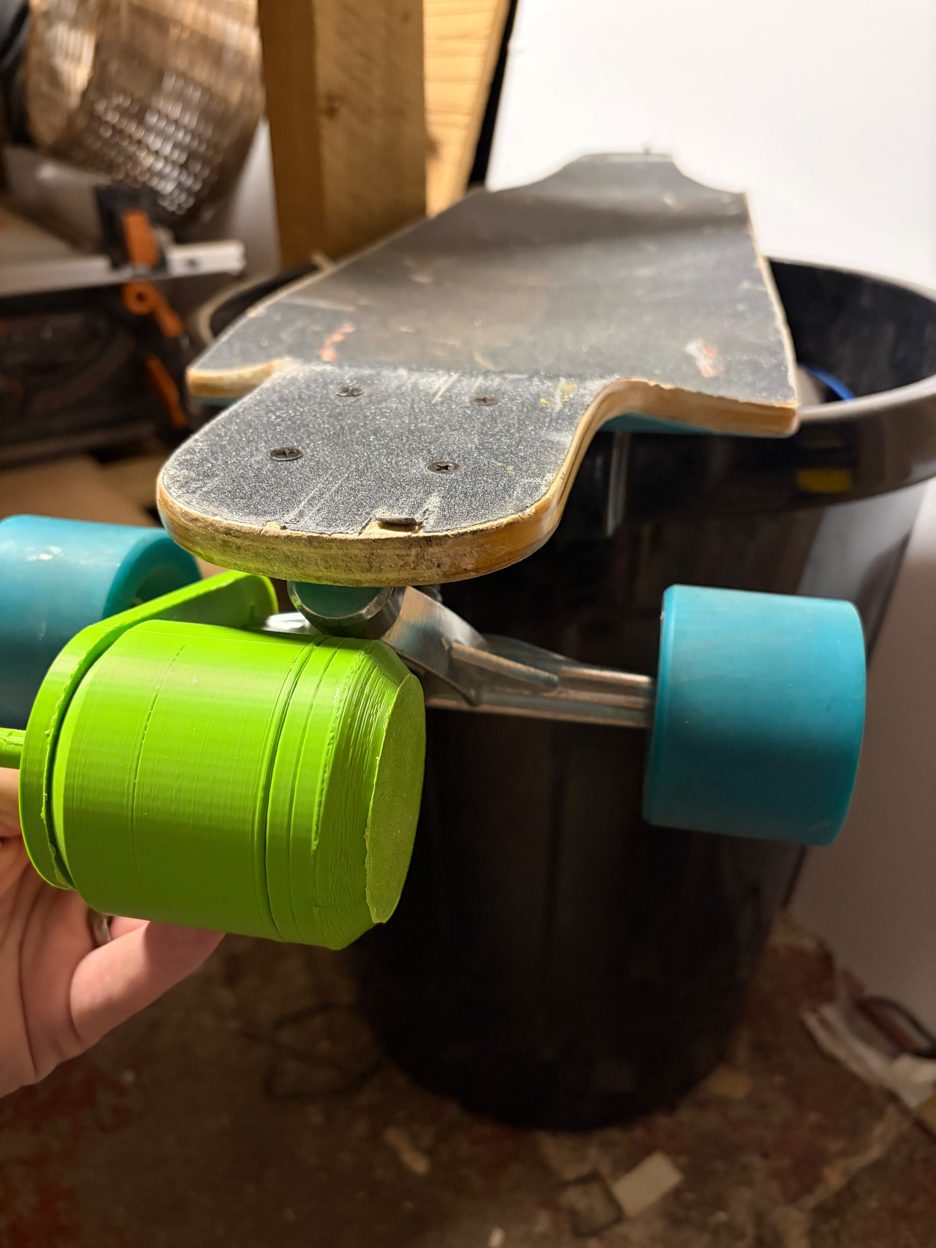

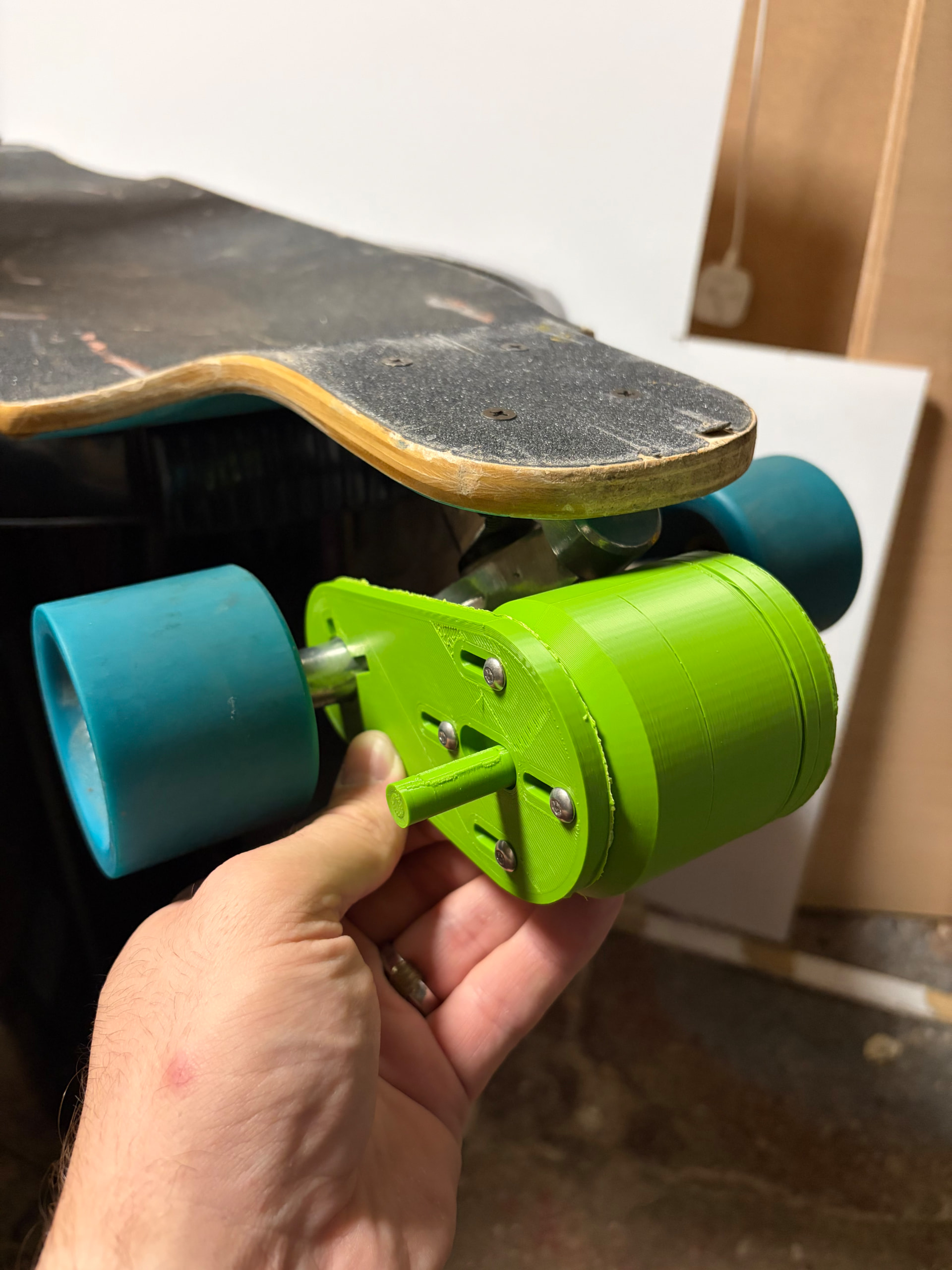

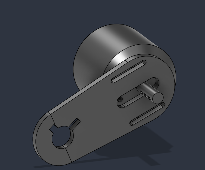

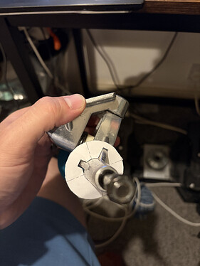

This is roughly how the motor will sit! I will work out the exact angle and position in the new few days!
I’ll also need to work out my exact mounting position and possibly get larger wheels as the motor is the same size as my wheels! not sure how I missed that one…
I feel like the weight of the motor, with the leverage of the mount will have a pretty good chance of shearing off the cast ‘fin’ support that the mount locates on.
I hope it works out for you but there’s pretty good reason we don’t see very many cast truck options in esk8 these days
I love the idea of this build tho, proper OG style
Looks like you may want to make the mount a hair longer since it looks like you’re at the very end of your adjustment slots and the motor is pretty close to your baseplate
