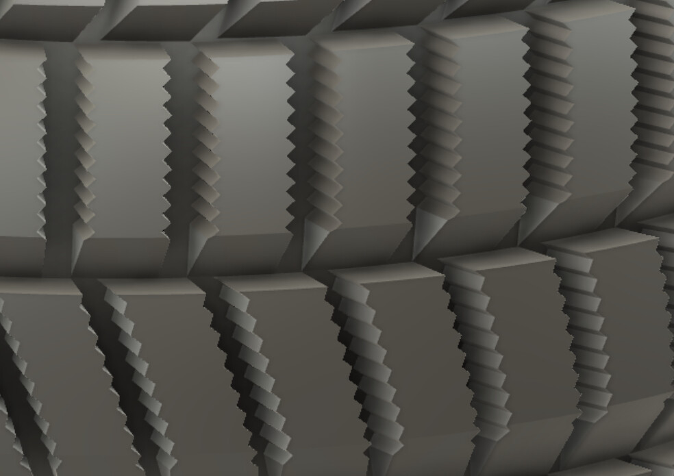

How Does 3D printed TPU Tires get grip?
The TPU Wheels features 230 individual treads that are 4mm tall and “flex” into the ground as you ride, the zigzag patterns on the treads “bite” into the ground giving you snow-tire like grip. As the wheel compresses, the treads bite into each other almost like shark teeth. This is part of what gives these wheels better grip than urethane wheels especially for off-road conditions like dirt, grass, and snow. We’ve experimented with various different heights of treads and found 4mm to be perfect and these would take thousands of miles to wear out in normal conditions(without burnouts).

Yes, that’s actually a feature I discovered by accident and softens the TPU as you ride lets say like 10 minutes. It doesn’t get hot though just warm and makes the TPU very grippy. I think you guys will have to try the wheels first, they are very grippy thanks to flexible treads that also have zigzag claws. Otherwise you wouldn’t be able to go over long grass nor dirt/light sand/snow which it can. Oops, maybe I should post some close-up screenshots of the treads.
