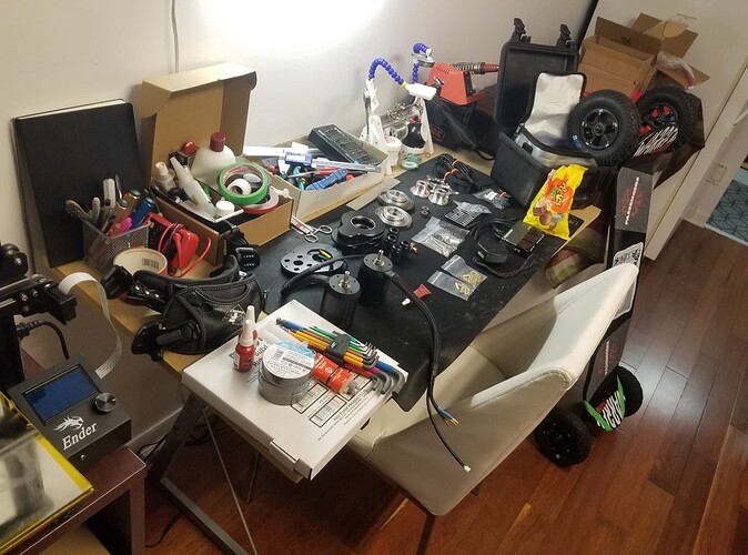

So it begins…
Gorgeous heat sink @Savage1, thanks again! Huge shootout to @Paul77 for the care package (and the sweets :chocolate_bar:)
Anytime brother, just glad I could help ya out! Keep us updated on the build.
