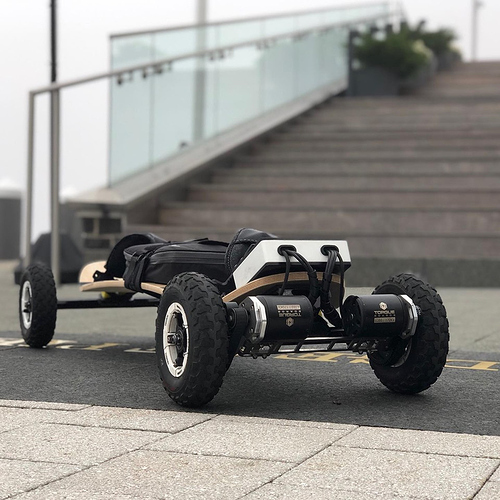

This is the first impression post for 3sk8esk8 remote + Colab Deck
I’ve been really happy with my MBS build (Link here: https://www.electric-skateboard.builders/t/mbs-dwii-first-impression/90940)
Recently the trusty nano v2 had failed. It was loosing calibration randomly mid ride which set me down the path of looking for a more reliable remote.
At the same time @topcloud who seems to know what all the expensive nice toys are pointed me to the Colab deck which is considered to be one of best analog mtb board deck out there.
And so… its time for an upgrade

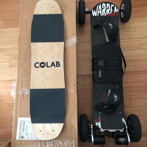

Colab
Colab is consider one of the best decks for mountainboard. I have swapped from trampa to MBS not long ago and the decks really makes a huge difference. When I heard there were going to be a few that was going to be floated to the public I jumped on it and snagged one.
Not surprisingly this is now my favorite deck.
The Good
- Very comfortable deck, its wide and almost flat where your foot goes with very little camber
- Very steerable. The deck is concaved making this a very steerable deck potentially ridable without bindings
- Flex. The flex is just right, no wobbles but enough to soak up vibration.
- Its got a nose! I love the DWII but one of the thing that annoyed me was the lack of long nose which ment the deck will hit the motor mounts when you are going full tilt. Colab have no clearance issue with mounts and lights!
The not so Good
- Expensive. Very expensive
- Rare. hard to find
- Not the prettiest looking deck. I might regrip it but to me its not the prettiest looking deck out there.
Comparing to others
- Price - DWII > HolyPro > Colab
- Comfort - Colab > DWII > HolyPro
- Steerability - Colab > DWII > HolyPro
- Aesthetics - HolyPro > Colab > DWII
Do I recommend?
For the best bang for the buck go with @MBS. They really have the best balance with price x performance. If you want the best out there and you like riding with bindings. Colab would be a strong choice. I have a Haero deck on order as well that I feel may be able to give colab the run for its money
Until then, Colab is king in my quiver.
