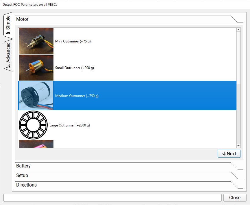

I also like to go into the ‘FOC’ tab. Sometimes I get better results manually detecting each parameter than I do with just running the wizard but I have no clue why that is. Maybe I just feel better seeing all of the boxes turn green.
I also like to make sure that the low battery cut off is set to something reasonable. The recent versions of VESC Tool that I have used have had pretty good default settings as long as you are careful to specify how many cells you have in series and your cell chemistry, but that was not always the case.
Finally the last step! Please help :rofl:
Run the wizard bruh, easy peasy
(choose medium)
That’s all I have ever changed in VESC tool.
