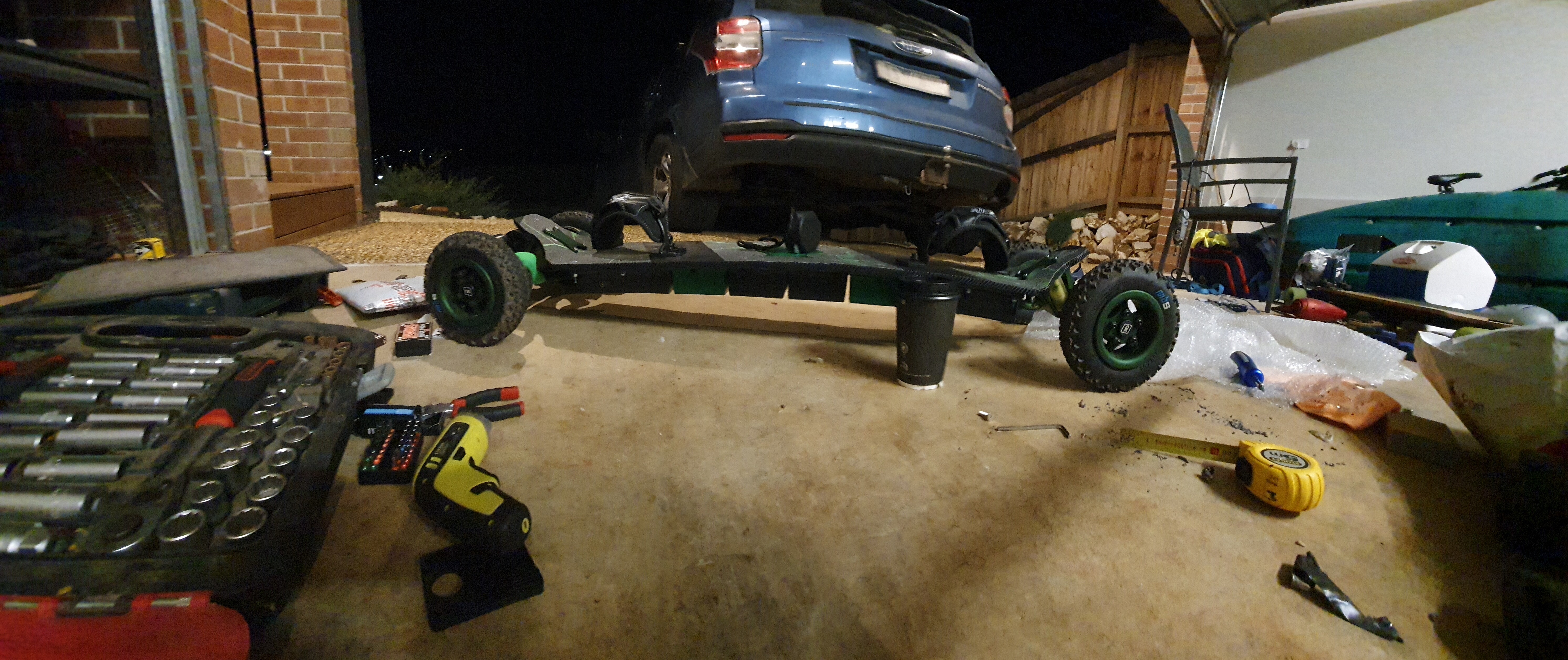

Cheers man. I didn’t change much from the original plan. There’s a stormcore 60d in now because there was a wait on the xenith. Motors are ANT innovations 63100 170kv. The deck inserts from eboards Peru came straight out so I’ve just bolted through from the top of the deck. Initially it was was way too low (pictured above) but I got around that by drilling new truck mounting holes further down the kicks on the deck. I’ve got it set to 85amps per motor, torque is crazy! Couldn’t get any 9" wheels so I’ve got 8" MBS tyres on. I’ve also moved the dampers on the trucks to the inner most setting so it’s plenty carvy enough. Pic below shows the new height with a large coffee cup for reference, 16oz for you Americans :wink:

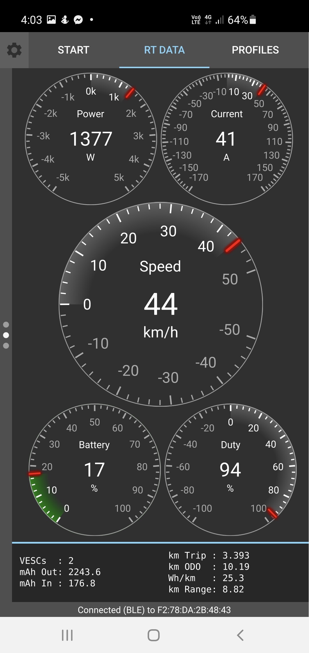

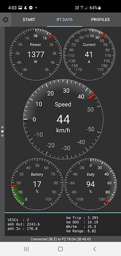

Hey guys loving this board, but I did expect more top end speed. What’s the limiting factor here, screenshot taken at full noise on flat. I’ve got plenty more amps and wattage to play with?
Your low battery voltage will sag that top speed quickly.
Was this happening on full charge as well?
Never mind, I figured it out, had it set on 1:5 instead of 1:4 :rofl:
