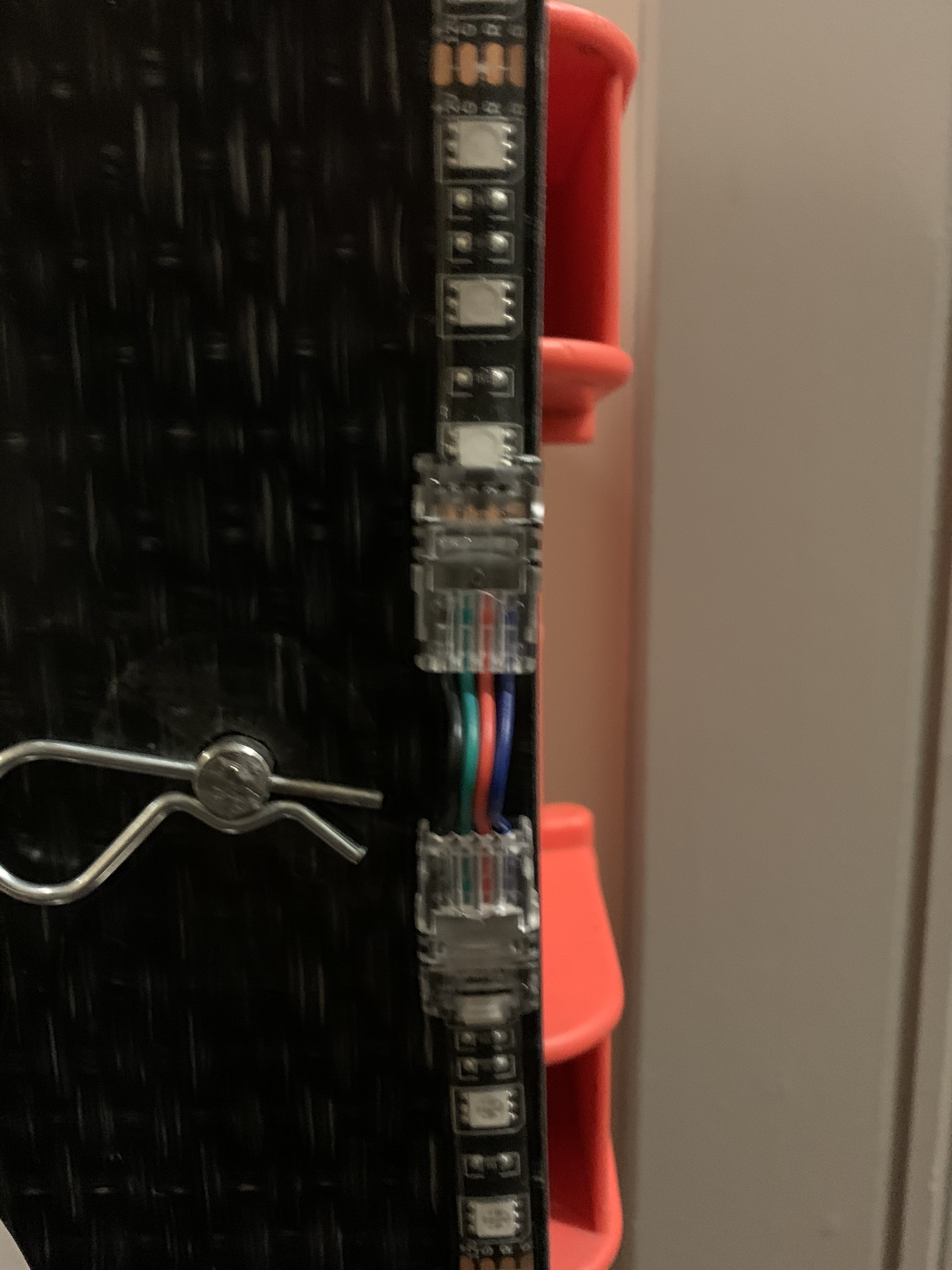

Final update.
I finally have the LED strips wired. Battery>Switch>Buck converter>LED controller>strips.

The LED strips are Bluetooth operated, so I can turn them off from there if I wanted to. However I wanted to isolate the strips from the battery completely when not in use to be safe.

I’ve updated the Electronics connections and lighting system in this. More organized, everything is now more “plug and play” if you will to allow me to work on things or replace when needed.
Anyway mostly what I want to update was lighting. Previous lights worked okay but they were weak and also using one stop across the board meant that there was going to be kinkage, eventually it stopped working all together unless I pressed firmly on the connections.
What I’ve done now is added more slack, made the strips removable with a watertight wire and also added a stress relief in the center of the strip. Also with this strip and also new controller I couldn’t do all in series, so I split off one cable into two to connect both series. Also I updated my headlights to Olights using @Kaly’s picatinny truck adapters.
