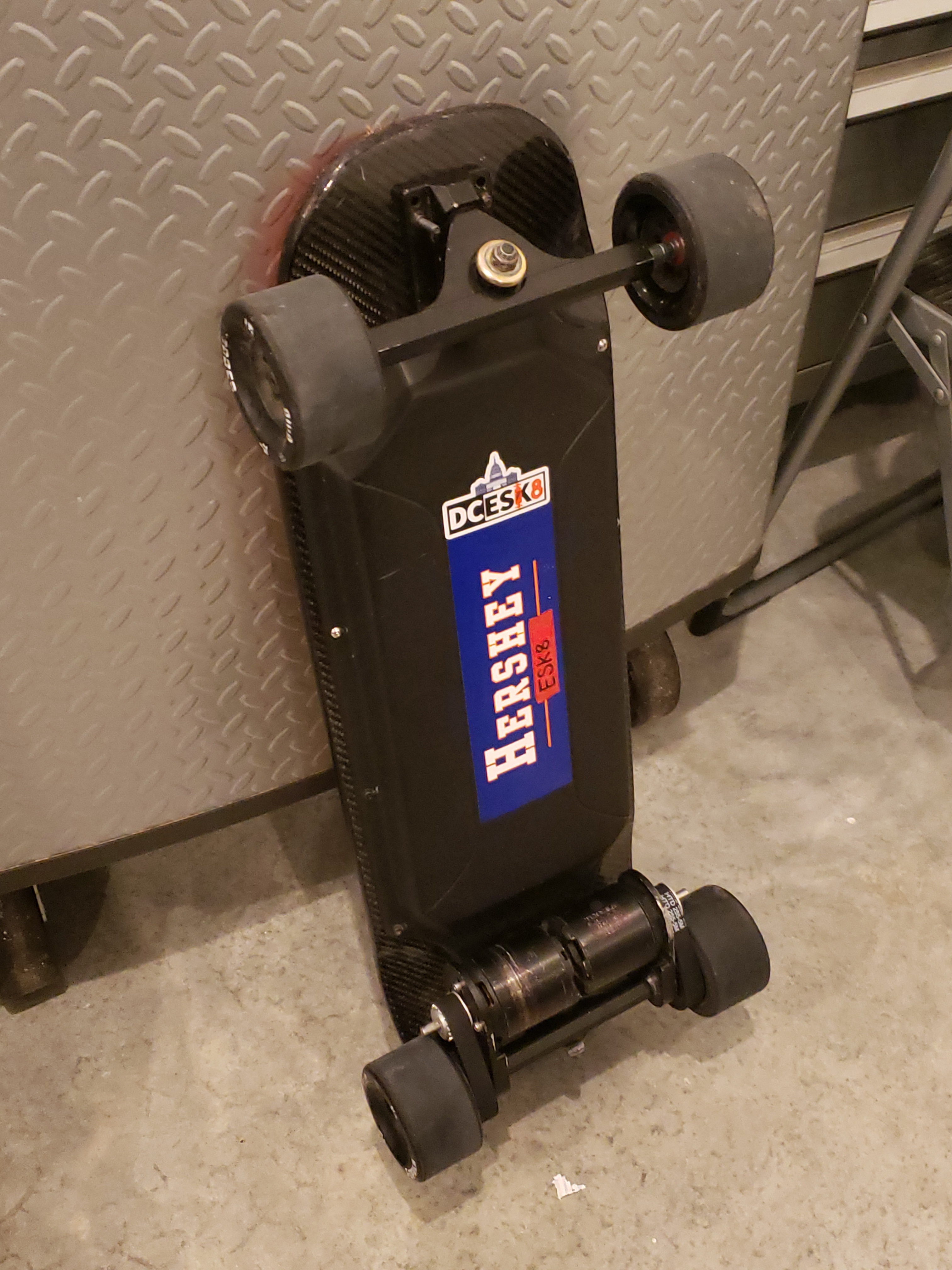

and when you say it’s close to allowing 10s3p, i guess that wouldn’t be for an NESE module 10s3p?
18650’s perhaps?
ideally i’d like 12s2p 27100 as a minimum spec, but im learning that enclosures can be the death of a build, so whatever your making man i’m sure i’ll be stoked with it. the bigger the better though, at least for me…just searched the forum and it seems there are a few wolfshark builds in the making. i had no idea
12s4p Molicel p42a. 12s4p 18650 is going to be significantly smaller, or go with a welded pack. Honestly after all the money I spent on the nese tabs, filament, parts for my printer, a new printer when i got tired of failing with the old one, etc, etc, etc, it is not something I think I will do again. Im looking at the kweld if I build a pack again, or just shipping my cells to a reputable builder and having them make it right. It will probably work out to be around the same cost, if not much cheaper when you made as many mistakes as i did :joy:

yeah was going to go for the p42a for sure, but by the sounds of it I should adjust my expectations as to the size of the battery since the enclosure sounds like it will fit half 12s4p, if im lucky. looking forward to see how it turns out though.
NESE-wise, i don’t have a printer, and would be buying everything from the @Agniusm store - which im pleased about since printing for days doesn’t sound fun. i guess i’d read a few posts and batteries can just fail spontanseouly, or individual cells may have issues etc. also travel stuff - it’s potentially modular so can travel with it (don’t quote me on that tho lol). NESE system overall seemed safer and easier to deal with if there’s just one bogey cell that can be located and replaced. only downside of course is the extra bulk. the enclosure i think will determine whether i go built or NESE bat.

With BN 184 hanger you can fit dual 6374
Here is an example
