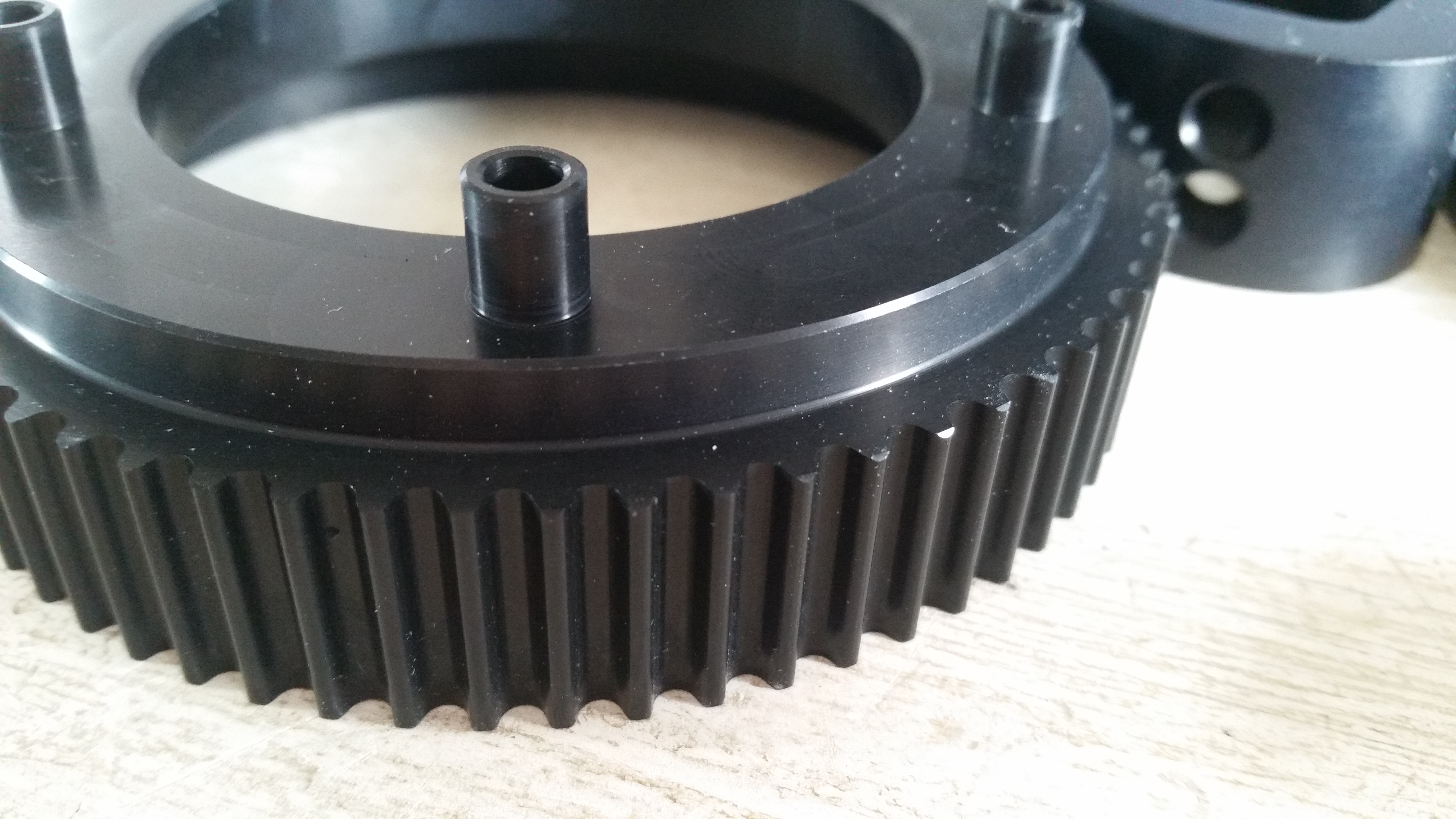

UPDATE:mounts and pulleys just arrived from @e.board_solutions,
They are thicc! and very well made! I have to say, customer service was great and the pre-order arrived even earlier than expected, which does not happen much in Esk8 world…
Those trucks make those motors look tiny in comparison. Crazy.
Mate you will see in reality those motors are huge, the normal 6374’s on the original Lacroix looked tiny, this at least looks like something is there hahah
