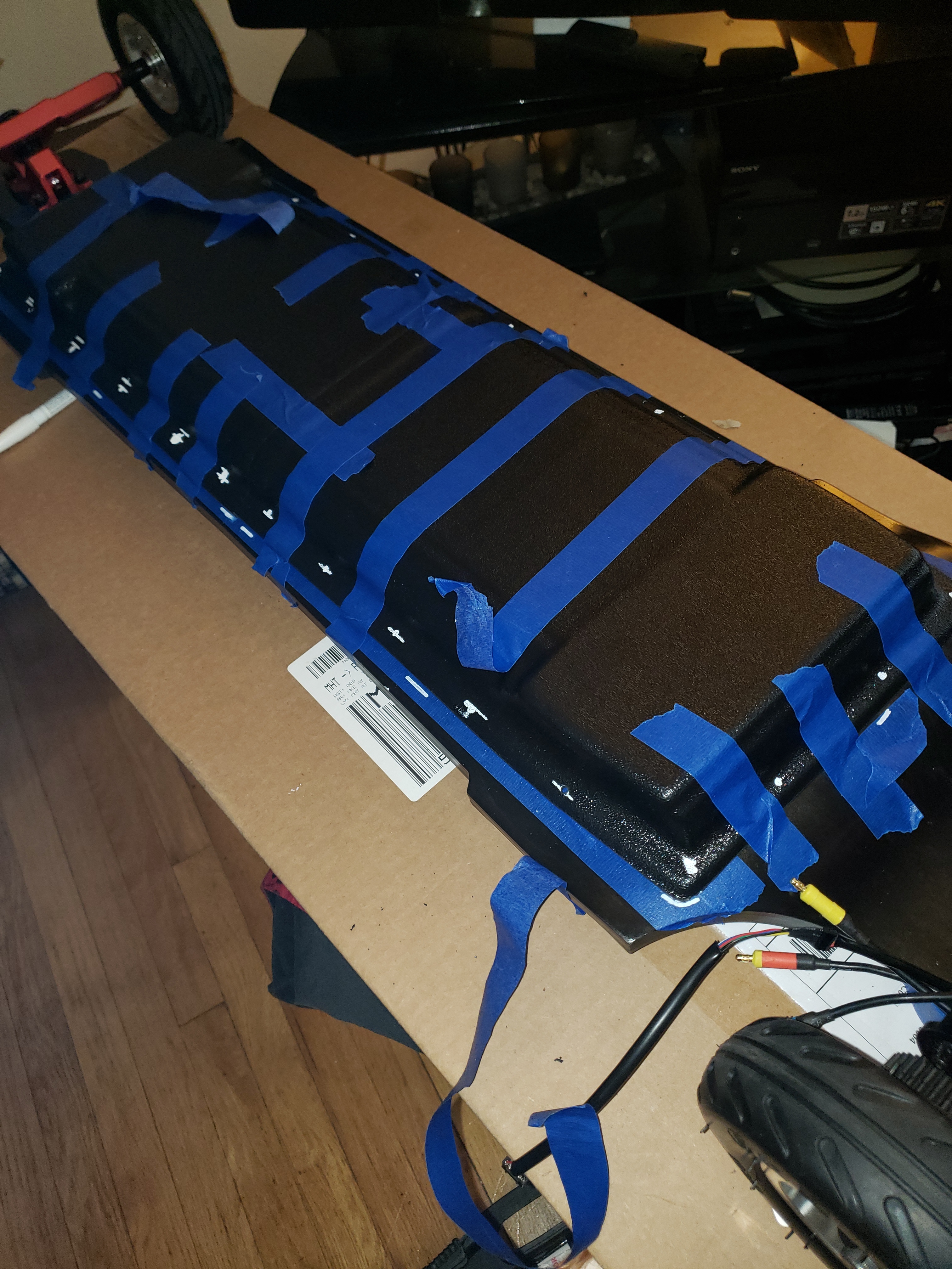

Finally got up enough courage to plug this battery in. The spark terrifies me. Lol. But the Unity has anti spark, right? I was able to do motor detection and quick setup last night. Tonight I plan to study what every setting is all about so more late night reading and videos. What I find interesting is the max battery and then theres a max motor setting. That is very interesting/confusing I’m super stoked to dig in tonight.

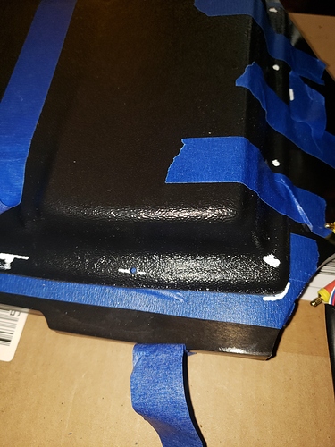

I’m having such a hard time with this enclosure. Nothing is wrong I just don’t know where and how many screws to put In. I’m mounting everything to the deck so it’s just a cover. Still I’ve read Psychotiller’s thread on mounting enclosures 100 times. I think I’m just afraid of drilling into this beautiful deck. My drill arrives tmr I gotta figure this out.
If I have the clearance I want to do this. Any suggestions…?

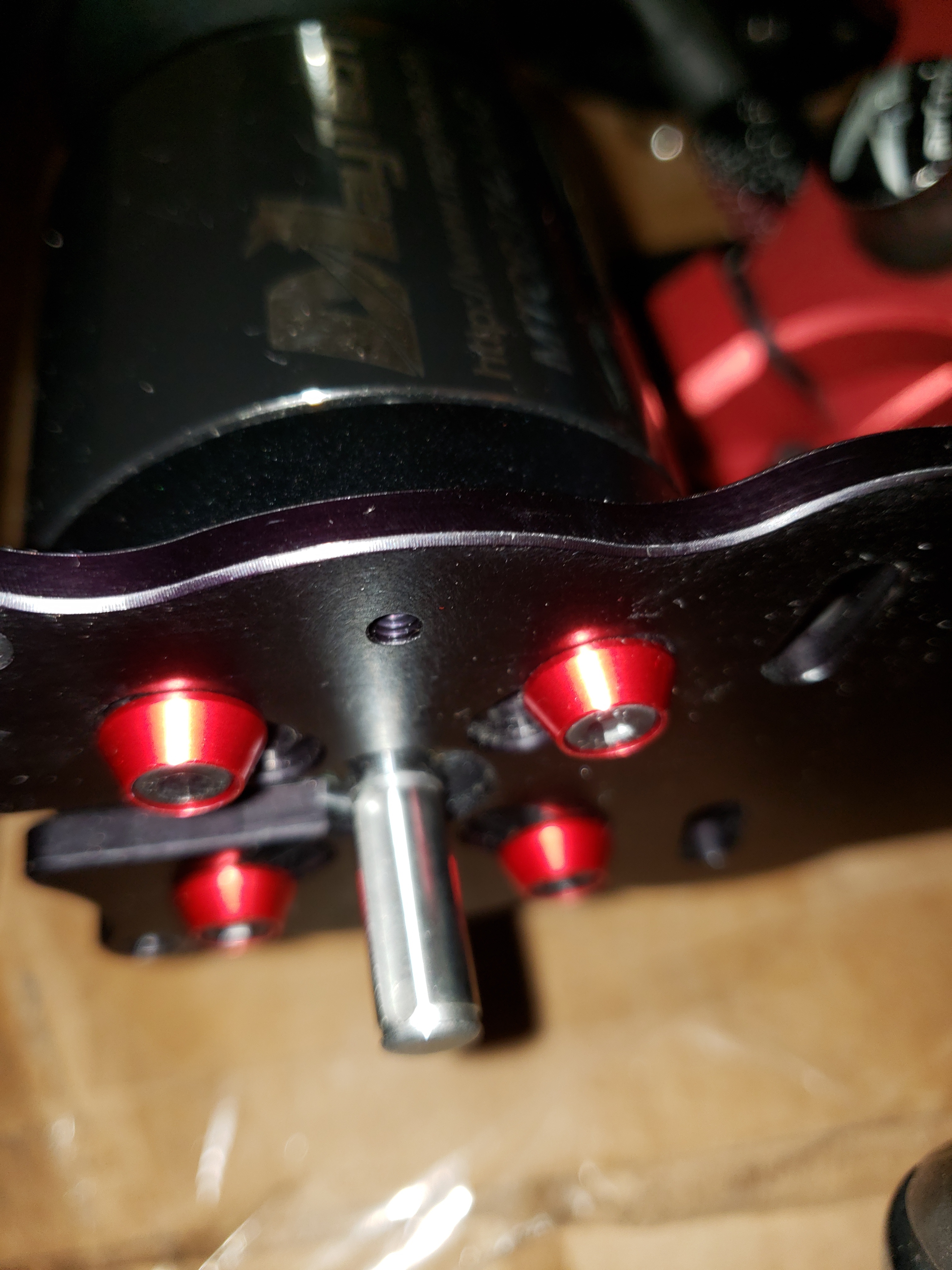

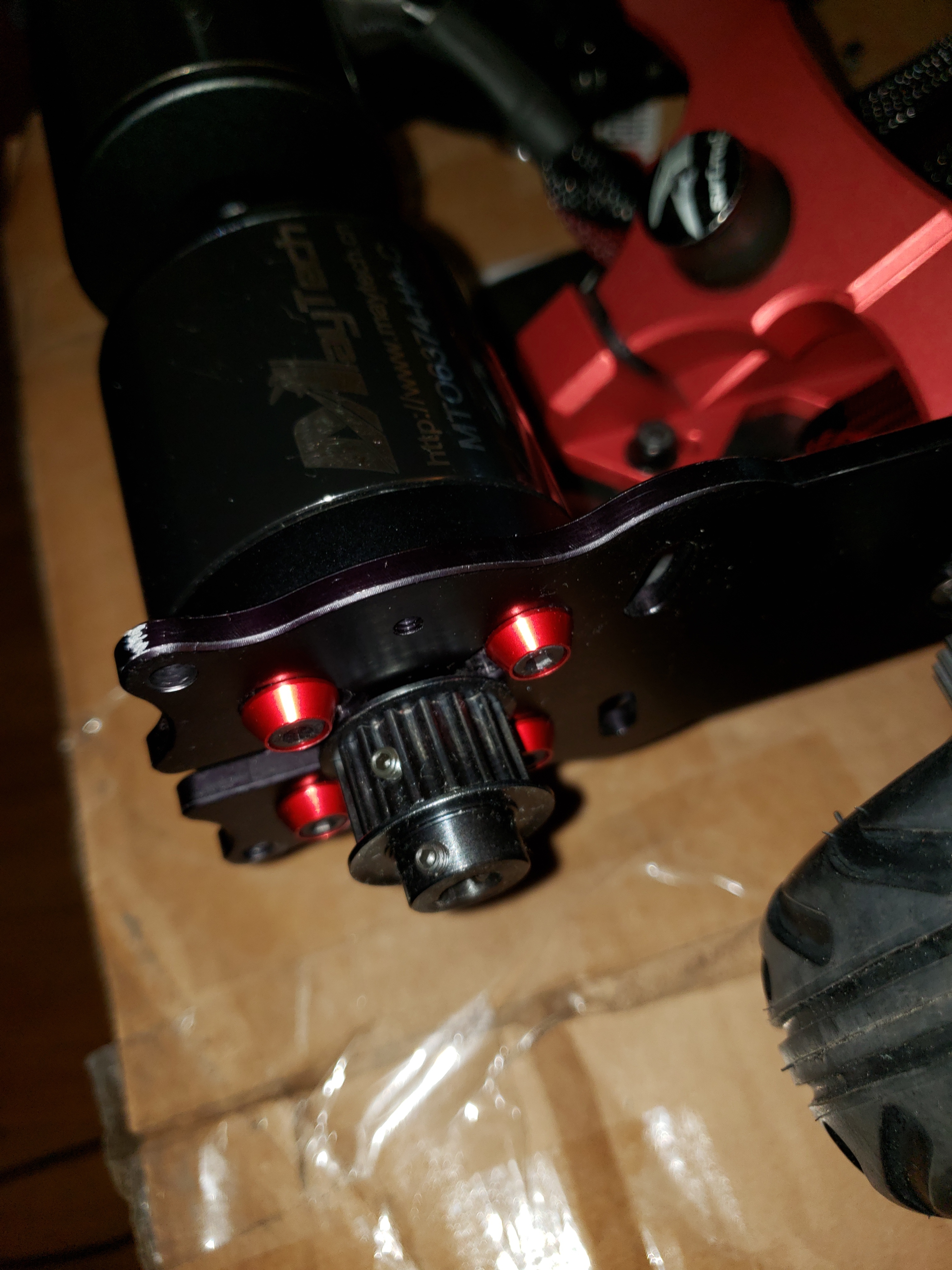

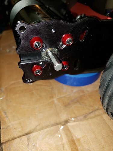

Buy a shoulder-less motor pulley from Jared and do whatever you like. Those ones are shit :+1:
thx much…how tight should I tighten the motor screws?
They are threaded into aluminum, so don’t make them too tight. Tight but don’t strip the aluminum threads. Use a small amount of Loctite 290 on the threads of each one to secure them so they don’t come loose. Remember to wait 24 hours while the loctite cures before you shred the gnar.
thx much… I have 243 loctite, the 290 is the red, correct?
