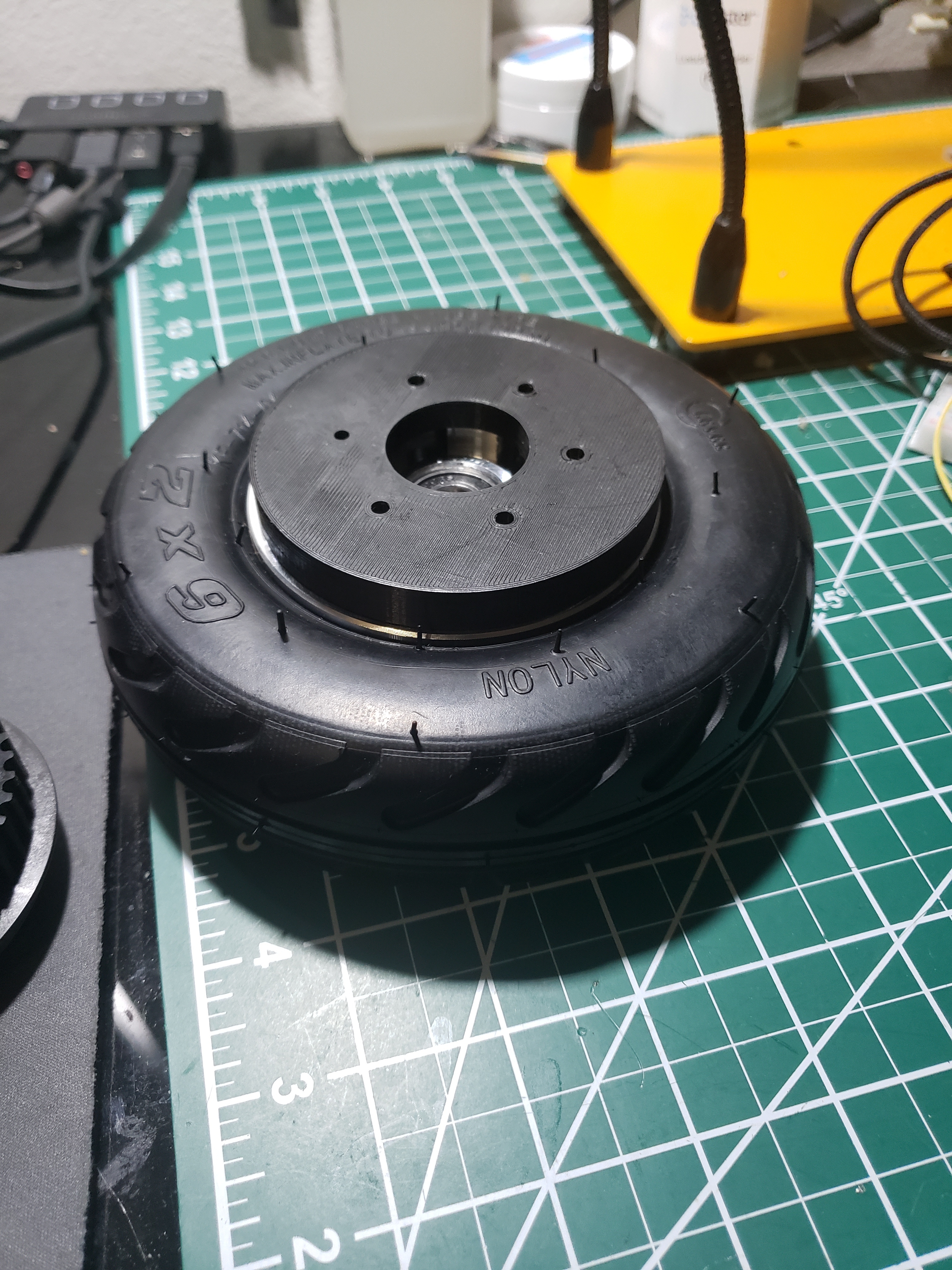

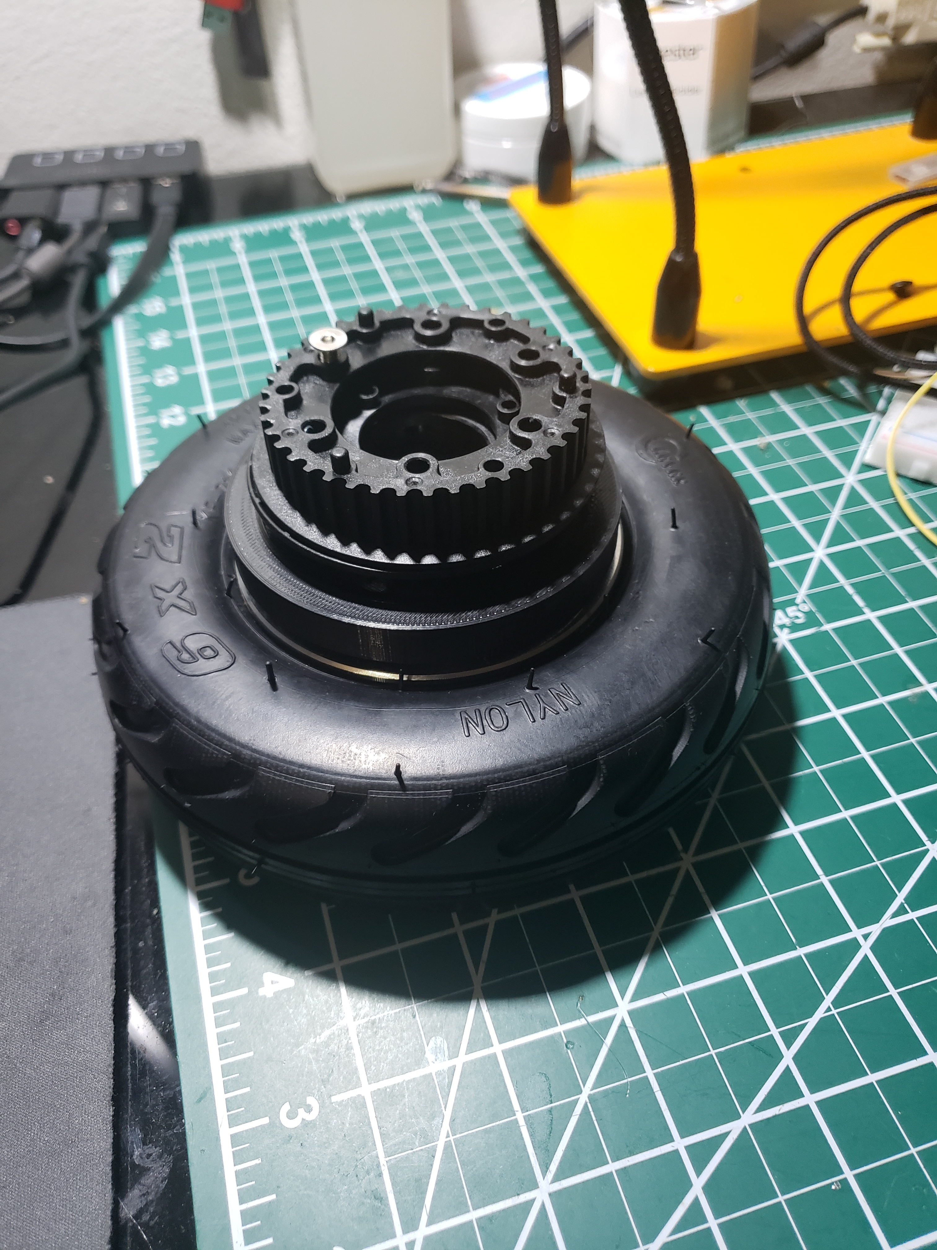

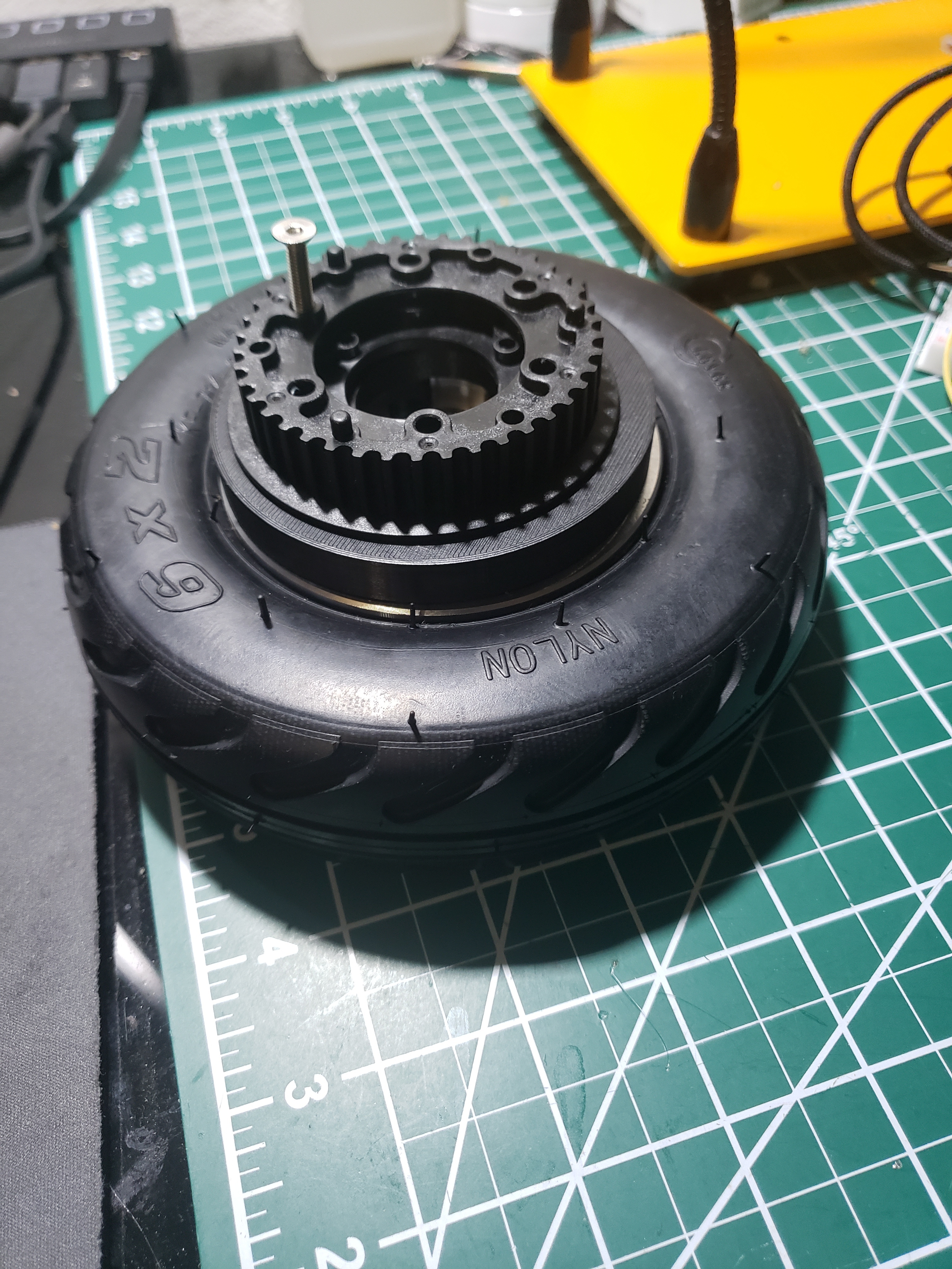

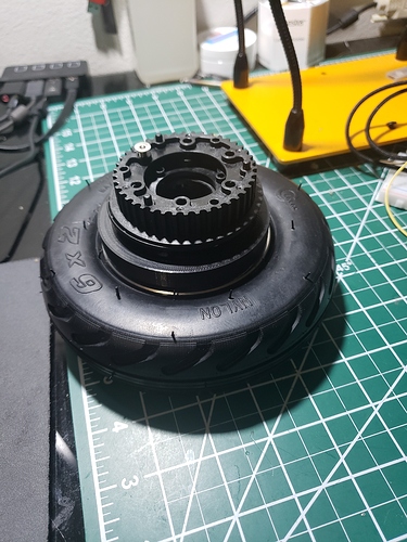

Ok I’m confused which one is correct. On both I have the spacer with the indented side facing the wheel as in the pic here. I think the last one is the way its suppose to be.

The last one seems to be correct, yet the spacer seems too thick.
Try this one to keep things a little more narrow
I appreciate it. That really is a great looking build. You will get a lot of life and outstanding performance.
I think that’s the one I have…I’ll check dimensions to be sure. Thx
You probably have this one
I remixed it to make it thinner.
yes that’s the one I have. I’ll grab the other one. I also thought it was a little thick.
Normally you would use a section of the pulley, reverse and placed in between the hub and the pulley. I have never used the model that you are showing, so I cannot speak about it. I have just published the model I use, I’ve used it multiple times and have never had an issue. I just thought it might be useful.

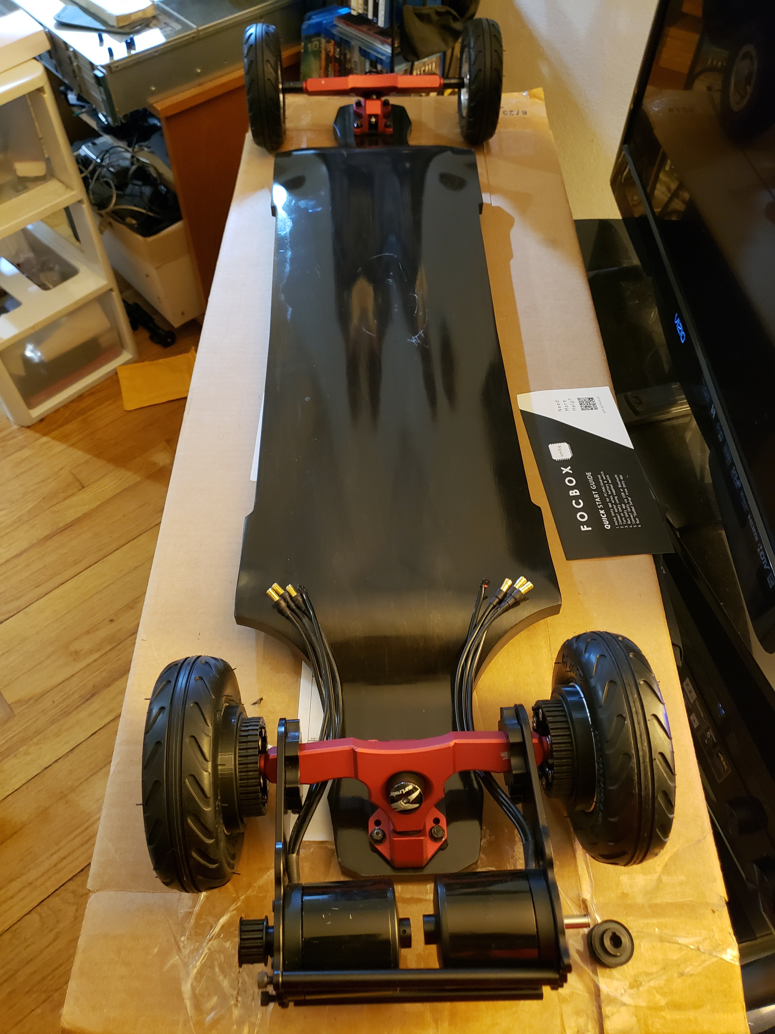

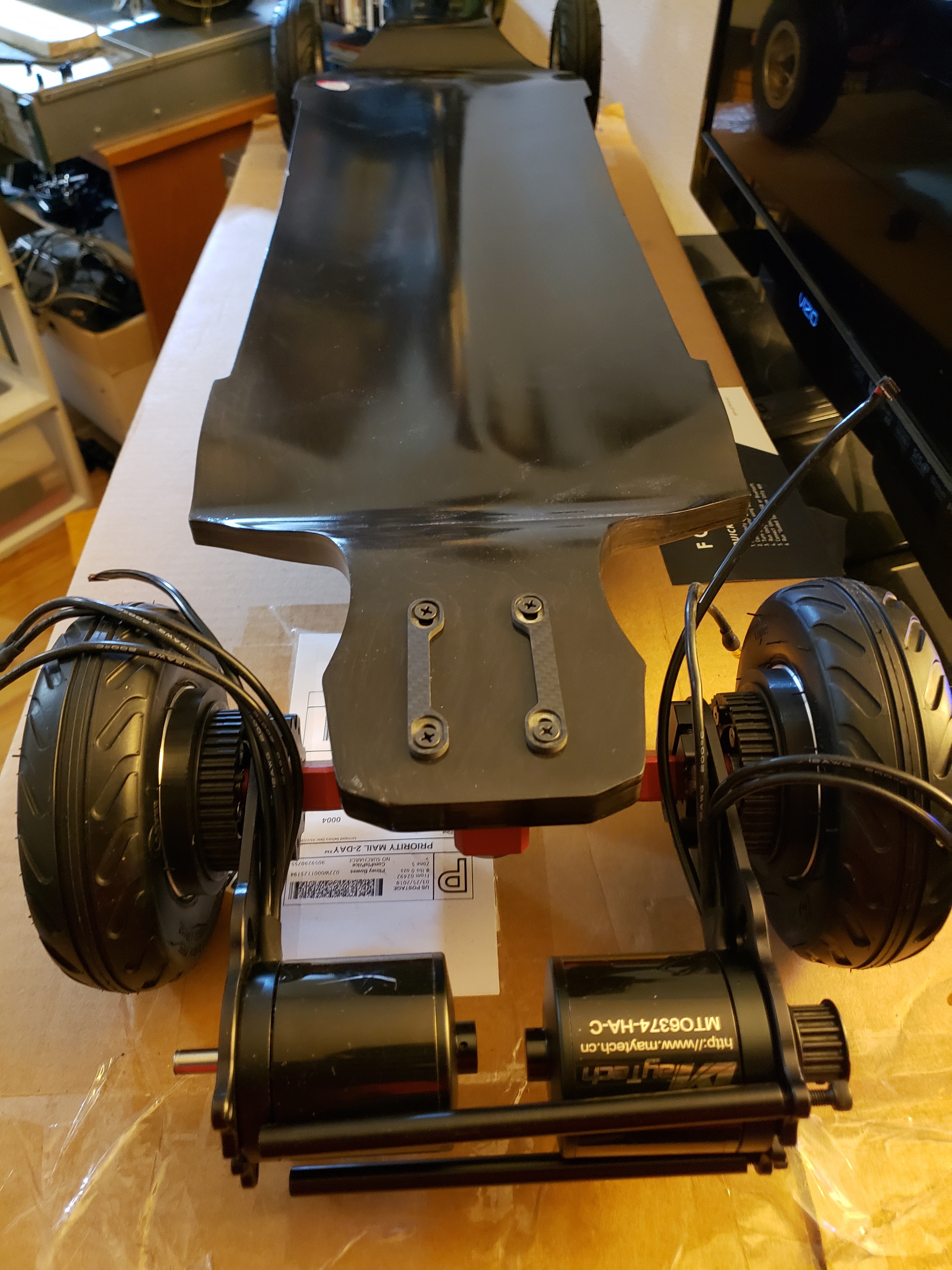

So I started assembly while I’m waiting on parts. I made a couple of mistakes. I over tightened one of the screws on the rear right hub (one of the pulley screws). I’ll feel better with longer hardware ( wait that didnt sound right) I’m trying to say I think I need longer screws for my trucks. The bolt clears by only about 2mm. I stood on it last night and immediately got butterflies. I’m super stoked

It looks amazing. I have to say though, that enclosure is a bit of a let down on this deck.
thx bruh…I was thinking the same thing last night. I saw an enclosure from a guy named Sender I think. It was bad ass. I got this one cause it was large enough to fit the 12s6p and other electronics and also it was from Psychotiller… :sunglasses:
think I’ll go with the 7mm…the 10mm is a little thick

As far as the 42t you can try it out to see how you like them but i would go with 60t you will have much better acceleration and braking and still have 30+mph top speed.
42t is closing in on 50mph and in my experience air tires dont feel confidence inspiring above 30 anyway.
